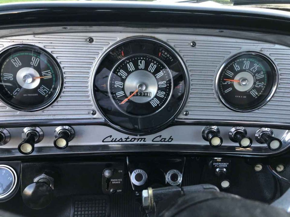

Since the odometer rolls around to zero again on these, it could be 20,000 or 120,000, or it could have been rolled back at some point as that's pretty easy to do on old speedo's.
How are the brakes? Tires? Does it have widowmaker wheels? Is it really a single speed axle? What is the model number on the tag and the GVWR?

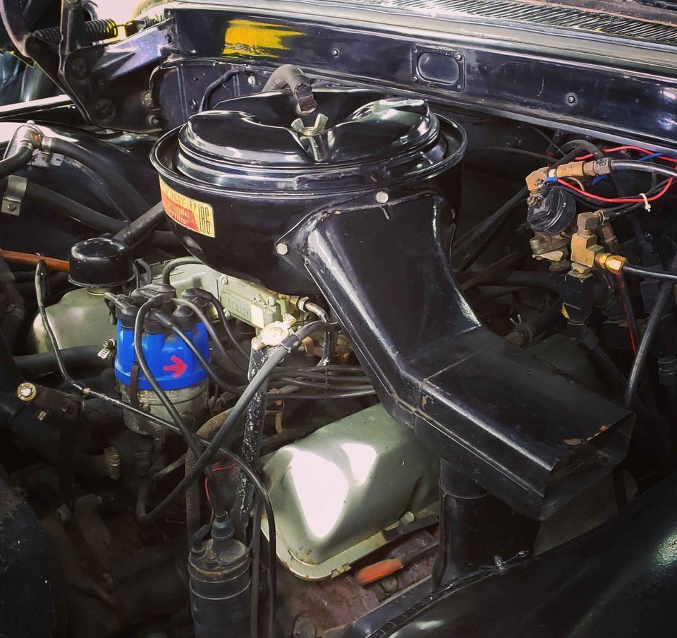

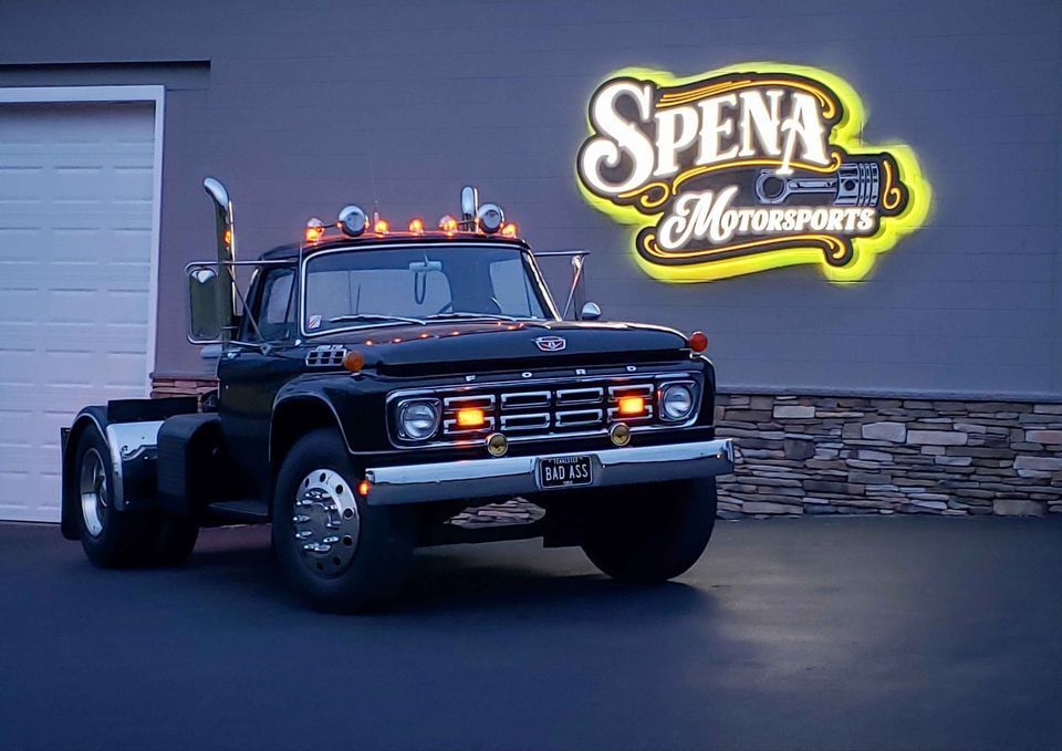

Owner says it's an F-750 (not 550; sorry!). Door tag says F-500 for model, 181 for body, 15,000 GVW, owner says it has 330ci HD motor, tag says 153hp at 3600 rpm, 5spd manual with 2 spd rear end, air brakes. D.S.O. says 610013. Here are a few photos. My guess is that it is a frame off restoration since the tag shows

This is a truck that has been put together from parts of other trucks.
The door must have been off an F500, and therefore the VIN on that tag DOES NOT APPLY to this truck. If he is trying to sell it with that VIN, he is probably committing fraud or is just plain uninformed or worse.
It appears to have an F750 hood.
That engine could be a 330, but 330s show 164 net HP @ 3800 RPM. The 292 shows 153 @ 3800, the 302 163 @ 3600. So maybe it has an old air cleaner on top of the 330--except I see 186 on the air cleaner.
There is a VIN stamped on the frame rail about even with the alternator on the passenger side of the truck.
Are you thinking of buying this thing?
Seems like I've seen these pictures here before.
The VIN on the frame needs to match the VIN on the title, period. The tag on the door MEANS NOTHING.

Looks to be this truck:
https://forddaily.net/threads/1964-f...8-fe-rwd.1520/
https://fordauthority.com/2021/07/cu...intage-hauler/

That truck may have a F-500 door tag but there’s nothing F-500 about it
F-750 is more believable with the air brake system and 10 lug bud wheels which were normally not seen until the F-800/850
It’s a nice looking show truck but not much good for anything else without some modifications
First to pull any type of trailer that aluminum pickup truck tool box will have to be removed, you need a minimum of 60 inches from the center of the 5th wheel to any part of the truck above the 5th wheel for trailer swing clearance
That low profile 5th wheel looks nice but the first time you hook to a trailer you can probably kiss those wheel fenders goodbye and the 1st off angle turn would have the corners of a trailer down on a fuel tank
The 186 hp air cleaner, governors distributor and Holley carb are more in line with a 361 engine that was also the standard engine in a F-750

Not many low mileage restored turn key show truck F 750's out there. It would be a big hit at any truck show. If the legal stuff works out for you, I can see this one in the 25K price range. I prefer the less gingerbread F 750 look, just the basics to get the job done.
