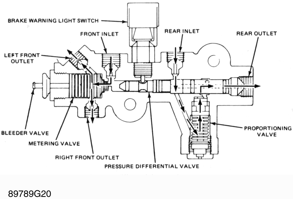

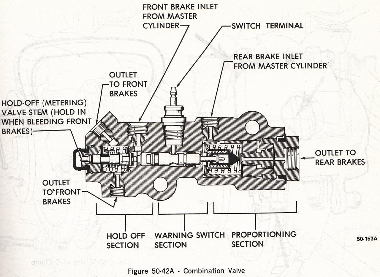

Brake warning light ON means you 1. have lost enough fluid and the piston inside the proportional valve have moved. 2. You have to recenter it. Did you "bench" bleed the master cylinder correctly?

When you bleed the brakes did you start at the further point away? Rear passenger, rear dvr, front pass, then front driver last? And make sure you keep the MS FULL the whole time. There is also a valve button/rod that you either push in or pull out depending on the style of valve.

Yes, I did bleed the wheels in that order. I did not mess with the prop valve because I got fluid out of all 4 wheels. I was under the impression that if you don't get fluid out of a set of wheels, then the proportioning valve is non-balanced, cause then you can see what side is blocked off. I can rebleed the master, but then would I also have to rebleed all four wheels?

Yes on the correct sequence to bleed, and that is the way of thinking I use when bleeding brakes. Fluid out of all do not mess with pin. So that is a correct statement. No need to rebleed the master unless you suspect it. But it the brake warning light is on, then the piston is NOT centered. Did it come on during your test drive?

Light comes on normally when you have a catastrophic brake line failure and major fluid loss. And or something causes the piston to NOT be centered. Like you have a ton of AIR still in the lines. Quite driving your truck with NO brakes or weak breaks. Period!
