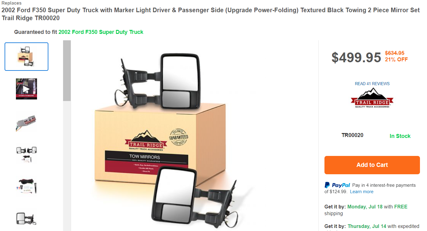

I purchased these from A1 Auto. They are the folding style that makes it easier to get into the garage. No issues so far.

Sorry, I purchased them from1A Auto parts. If you go to their site it has an installation video. They fold, have the directional and running lights and can be wired for the heated mirrors. They manually extend for towing.
2002 Ford F350 Super Duty Truck with Marker Light Driver & Passenger Side (Upgrade Power-Folding) Textured Black Towing 2 Piece Mirror Set Trail Ridge TR00020.

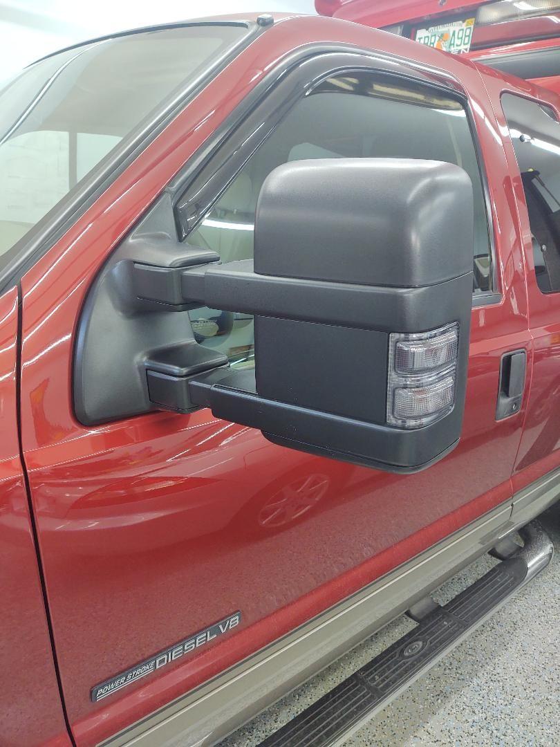

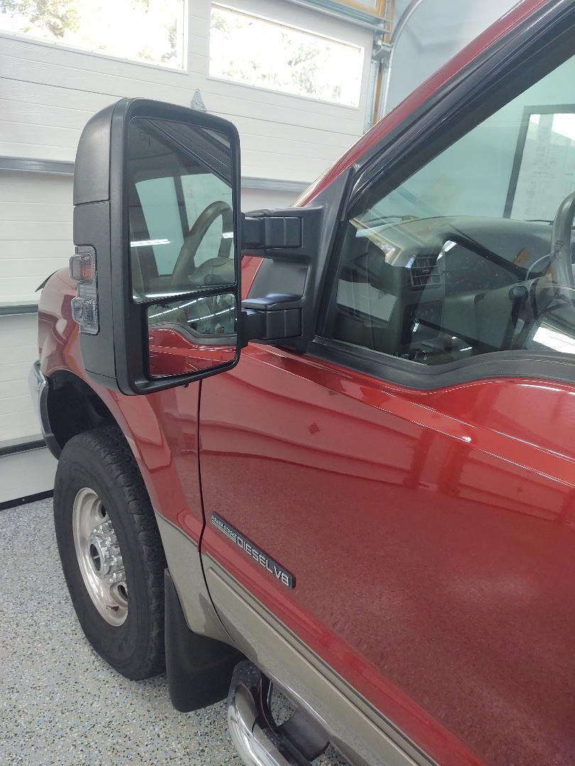

I started installing my new mirrors a few days ago, but keep getting distracted so I decided to only worry about the mirror adjustment wires for now.
Glad to confirm that the Ford schematics do indeed list the correct colors. And no, I twisted the wires together first until I tested it rather than to waste a butt splice as I did not order the adapter harness.
The ones I bought were the Akkon mirrors for 99 - 07 Superdutys. Below is the Amazon link.
AKKON - For 99-07 Ford Super Duty AKKON - For 99-07 Ford Super Duty

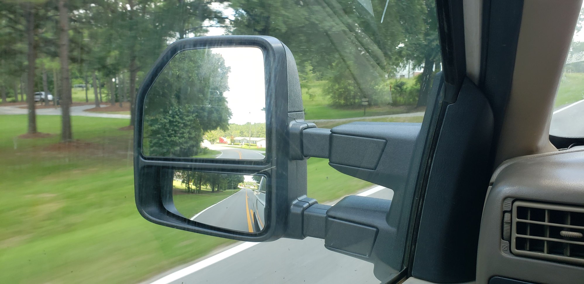

Pardon the dirty glass and the viewing angle maybe not being perfect as a passenger has to take the picture seeing how it would be just so wrong for me to do it while driving...
My adjustment switch was not working so I robbed the one from my other truck to get it adjusted. Once they are adjusted to my liking, I'll put the switch back into the other truck.
Overall I am extremely pleased with the view, especially the lower portion which would be my main focus as it see's everything including the rear tires. Makes backing into parking spots a snap!
I will run some temporary wiring to test the lights and verify if they will bother me at night before installing a set on my hotshot truck. As I've said before, EVERY installed light HAS to work on a commercial vehicle. I may just install a relay to activate the operation of the lights for "inspection" mode.

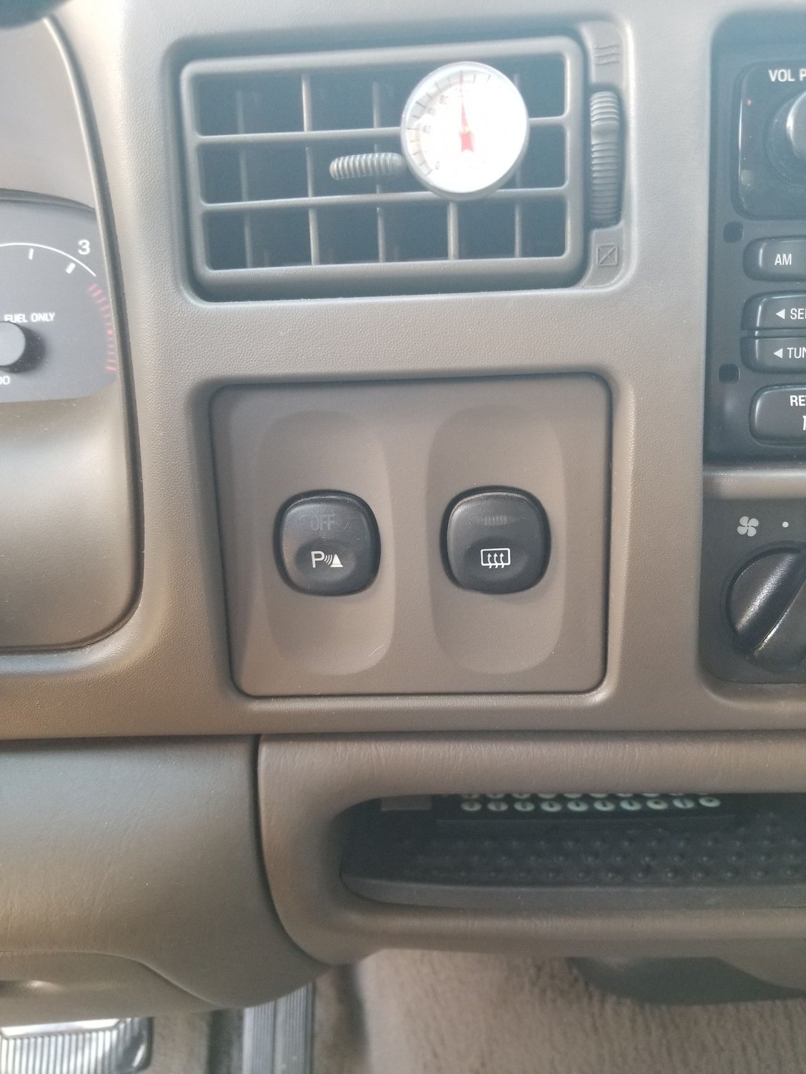

I will also add a lighted switch for the mirror heat. A timer would be nice, but I would rarely need the heat so I'll stick to... yeah, you guessed it CHEAP lol!
One other thing I noticed is that these mirrors stick out further than the stock towing mirrors for the 99 trucks - yet another reason to upgrade!
I have read of some that have used a mid-90's Explorer rear window defroster switch for mirror heat. They are a close OEM match, have the timer built into the switch assembly, and are dirt cheap if you can find them used (eBay, etc.).
You would have to find the matching connector or just use some small spade tabs to connect it to the truck.
That's good to know! I had a 98 Mountaineer until I started buying up powerstrokes. Had 4 on the road at one time with the Mountaineer parked in the garage.
95, 96 and two 99's.
With insurance and plates on all of them and I drove a service van home from work every day.

I used the Excursion switch panel...
My daily driver and hotshot truck are both 4WD with ESOF so that location is taken.
My F450 project truck however, has a manual transfer case so the switch location is available but right under that is the 5 upfitter switches I installed.
I could probably fit the switch by itself next to the ESOF switch though...

We had been told the 2017 lower mirror is a big improvement over the 2008 lower mirror. I believe this is the first driver's seat view I have seen.
I would say there is a good 30% increase in field of view from the lower mirror. I really like the 2008 over the OEM, but the 2017 is really nice in the function category.
These have been moved up my list of "things to buy". Thanks for sharing the images with us Joel.

I'm seriously contemplating moving this set to my hotshot truck. Those lower mirrors are a total game changer!
I've only taken a quick trip down the road a few miles and for country roads, the top mirrors are not even needed. I expect them to become an asset when there's a wide trailer behind you.
My rough measurements indicate that the outside edges stick out around 2 inches further than the OEM towing mirrors which will give much more visibility behind wide trailers.
By the way, these images are with the mirrors close in, not extended. If I move them to my hotshot truck, I'll get images of towing my 30' X 8.5' GN trailer - hopefully with a load to show their effectiveness where they are needed the most.
I hadn't noticed they were in the retracted position. I like them even more now.
Are you planning to do a "review or install" video and post it on your YouTube channel?
