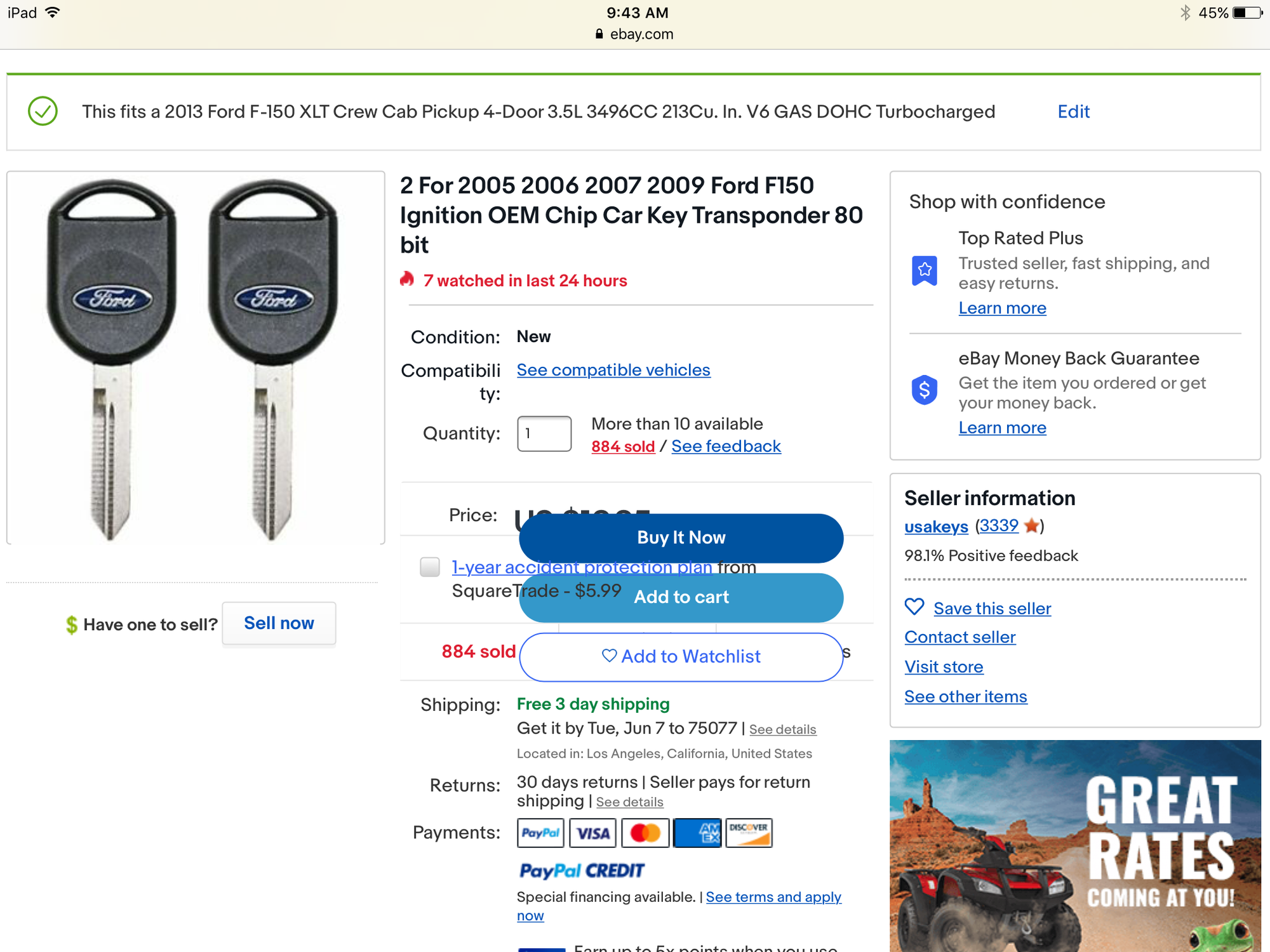

This is what I used. Got cut for couple bucks apiece, programmed my self, easy to do if you have 2 working keys. I do construction work sometimes and want as little as possible in my pockets. OEM Ford.
