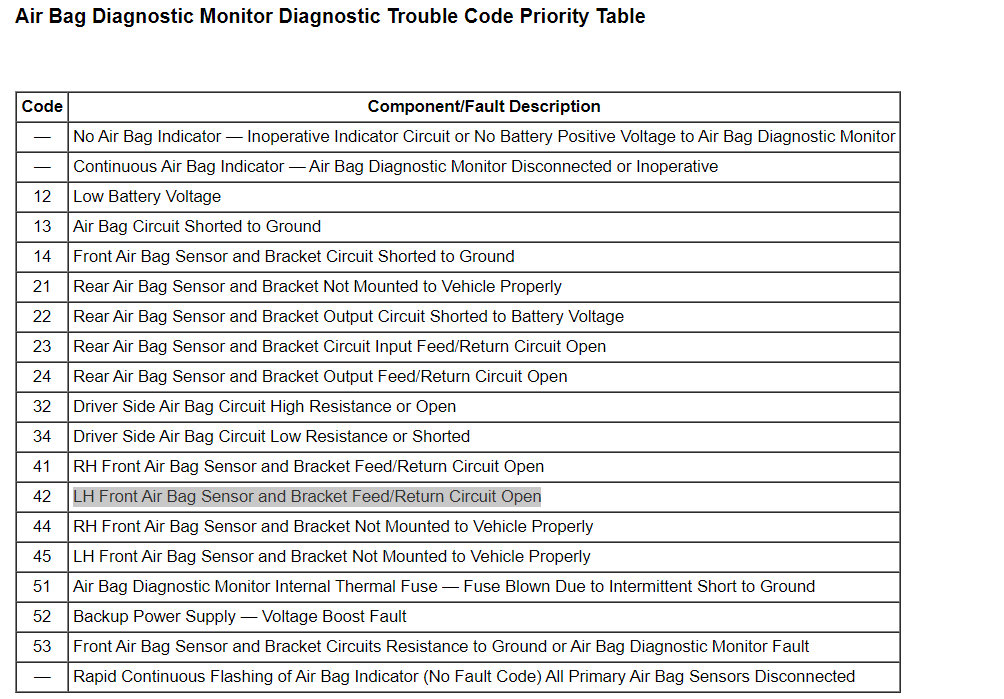

so you dont think they would benefit from unbolting and cleaning up where they mount lol. Im guessing that ground you mention is a separate code than 42? IIRC 42 is sensor fault
I just looked it up

Code 42 indicates a return (ground) fault. Implies the sensor is no longer grounded.

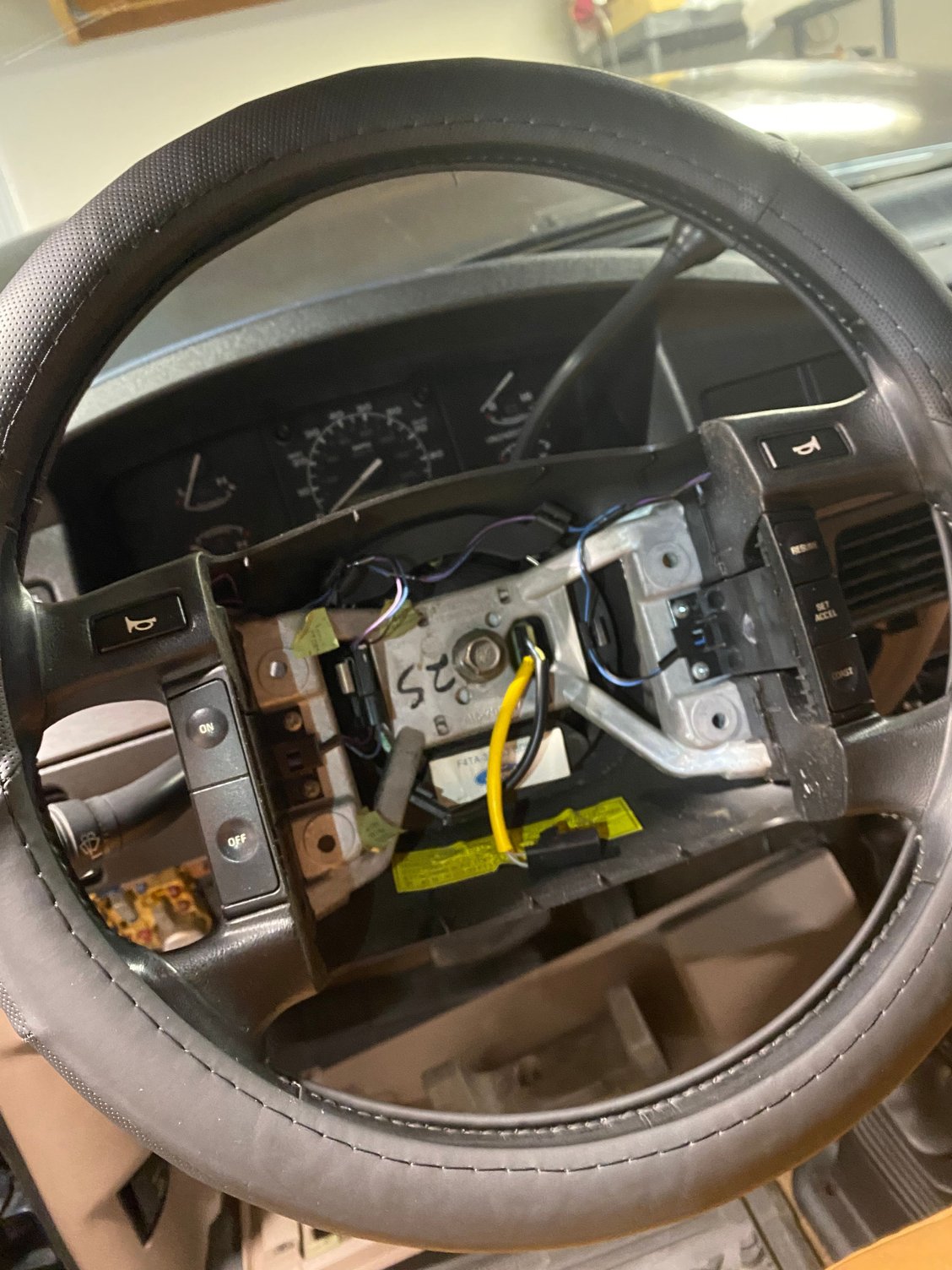

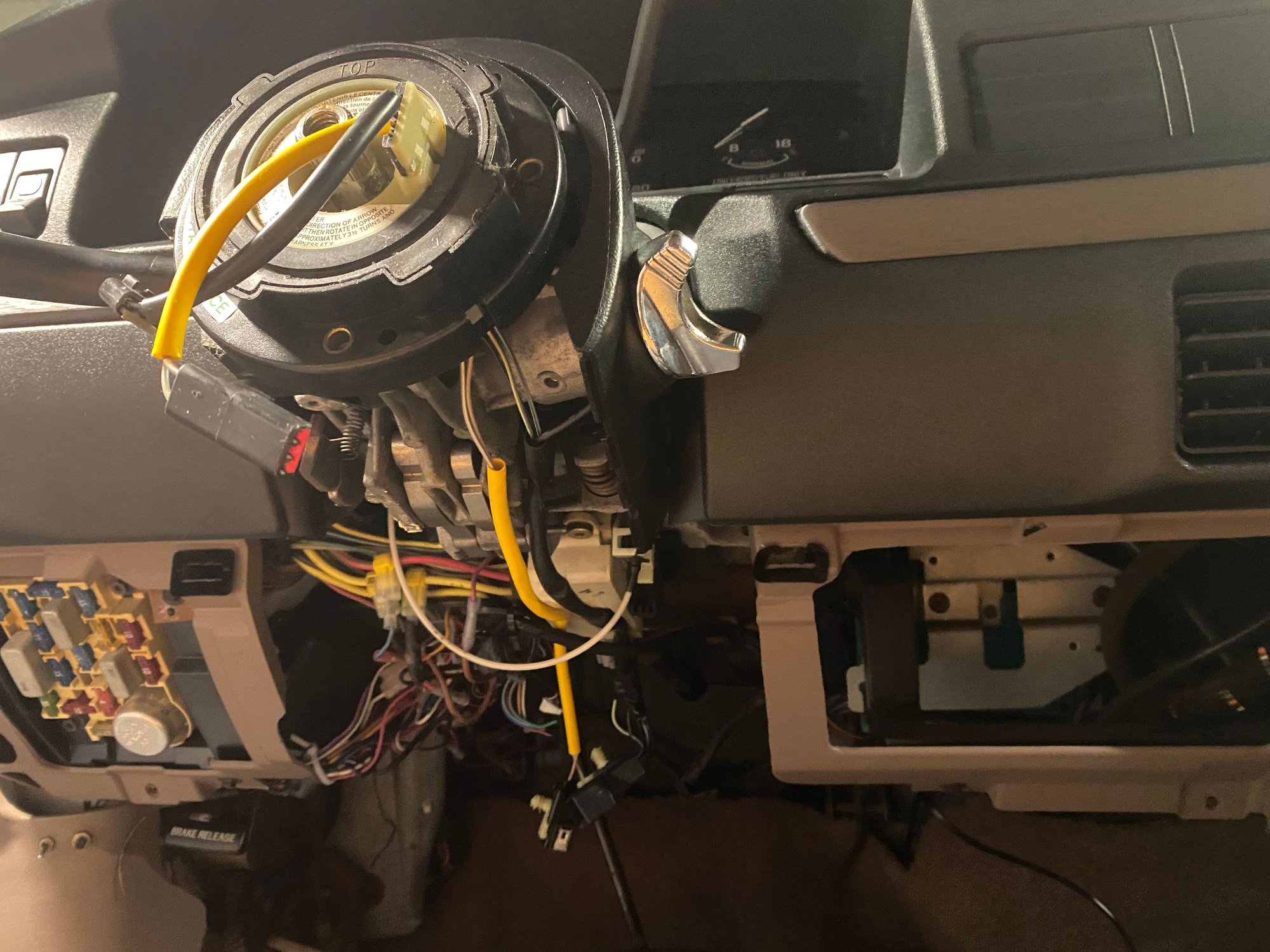

Well shes all fixed. $140 Dorman clockspring arrived earlier than $50 clockspring which im still waiting on.
I’m impatient so I installed the $140 part.. gonna return the other.
Anyways clockspring replacement took about 30minutes after waiting about 20 minutes after the battery disconnect. Easiest job I’ve done on this truck.

I looked more into it, seems the sensor grounds to the bracket its on, then to the truck, and i think I saw some bubbly crusty rust on it

The $50 clock spring from partsgeek finally arrived and I’m happy that I put in the $150 Dorman clockspring. Comparing the two the Dorman is much higher quality.
interesting to note the brown plastic clip that attaches to the ignition housing is different. The Dorman has a metal piece to it while the $50 does not.

Its funny a few weeks later my airbag light blinked again, this time with a count of "42" which was the same as your issue, anyway I sprayed some CRC electronic cleaner since you cant find a replacement sensor these days and it pretty much went away. it maybe came on one more time and then I just ignored it. Light hasnt come back on flashing code 42 in about 5 months now, who knows!
