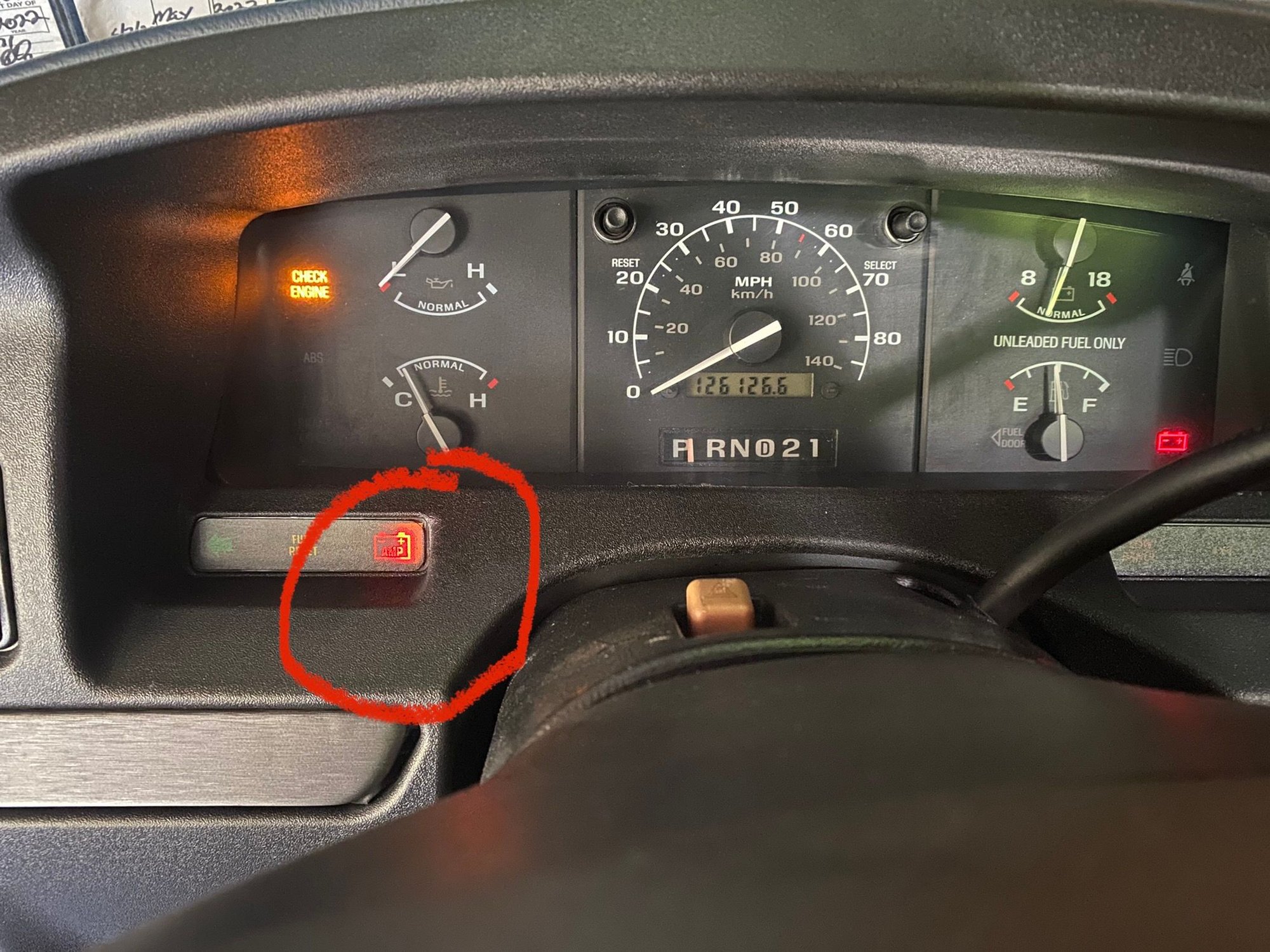

Picture taken with key on engine off. So check engine light and battery light on is normal.
To be more clear it is this light circled that flashes. Says AMP on a battery picture.
battery steady at around 14v with lights on radio on engine on.

UPDATE
UPDATE
After much electrical diagnosis and research I have concluded I do not have a battery/charging problem.
What initially manifested itself as a battery problem in association with the situation (hitting a large pothole, battery light illuminates) led me to believe that was the issue.
HOWEVER the battery light is incorrect, it is actually an AIRBAG LIGHT, the instrument cluster on my 1994 F150 is an incorrect replacement.
I count a code value of “32” when the light flashes. Horn and cruise do not work even with the TSB applied for the cruise.
https://www.fullsizebronco.com/threads/amp-light.364818/
I will order the clockspring and update you all.
