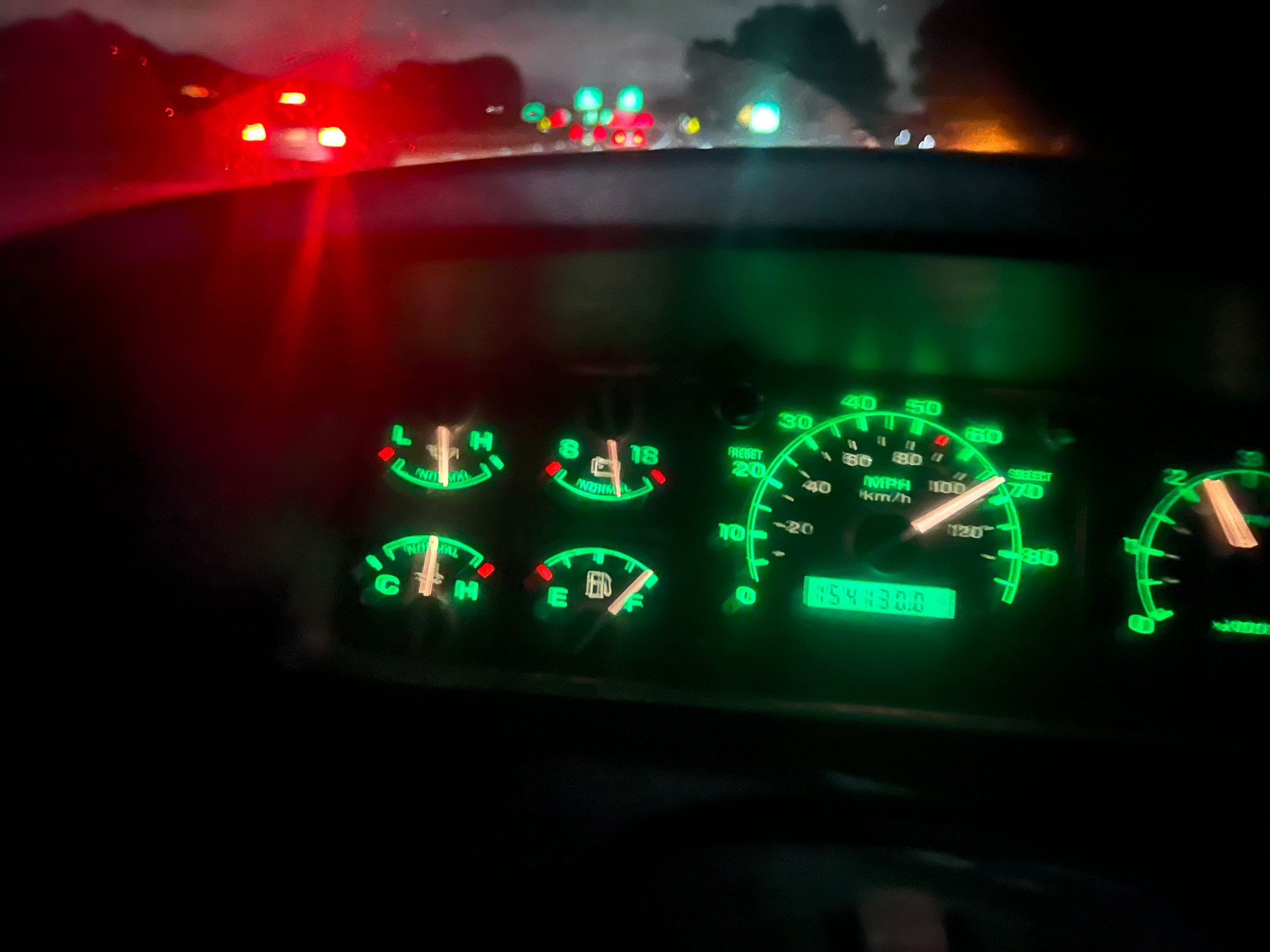

Here’s my issue. At least once EVERY time I drive my truck the temp gauge will race towards the hot side of the gauge. When this happens the idle will come up, as the system is designed to. I really don’t believe an engine can heat up or cool down as quickly as my problem presents and then corrects. The truck will go from normal operating temperature to almost in the red, then back to normal over the course of a minute.
I took these pictures on my drive home tonight to illustrate.
Here I am, cruising along at a steady throttle setting and the temp gauge reads where it should.

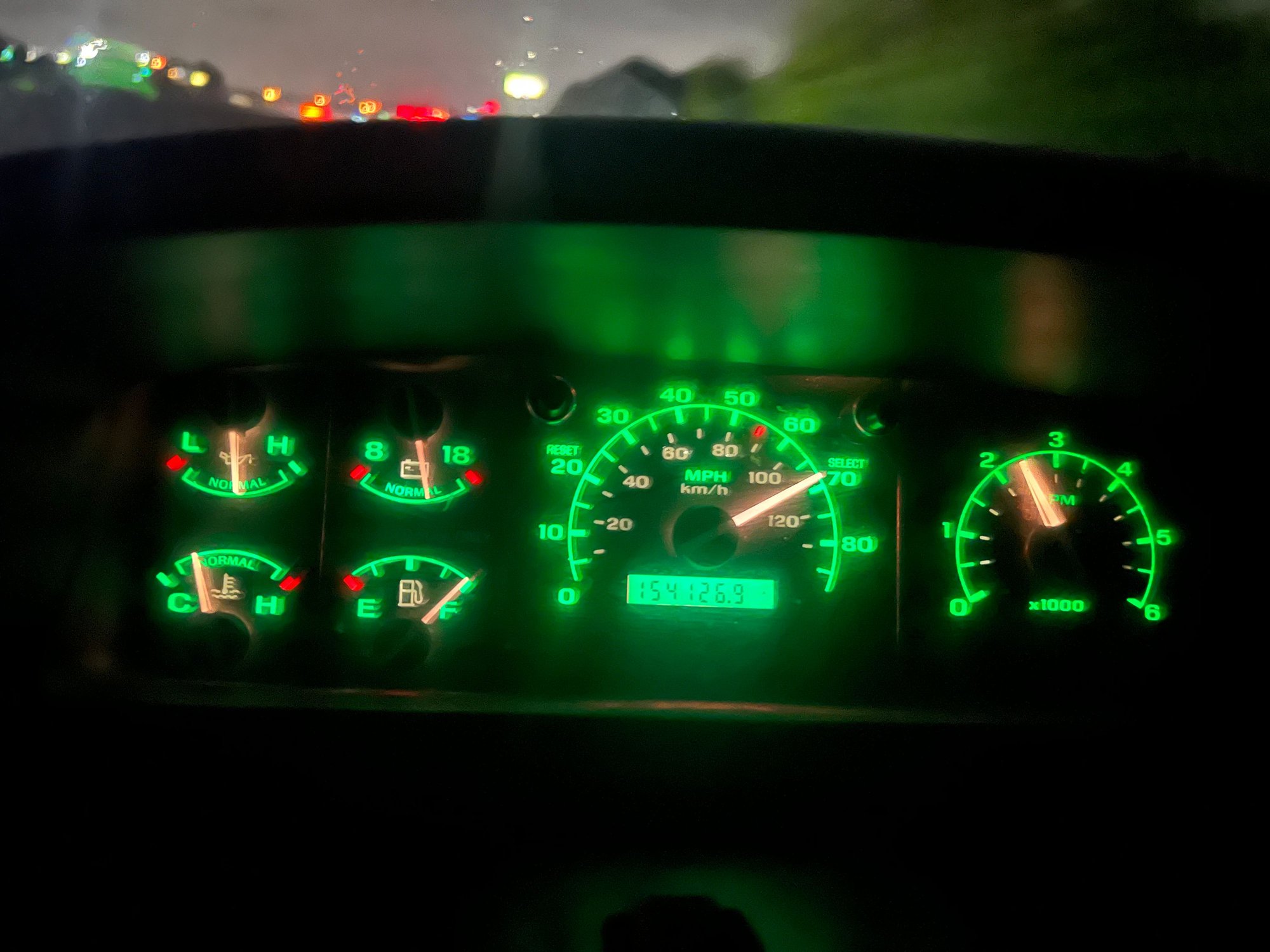

I wasn’t fast enough to catch the climb upwards, so here’s about where it gets to before starting to come back down:

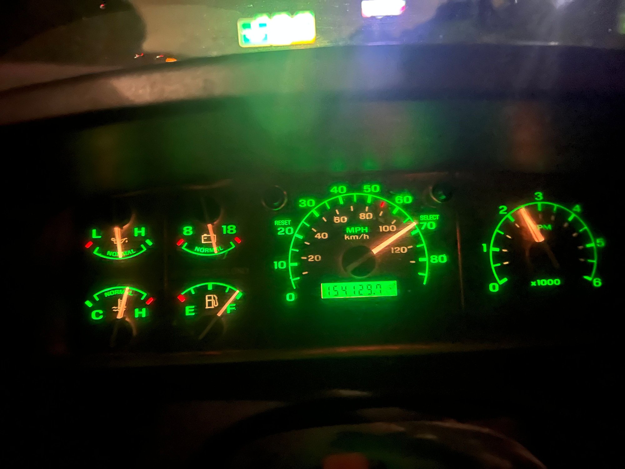

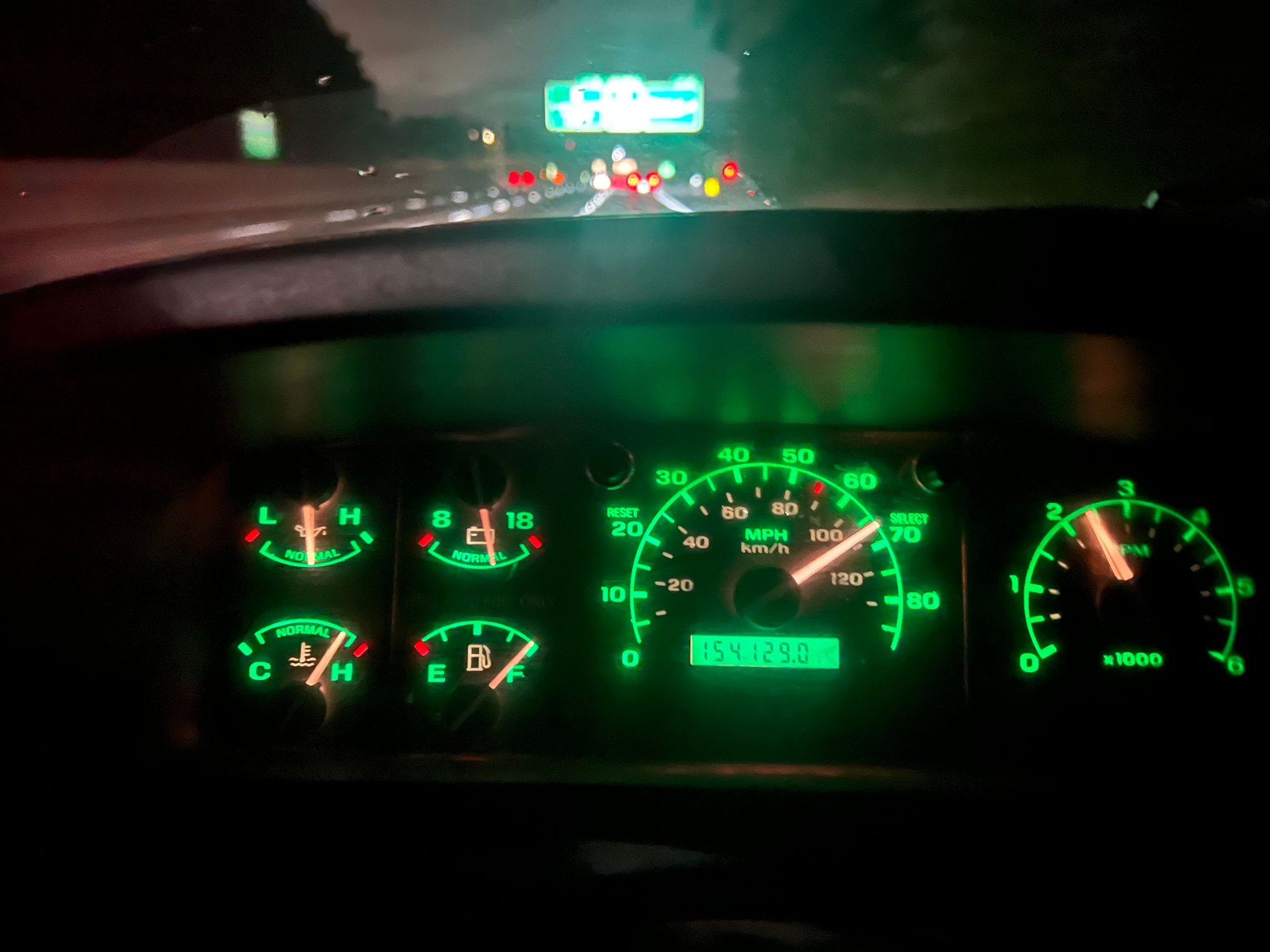

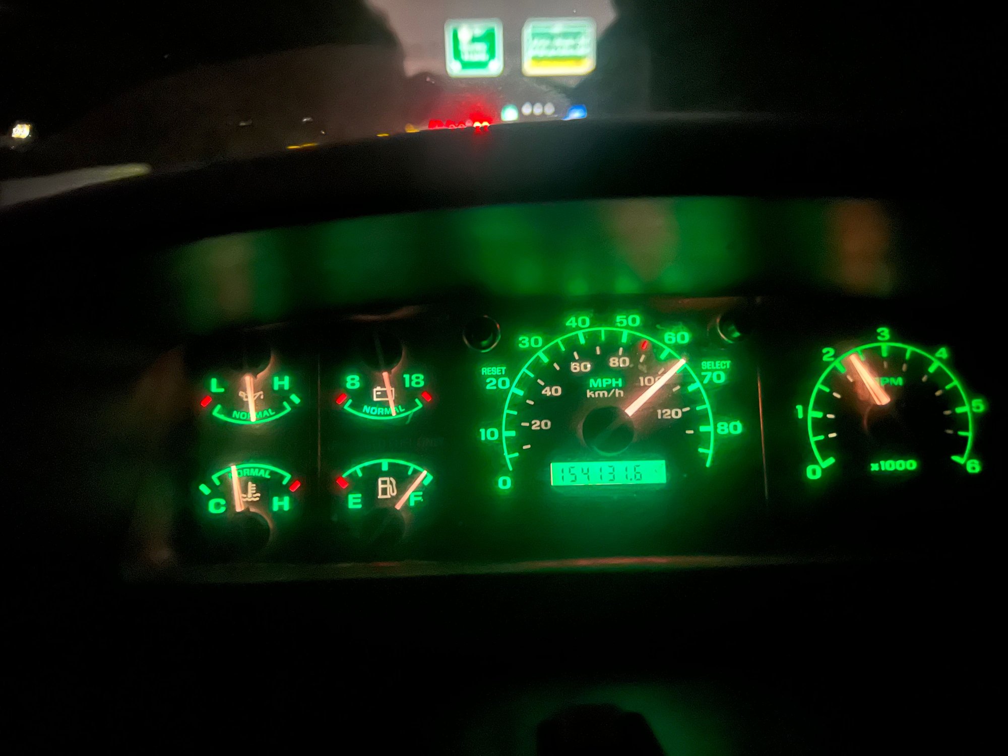

The next couple of pictures were taken over *MAYBE* a minutes time:
With an iron block and heads, I just don’t believe there’s any way possible that the engine could heat up so quickly OR cool down so quickly.

The temp gauge has it's own sender which does not go thru the ECU. The ECU gets it's temp signal from the ECT sensor. By your description, the temp sender and the ECT sensor agree the truck is hot, so perhaps it is. Putting in a mechanical temp gauge to check the actual temp is a good idea.
