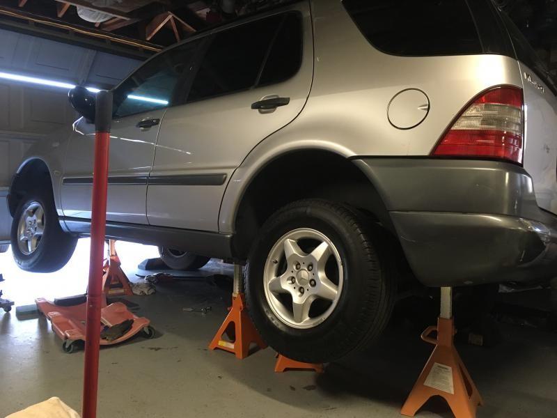

Yeah, the taller jack stands work well in that situation. Blocks are cheaper for sure. I was lucky to do this on a rust free truck and SUV.

Sorry, couldn’t get past 30 seconds,
For those that may not want to use garden blocks to hold your 9000 pound vehicle way up in the air.
1. place jack under rear differential and give it 1 pump to lift both tires 1” off the ground.
2. go place jack stands under the frame right in front of the forward leaf spring mount about 2” below where the frame now sits.
3. remove rear wheels
4. lower rear axle and verify jackstands are well placed, lower jack and remove.
Repeat in front
it is now low and stable , your Excursion suspension is now ready for removal
