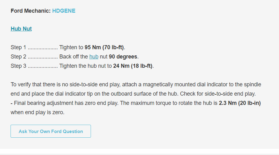

what is the proper way to tighten the spindle nut?
Old Nov 7, 2023 | 11:59 AM
RA122823's Avatar
RA122823
Joined: Oct 2023
Posts: 154
Likes: 21
cant remember, i googled it and found a YT video that had torque specs, basically rotating the rotor while tightening the nut, back it off and do it again and torqued to whatever it was. The rears are a locking ring thing you just keep sending till tight with a punch...

If you want to actually use a torque wrench
Torque the nut to 18 ft. Lbs. to seat the bearings
Back it off 1/4 turn
Retorque to 25 inch pounds
Old Nov 8, 2023 | 08:14 AM
foot pounds... not inch
thats for the front, i was referring to the dually rears in the other post.

Which bearing nut do you have on the rear?
The ratchet type or the 2 nuts style with the indexing washer?
Both are easy as well
I do not rely on a torque wrench for those either as you will either get it too tight or not tight enough
Same sequence, tighten to take up all slack and preload the bearing, back it off and retighten to obtain .006"-008" crush (preload)
If you are really concerned about actual torque
Check google or a service manual for the torque specs and method
The 2 nut style is easy, 18-22 inch pounds on the inner nut and 150 ft. lbs. on the outer
