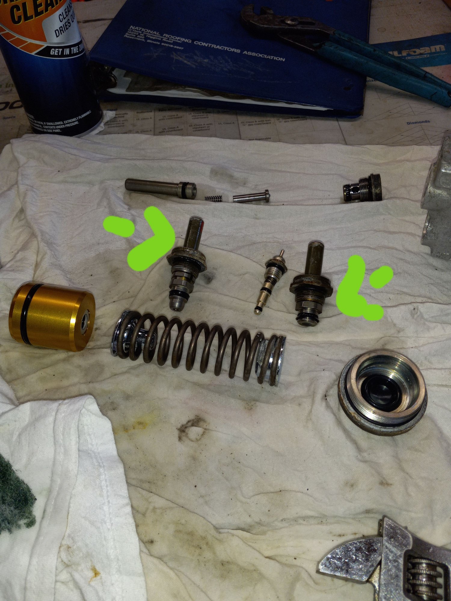

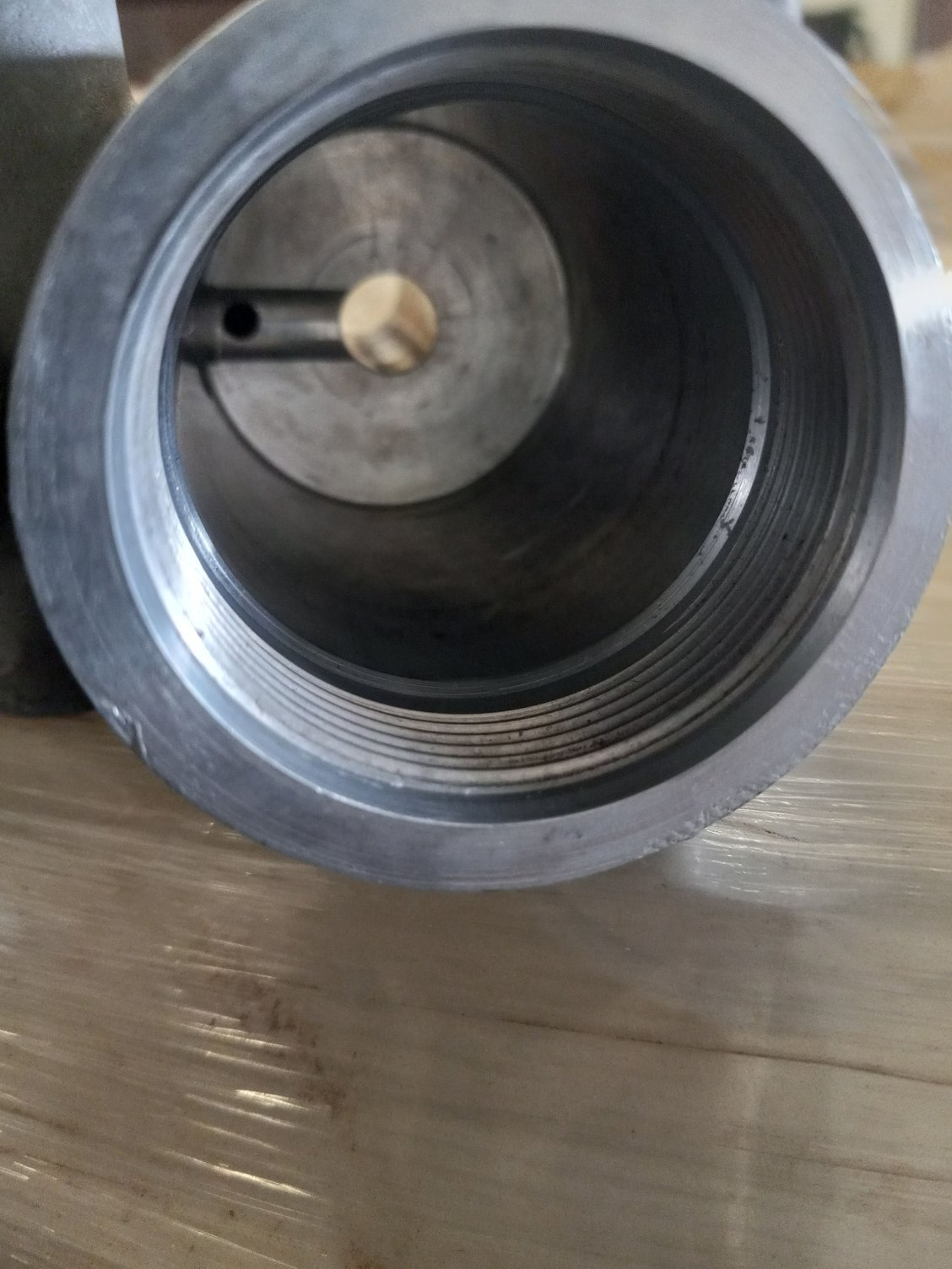

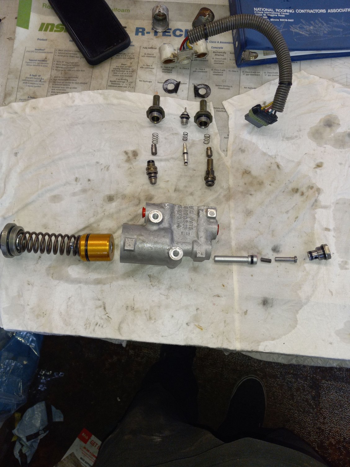

Just a view of a disassembled 2wd ABS valve for those who are curious of how they look.
before
After

I am one of those curious sorts. Out of that same line of thought... what inspired the tear down? Rebuild? Your own curiosity? etc.?

Mostly curiosity.
If anybody knows if they sell a rebuild kit I'm all ears.

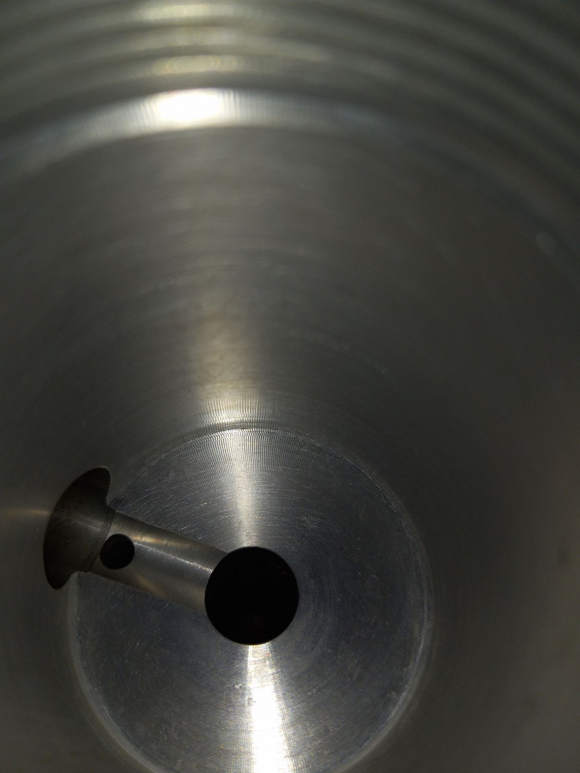

Just at a glance, it seems to me that the rebuild kit would be primarily comprised of replacement soft parts (looks like just o-rings and maybe one plastic seal), I sort of doubt that the big spring would need replacement, but that could be another potential, but there is that little spring, too.

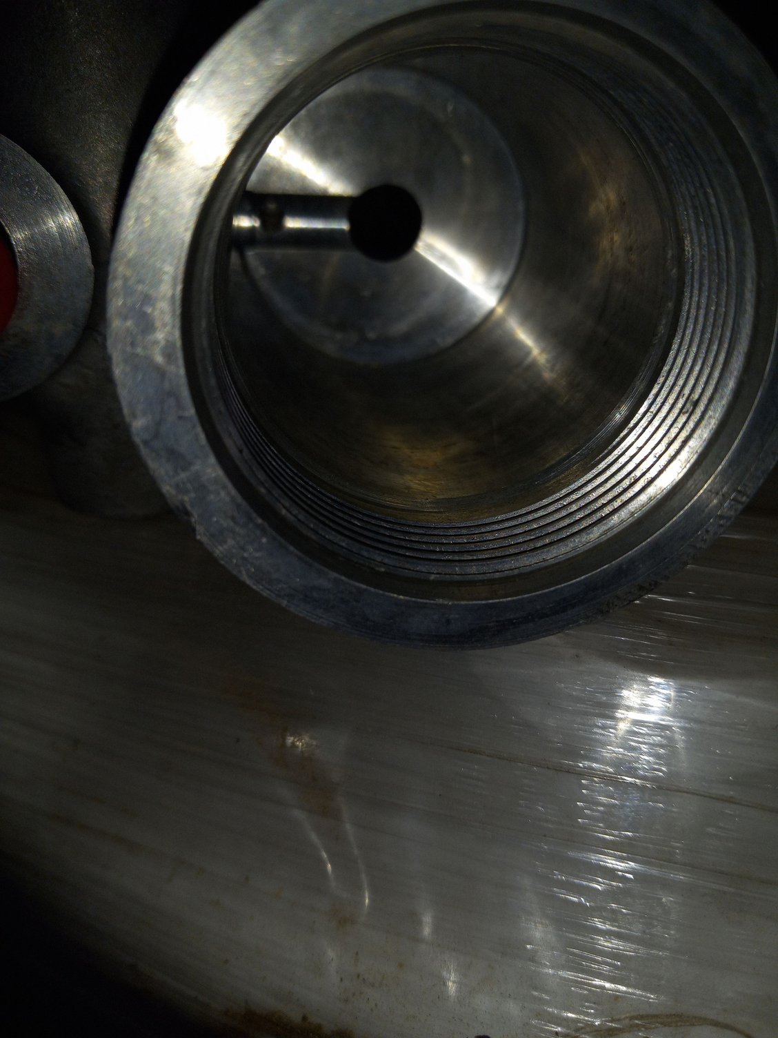

That's my thoughts as well. All soft parts, there's no real metal to metal sealing. As long as the bore doesn't have vertical scratches, and even at that I used greet scotch Brite and cleaned really good. The valve itself had a lot of varnish but cleaned really good in the parts cleaner.

There is also the switch, though, but that is at least an external part.

Almost forgot the 2 flow control valves and I'm assuming the center one is one as well. I'll dig in further and take more pictures

Here's those valves disassembled
There's 2 O rings in the right arrow and one big O ring on the left arrow
Center valve (the one that looks like a glow plug) broke at top, small piece is still stuck on the head, seems to be made of a soft alloy maybe aluminum? And yes it was removable, but it got stuck somehow and I broke it, oops.
