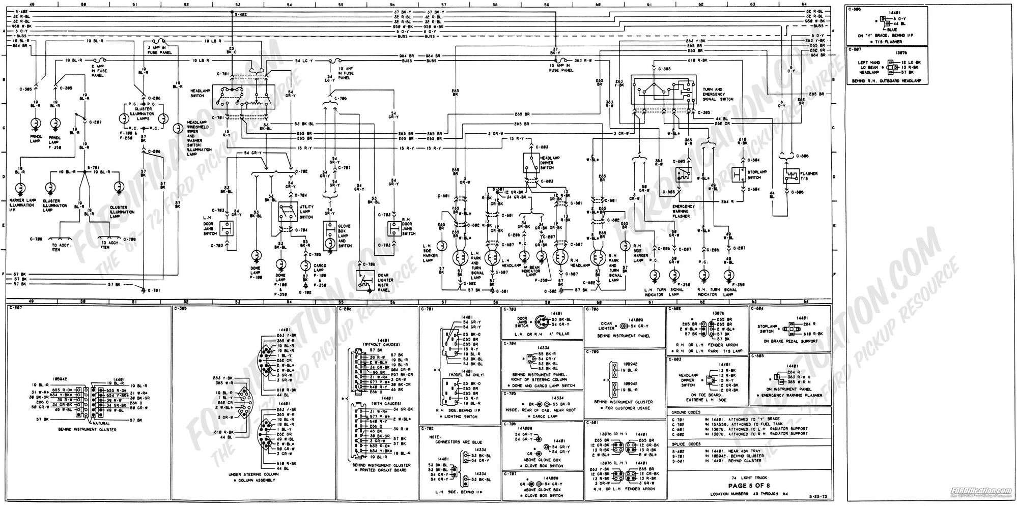

Originally Posted by Restenhaus72
I am going to try & find the wiring circuit for my T/S switch so I can ID which wire controls the right brake light.
Here is the relevant factory diagram.
The t/s wiring is in the upper right quadrant.
Thanks to Mike, there ya go. One wiring diagram, comin' right up!
The right hand brake lamp (stop/turn/flasher) according to that diagram is the White w/blue wire. Again, same single wire handles the turn signal, hazard flasher AND stop lamp duties.
So from at least the firewall back to the rear of the truck, there is only one wire working that corner's bright filament.
Nothing wrong with the wire or the lamp housing itself because you have turn signals.
The Brown wire handles the running lamp duties on the second filament of the tail light socket AND for the side-marker lamps.
In theory your '73 should still have the early style lamps in the rear, where you can remove the lens and there is a metal reflector housing with integrated sockets. Nothing wrong with checking them out at least, but the problem is not back at the lights themselves, but somewhere upstream.
Hence the focus on the turn signal switch.
Regarding the tail lamps though, trust the diagram, but verify! Because some things just don't work for the craziest reasons!
Paul
