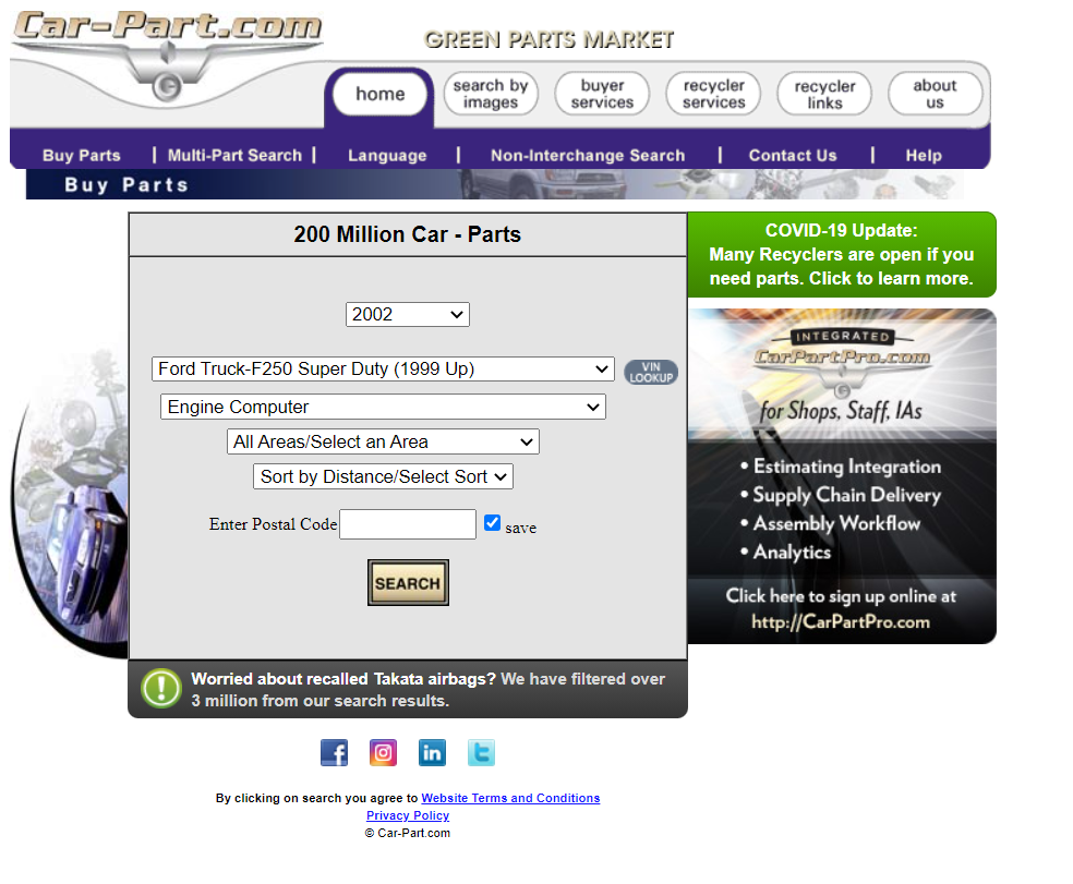

The source (www.car-part.com) that SSJ recommended is a good source to find odd ball stuff. I have used them in the past a couple of times and once while on the road 5+ hours from home and cracked a rim. I found a junk yard 45 minutes from our location at the time and they had a set of rims and I selected the best condition rim.
As for finding a GEM on car-part, you need to go about it a certain way as the website is somewhat difficult to utilize at times based on what you are looking for.
I believe you need to use the search criteria "engine computer" as seen below, but that may be for the PCM.
Disregard the year being 2002 in the image, I used this in a previous post.

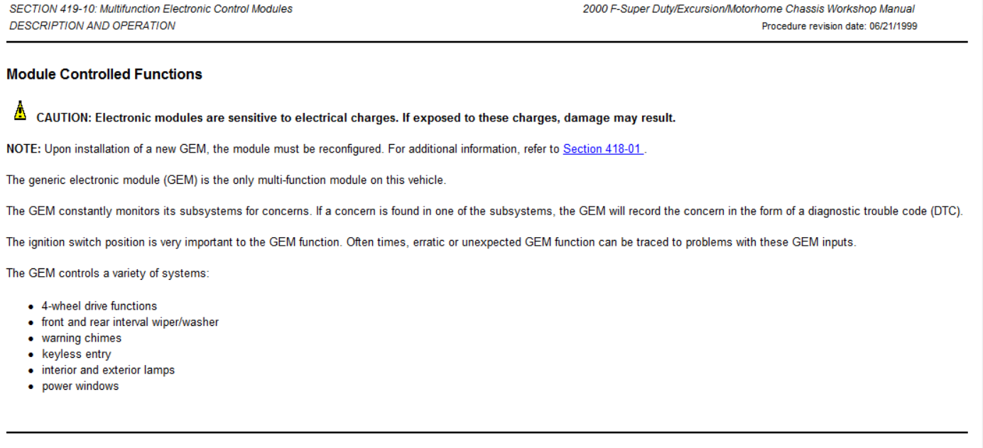

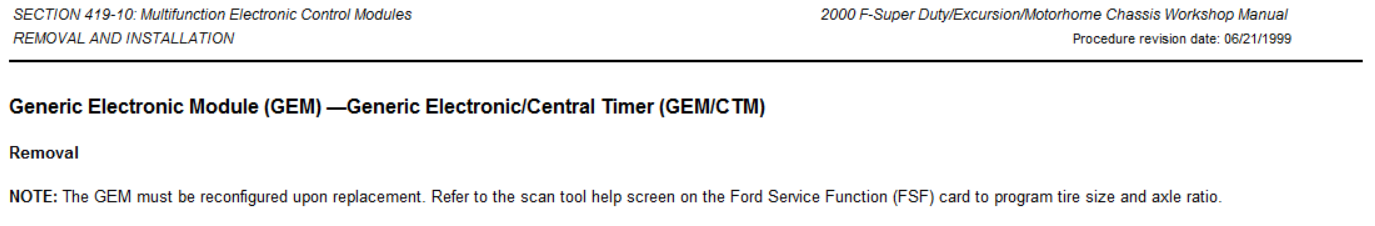

As for having the GEM flashed by the dealer, this is partially true. I am fairly certain if you can find the EXACT same part number GEM, then you are good to go. If not, the GEM may need to be reprogrammed by the dealer as this is the module that set the customer accessories and options up in the vehicle. Stuff like power windows, ESOF, etc... That is not to say the replacement GEM will not function properly though, so give it a shot first and roll on from there.
