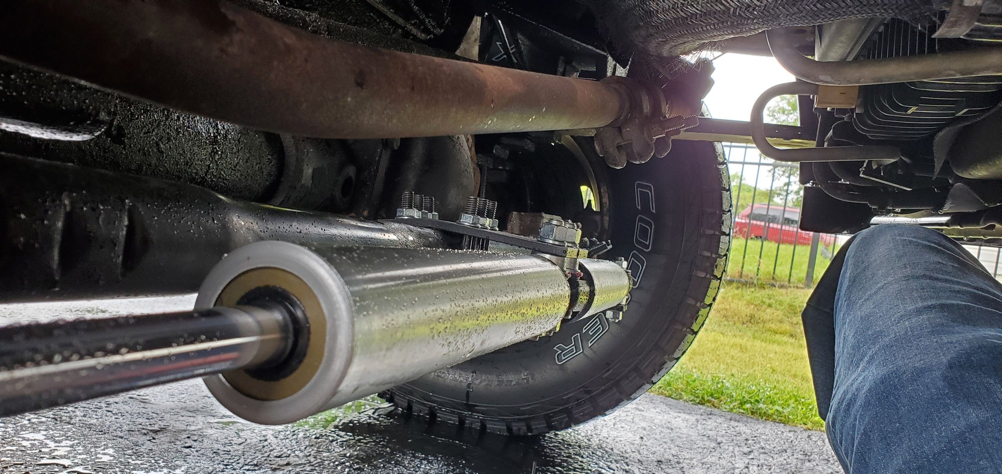

Originally Posted by Tunafish389
Well you will have to take that up with rough country who makes the kit. Its posted in all their listings about must have 2" lift. Those are the only two item that move with a lift.
Here's the difference, Rough country mounts there's higher (closer to the drag link) than the stock location (stock and RC mounting locations identified in red and the drag link in blue in the pic below). So the drag link wouldn't have to move as far down to hit them. For stabilizers mounted at the stock location (or duals like the BDS which use the stock mounting location for one end), the drag link simply can't get that far down before something else contacts (bump stop or frame).
The tie rod stays in the same place and doesn't move with suspension travel, so its not tie rod interference.
So what you're saying is that even if I didn't put the leveling kit on there like rough country said I had to - the drag link would never touch the stabilizer? Does this account for some rough bouncing as well or with sagging springs?
No, the drag link (not the tie rod, the drag link) could hit the Rough Country stabilizers, because Rough Country mounts them so much closer to the drag link than the stock location.
If the stabilizers were mounted in the stock location (even dual stabilizers that are setup like the BDS kit pictured), then no leveling or lift would be needed, but since Rough Country mounts them so much higher/ closer to the drag link, you'll need a level/ lift to work with their kit.

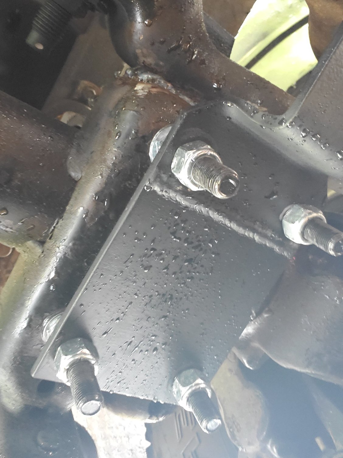

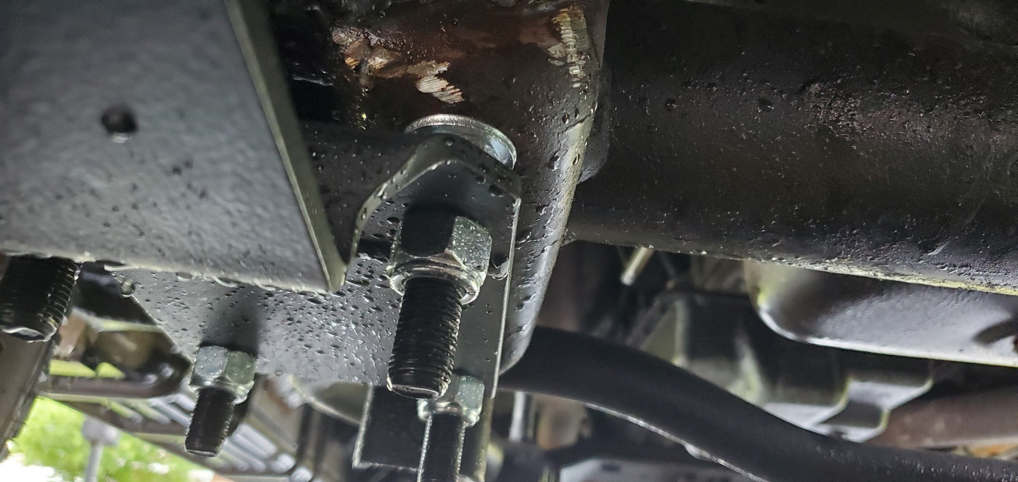

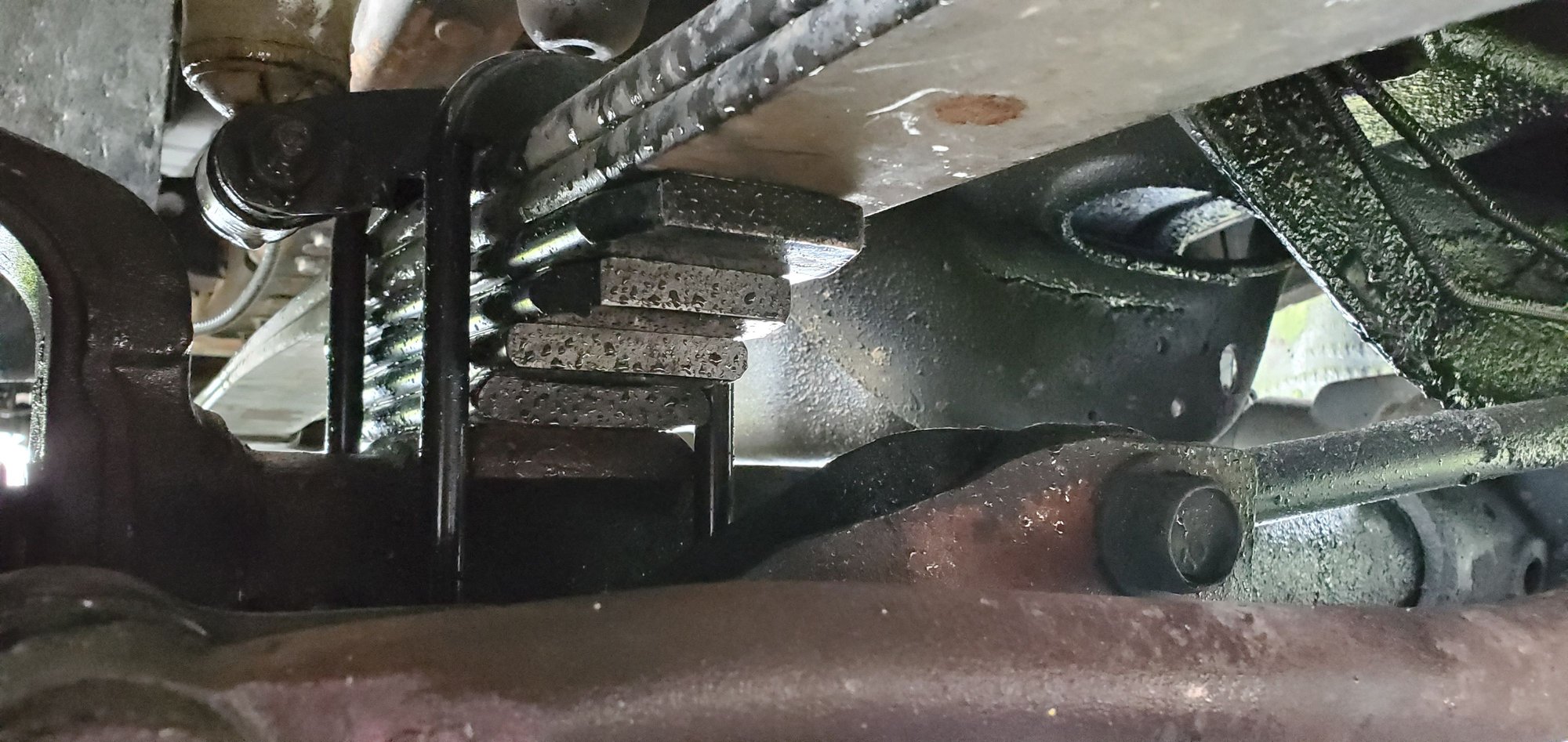

Update
I finally got everything in, the leveling kit ended up being on backorder. Got the welding shop to grind out the previous weld on the saddle and put a fully penetrating weld across the entire thing. I tried to get a picture of it today after I got the alignment done, but there isn't a good angle to see it and there is a LOT of water on the ground from rain. If someone really wants to see it, I'm more than happy to take another picture when things dry out. The shop also took the Rough Country bracket, put a 45 bevel on it and a new piece of steel and threw a great weld onto it and drilled out some extra bolt holes. Looks great, bolted straight on. Only thing left to do is wait until it's not raining and then hit the area with a wire brush and some paint to protect the weld.
Had terrible issues getting the alignment pins on the leveling kit lined up though... When the axle was being raised up I noticed that the entire axle was shifted to the driver's side by about an inch and a half and it took plenty of persuasion to get it forced back over while lifting it. Not sure how/why it was shifted like that even when the axle was fully supported, but it's something to be mindful of if you do it yourself. The only thing I didn't do was disconnect the tie rods so that might have been a contributing factor.
If anyone is thinking of doing this exact same thing and making a bracket to cover all 4 leaf spring bolts there is something to watch out for. The new u-bolts from Rough Country are *NOT* the same thread and you'll need 2 extra nuts. Factory bolts are coarse thread and the new ones are fine thread (more threads per inch). I had to go searching parts stores to find 2 additional nuts that were the right size and I got lucky enough that they only had 2...
Prior to the leveling kit, the rear of the truck was about 1.5 inches higher than the front (forward rake). Now the front sits exactly a 1/2 inch higher than the rear. Looks wise, it appears perfectly level between front and rear because of how long the Ex is. I was worried that raising the front would make it look like one of those stupid North Carolina jobs where the front is raised like 3 feet higher than the rear....thankfully it does not.
Post install it pulled hard to the right and my steering wheel was about 30 degrees off center while driving. Post alignment everything is perfectly straight. The only real noticeable difference is that with the dual stabilizers, there is a lot more force required to turn the wheel from center. It almost acts like the self centering steering help you get from new cars and it's pretty nice.
If anyone else has something similar to this happen to them, here's what I would recommend. Go buy a welder. *Welding is not difficult at all and you just need to practice on a couple pieces of scrap to get a feel for it.* Visit a welding shop and see if they are willing to give you some scrap steel, most will. Fabricate your own @#$% bracket and weld it to the tube yourself, just make sure it's level. You can build something way beefier than what the factory did and do it for next to nothing cost wise. When you're done, return the welder and you'll only be out maybe $20 total plus your own time. If the weld ever breaks again (unlikely) I will make my own saddle from 1/4 inch plate.
Lastly, the stabilizers did not come with any boots. I recommend that you check any kits you order to see if they are part of the kit, if not then find some to put on. I don't have the time to get some in before I have to make another long trip, but you don't want to jack up the exposed area and then have it damage the seals. A $5 boot will save you a $50 stabilizer.
