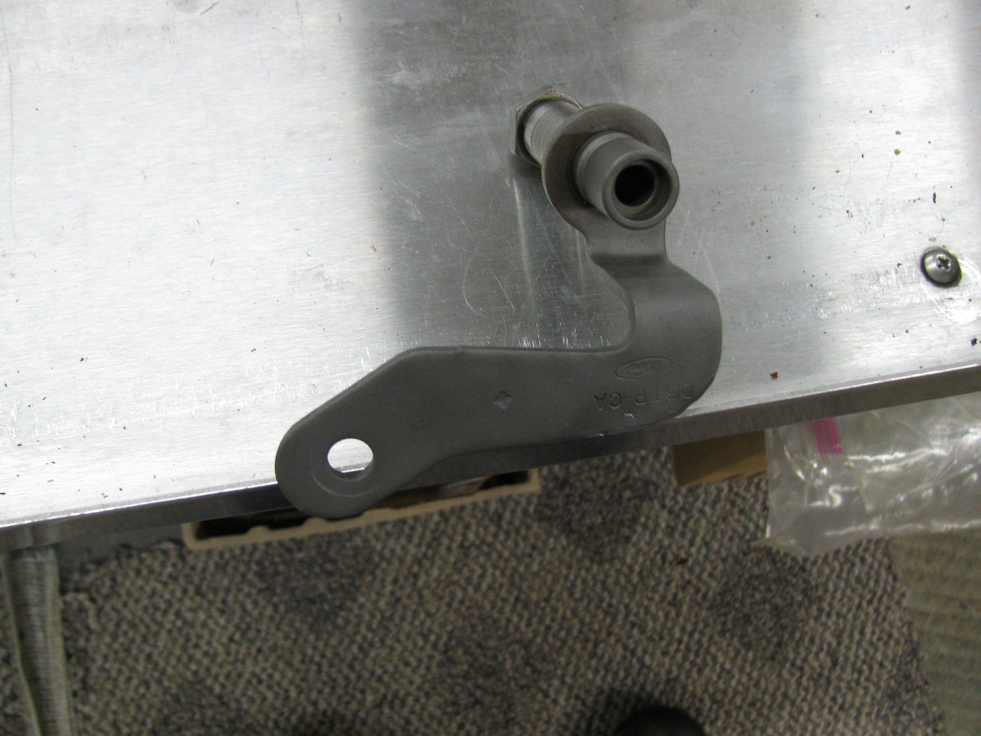

Did this C6 you have come from a truck? You need the shift rod from a truck that had a C6 in it. Your transmission MUST have a manual lever for a truck. This is a manual lever from a 73 truck with a C6. If you do not have the correct manual lever in your trans the detents in the column will NOT line up with the detents in the transmission. There is another manual lever that will work it is stamped E0TP-CA It was used in 1980's trucks and forklifts. But it must be heated and bent up about15 degrees until it is parallel with the pan rail.

Yes that's the same as mine just don't have the linkage between this and the colomn

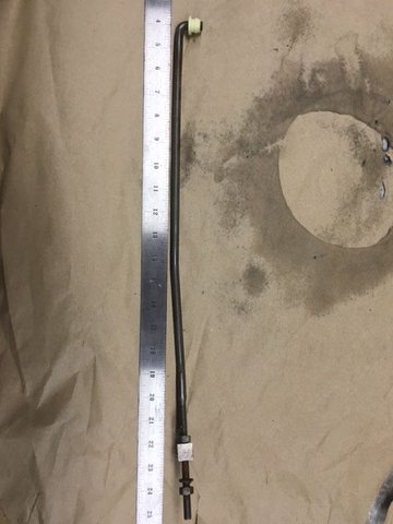

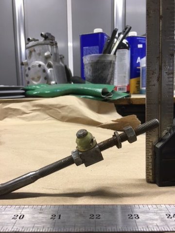

Shift rod
This is out of a 70' I believe. I took the column and trans from it to replace the NP435.

Thanks that looks like it will be easy to make
