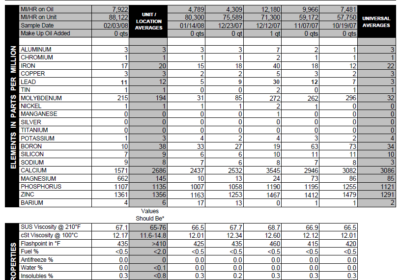

See attached
From the other Forum member for Schaeffer 9000

For the "other member", calculating the lead loading for a 5k mile MIS, the numbers are more in line with Marks.
"Moly" can be abrasive depending on the type, but also the particle size. If the particle size is larger than the oil film, it can wear on the bearings. Our engines take a bit to establish oil pressure on start up, so oil film is thin initially. Often when we look at PS main bearings, you see more of a worn area at the center of the bottom shell. Starter crank rotation and compression loads are not that extreme, but once the diesel fires off, the loading is the highest until full oil pressure is established.
It looks like there is a lot of moly in that oil.
