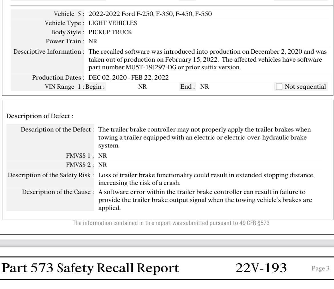

Just curious where you are getting these dates. They don’t match the recall info I’ve seen, which states that the defective/recalled software was introduced into production December 2, 2020 and removed February 15, 2022. It also stated that software re-flashes began at KTP on February 14, 2022. So I would imagine if you have a truck that was manufactured after February 14, 2022 you are good, but anything before is likely a recall, all the way back to December 2020.

The model year affected doesn't make any sense. If the bad software was introduced 12/02/2020 then doesn't that mean the 2021 model year trucks would have the bad software? So far, it's only been 2022 trucks that are seeing this issue, right?
Ummmm, I said December/January/February timeframe which what was stated on the recall. I didn't give exact dates, but it was for the most part correct.
Old Apr 12, 2022 | 12:55 PM
chadstickpoindexter's Avatar
chadstickpoindexter
Joined: May 2021
Posts: 5,818
Likes: 3,453
From: Uh oh, CA
Ok. The recall must state different times than the NHTSA then, which is what I shared above. The NHTSA lists a lot longer time frame than those 3 months.
