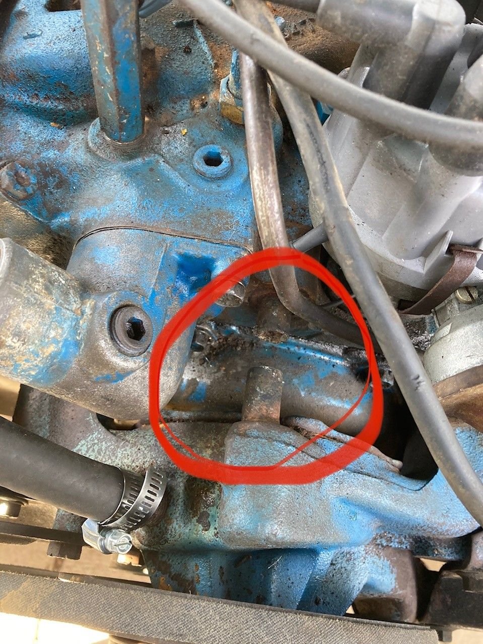

2) Picture below. 2 inch hose that connects the two was rotted. How in the heck do I install a new hose in that tiny spot ? Unless the hose is super thing and mallable, nothing will fit / bend in there ?

2. You take the water pump off.

clean the rust off both nipples as best you can so the new hose slides easily. cut the new hose just long enough to reach each nipple AND have sufficient room to clamp each end...warm up the new hose, put soapy water inside, slide all the way onto the water pump (or until the back edge of the new hose clears leading edge of the back nipple) then slide the hose back toward the engine until both clamps fit correctly.

X2 make sure you got the correct application radiator hose. getting the once you need can keep the pipe of out the fan or other truck parts.
X3 cut the replacement piece as long as the green box, NOT the yellow one. Clean the exposed pipe pieces very well. X100 get the little piece of rubber hose warm (put it in a cup of hot water) and then add some soapy water to it. Slide it on the longer piece of pipe then center it up on both and install hose clamps.
Looking at both open ends of the pipe now, you need to flush the cooling system very well.

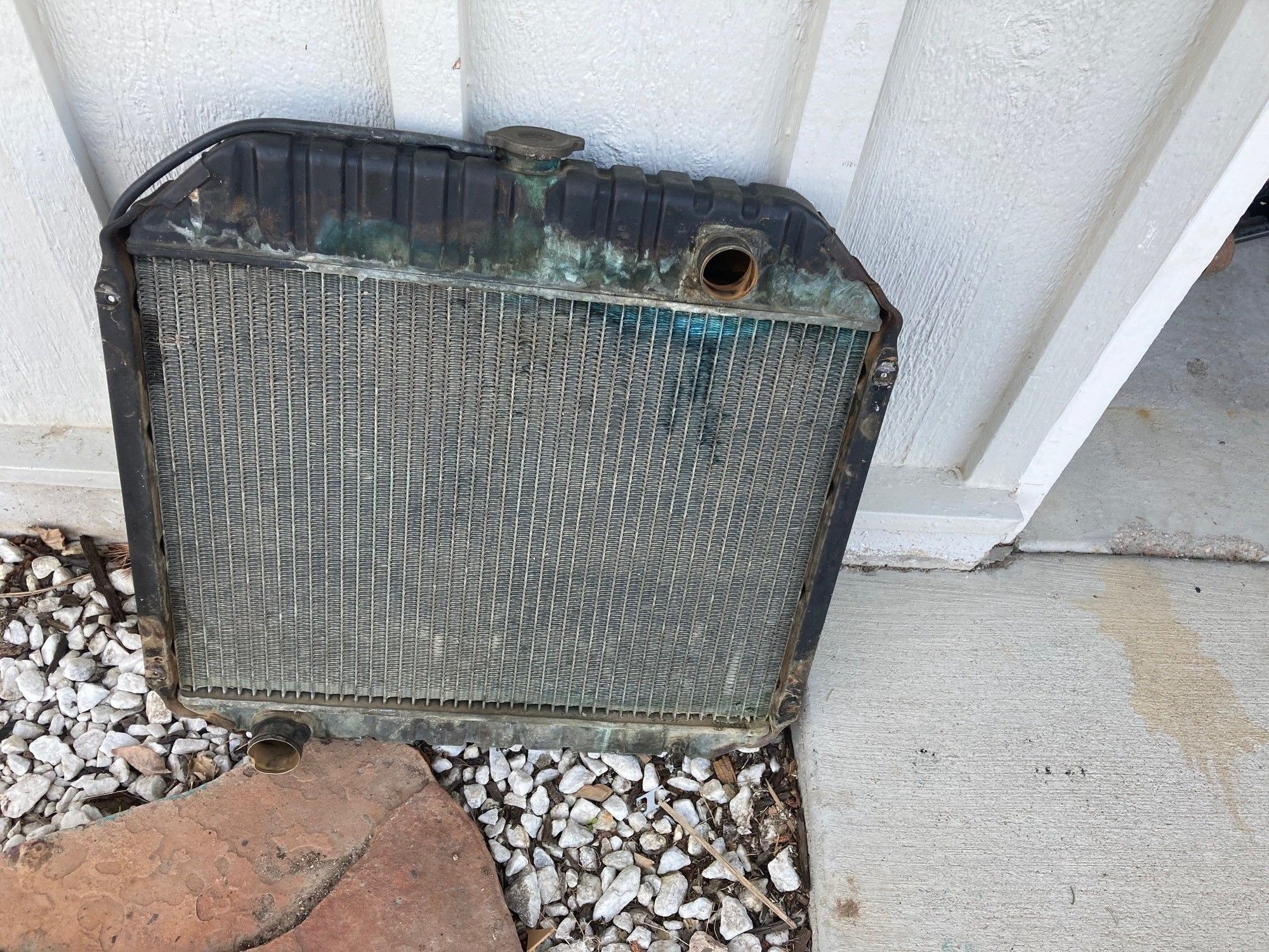

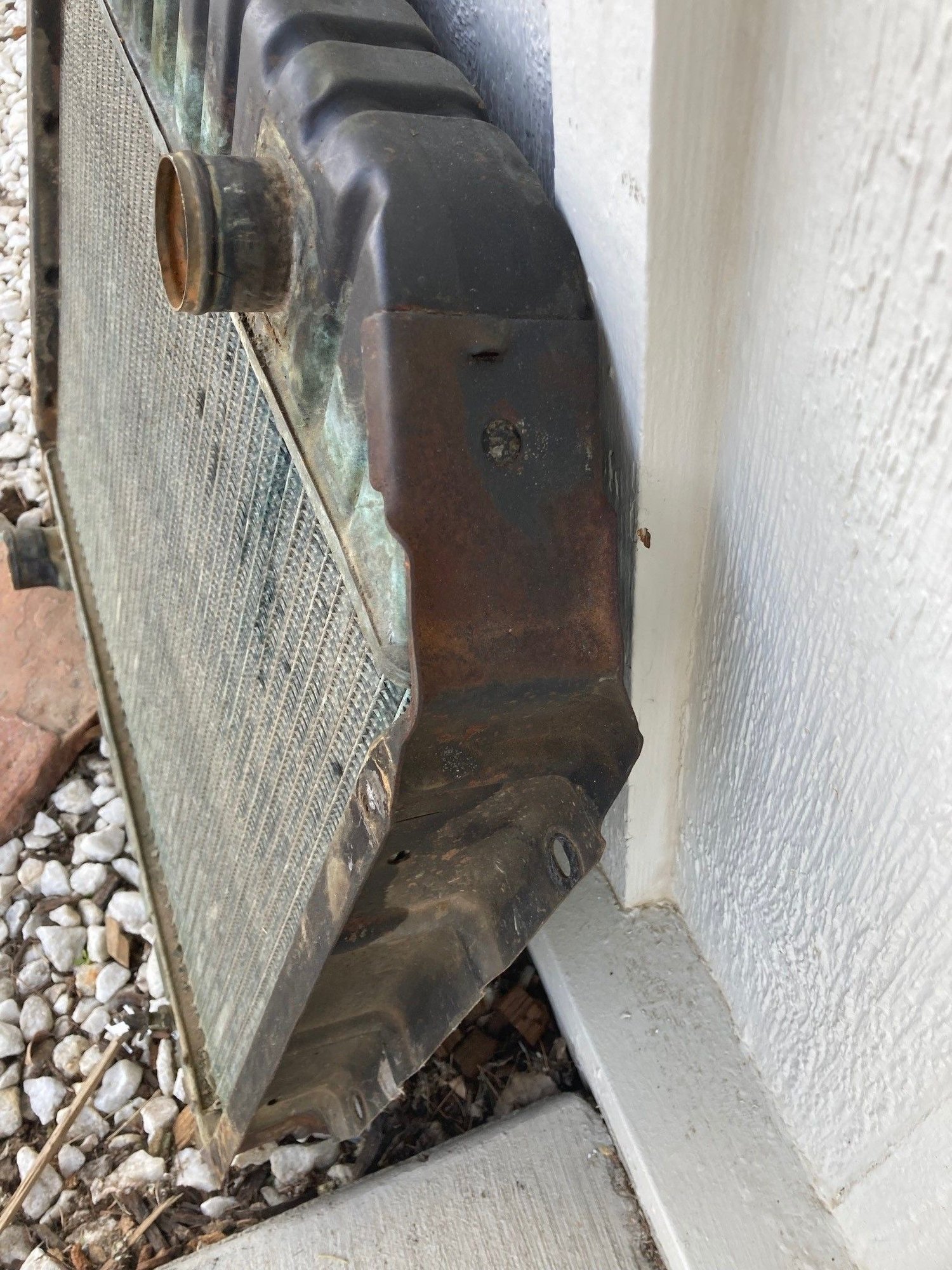

Thanks Paul. Below are 2 pics of the radiator, it has the metal casing attached to the side / top of it which then attaches to the truck. The metal casing seems as if it is rusted or welded on, or something along those lines . It does not come off. The measurements of the core are 24x18 . If including the metal casing, its 26.5x18. Any thoughts ?

Thanks. Sorry for the delay but I could not access the site from my phone for some reason.
From here at least, and without any knowledge of additional variations over and above the two (actually four) that I know of (two different sizes, two different mounting methods, totaling four), that looks very much like a stock standard size radiator. There was the "super cooling" version with a visibly larger top tank, but yours would be the standard size.
Sounds about right dimensionally too, with the size you measured.
Maybe the hose you got was for the larger optional radiator? I don't know that they have different size inlet ports, but it's very possible.
Did they give you two choices when you bought the hose? If you get a chance to get on rockauto.com you can drill down in their menus for your truck and they will give you the options including multiple part numbers from different manufacturers. Often the original part number/engineering number from Ford as well.
You can look at the various numbers and compare them to yours to see if your hose is for the other radiator.
paul
