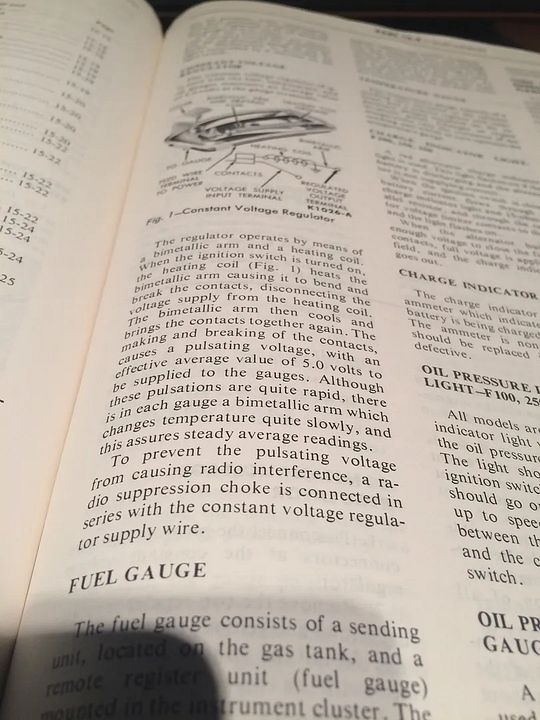

Yes, if I understand where you are testing, the "Constant Voltage Regulator" takes the 12V system and reduces it down to an average voltage of roughly 5V. It uses a bi-metal spring inside that constantly goes through heat/cool cycles which "makes" and then "breaks" the circuit causing your test probe to flash.

They do make solid state CVRs these days that give the gauges a true constant voltage. Here's a little blurb in the shop manual about how the original ones operate.
