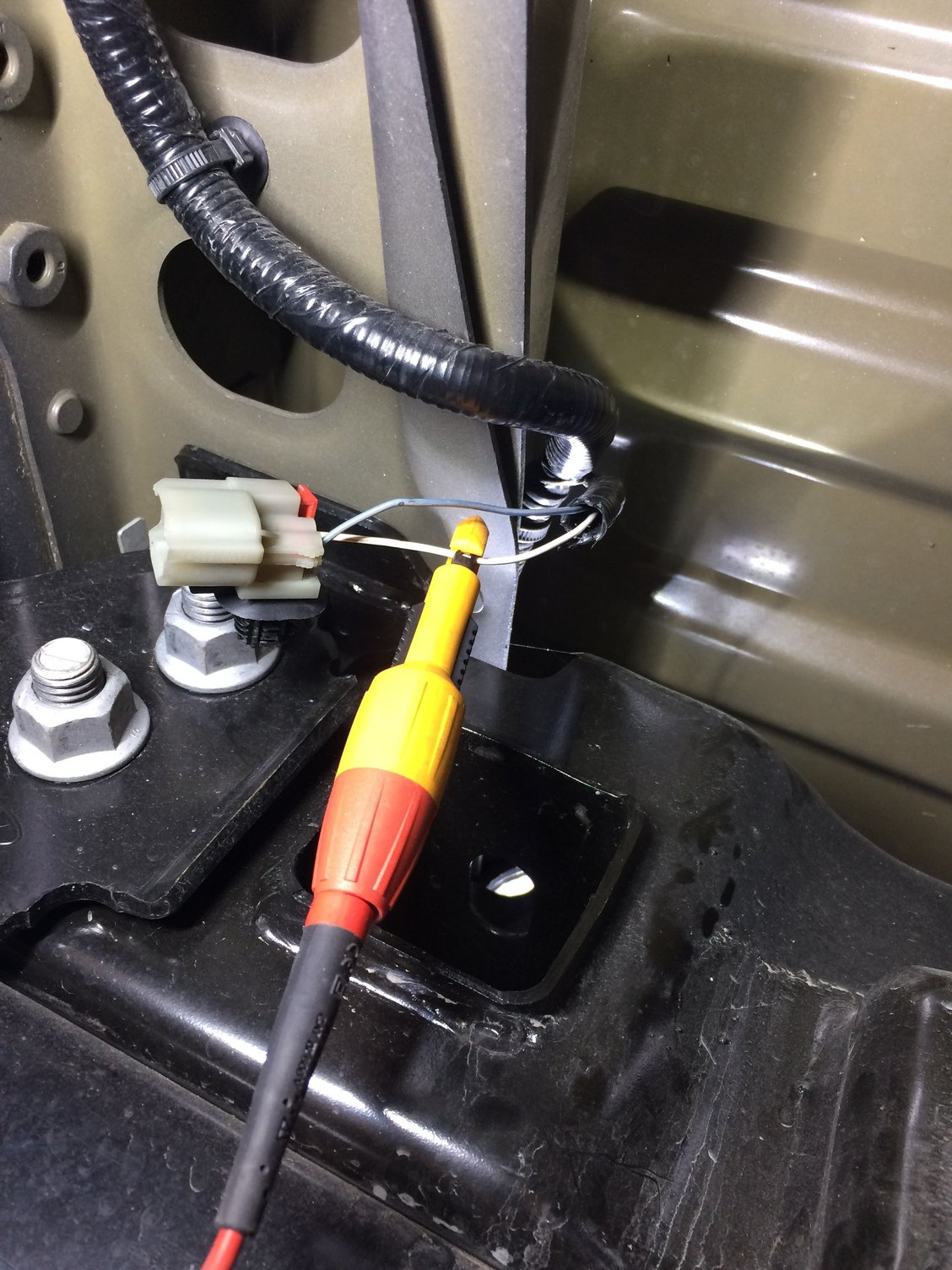

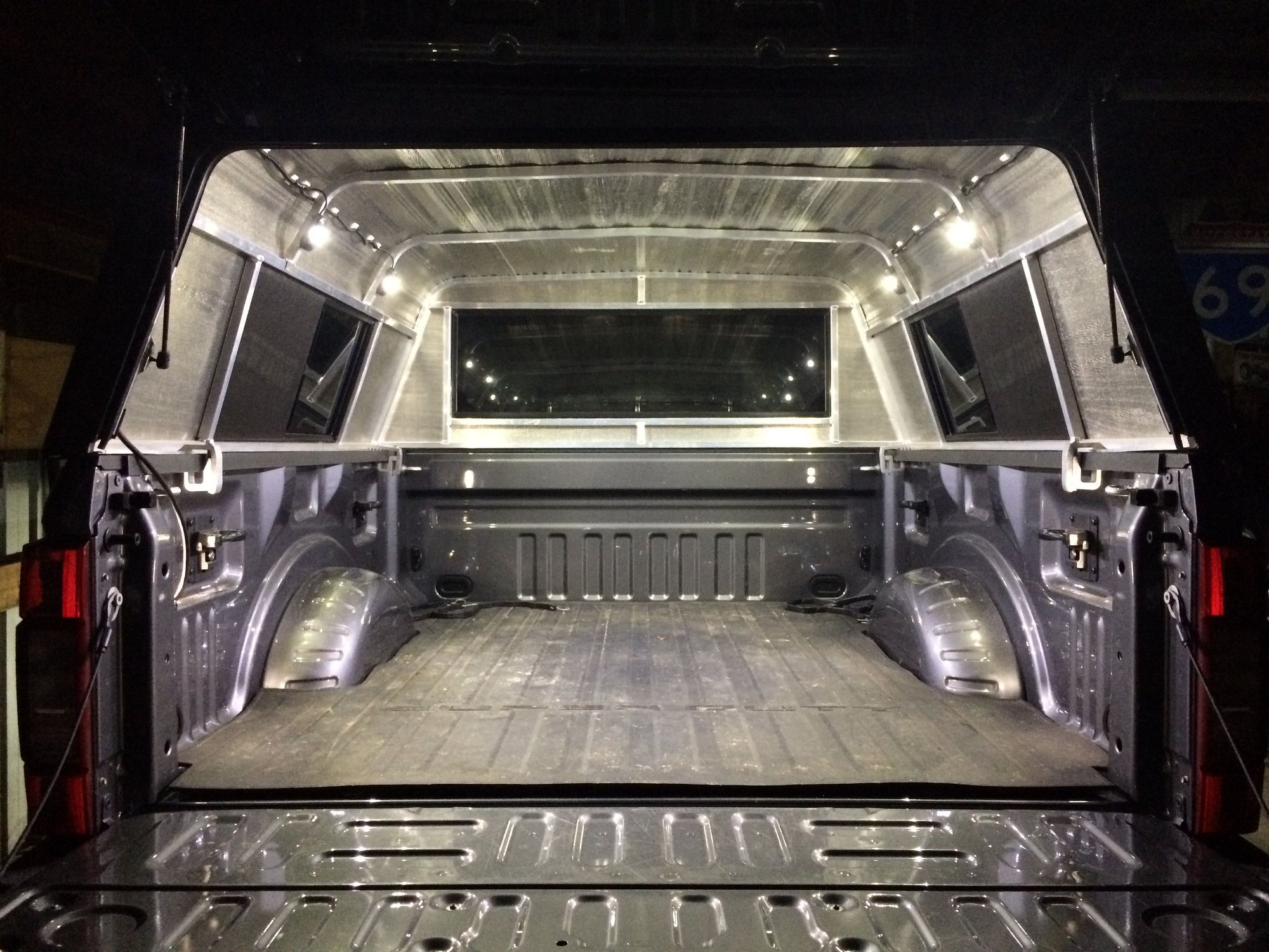

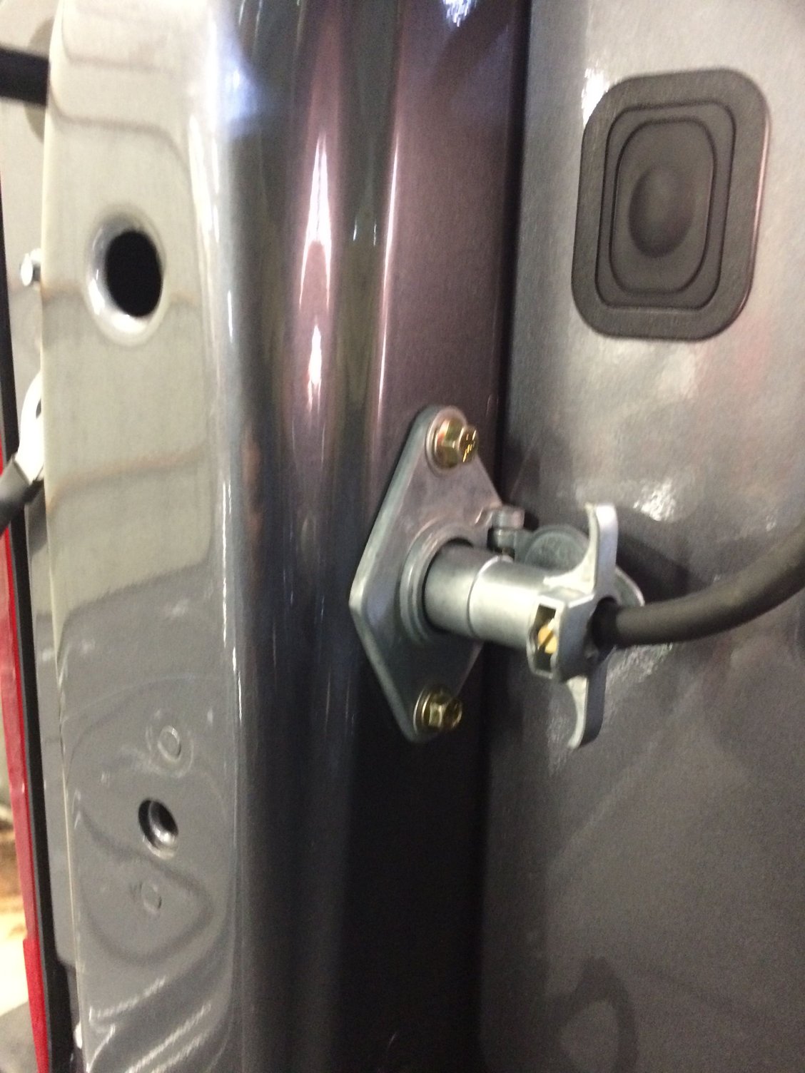

I added LED rock pod lights to my camper shell. I spliced the new lights to the oem bed lights from underneath the truck on the drivers side where the oem bed light harness is. Power is from the white wire (shown with yellow probe for voltage meter), then I used a common ground back to the frame. No issues working with the bed lights or the switch, comes on with bed button, goes off after 10 minutes. I ran my high mount stop light and cap lights to a 4 pole plug so I can easily remove and install cap as needed. Philip.
