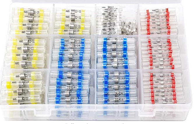

I believe the fellas are referring to soldering sleeves as seen below.
When I use something like this, I put at least one layer of shrink wrap over it too. Depending on the area and if like the IPR, I would put 2 with the second slightly longer and overlapping the first. That is just me though.

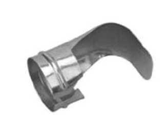

I found through experience and a friend that having a deflector similar to the one pictured below helps quite a bit.

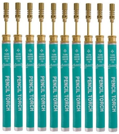

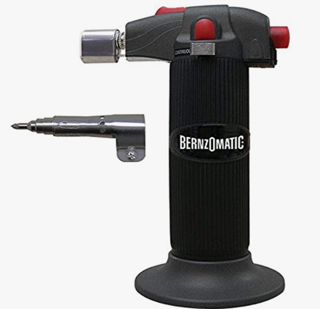

You could use a small butane "torch" as well. They are cheap and can be bought at places like Wal-mart or parts stores. Not the 1' or so bottles with a neck on them, the small pencil sized ones like seen below. Also, the palm style with a trigger seem to work fairly well too. I have both, but never used the small pencil ones, not yet anyway.
