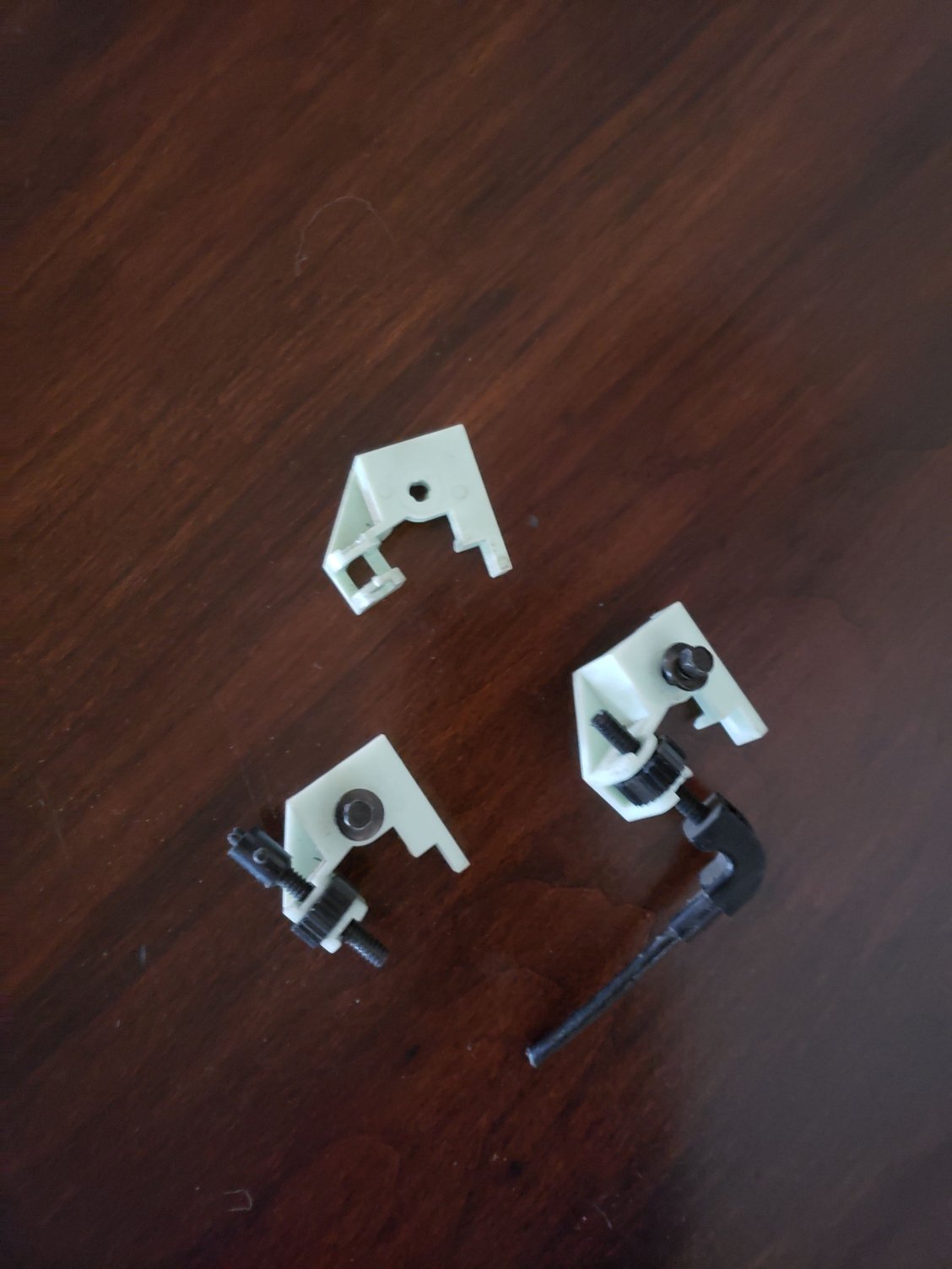

Not available from ford separate from the expensive prndl indicator
Yours is the more common one at least
Pretty easy to change
Remove the 7/32 screw and pull the cable down enough to rotate the thumbwheel and remove the broken plastic piece
The cable easily slides back thru the threaded portion once you get the replacement bracket piece back in place
The junkyard or my toolbox is the best place to find a good one
If I look and have several I could be talked into sending you one

All I have is 3 or the older style harder to find ones
Junkyard or I do like the 3d printer approach
Been going to weld one up from sheet metal myself
I work on many fords and replace these on a regular basis
When I go to the junkyard. I get them all or at least 5 or 6 to keep me in them
Looks like I need to go back

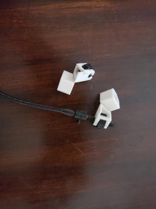

Old Mar 31, 2022 | 03:01 PM

From: Skopje, Macedonia
Ohooo you have a lot
I Will need more instructions about replacing, video will be perfect if there is one.

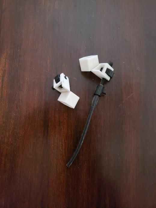

Old Apr 13, 2022 | 08:16 PM

Found you some
