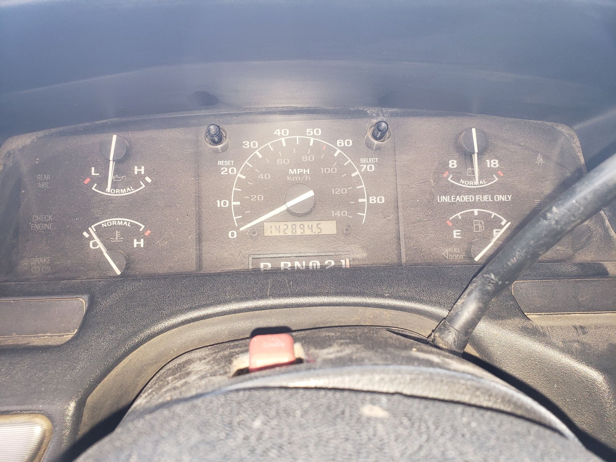

I just today took my ol' girl into town for a drive and to wash her off. Left her running the entire time I washed. Maybe close to 10 minutes she had been running. Temp did not go into the NORMAL range. Stayed just above the C. Could this be a faulty coolant temp sensor? How would I check to see what this could be? Too much coolant perhaps? The guy I bought it from said he had replaced the radiator and put fresh coolant in it, but I am not sure if it is straight coolant or what. I will have to get one of those plastic coolant testers to find out what % the coolant is at.

Pull the wire off of the sender and ground it with the key ON. If the gauge goes full HOT then your gauge and wiring are fine and it's either the sender or the thermostat has stuck open.
