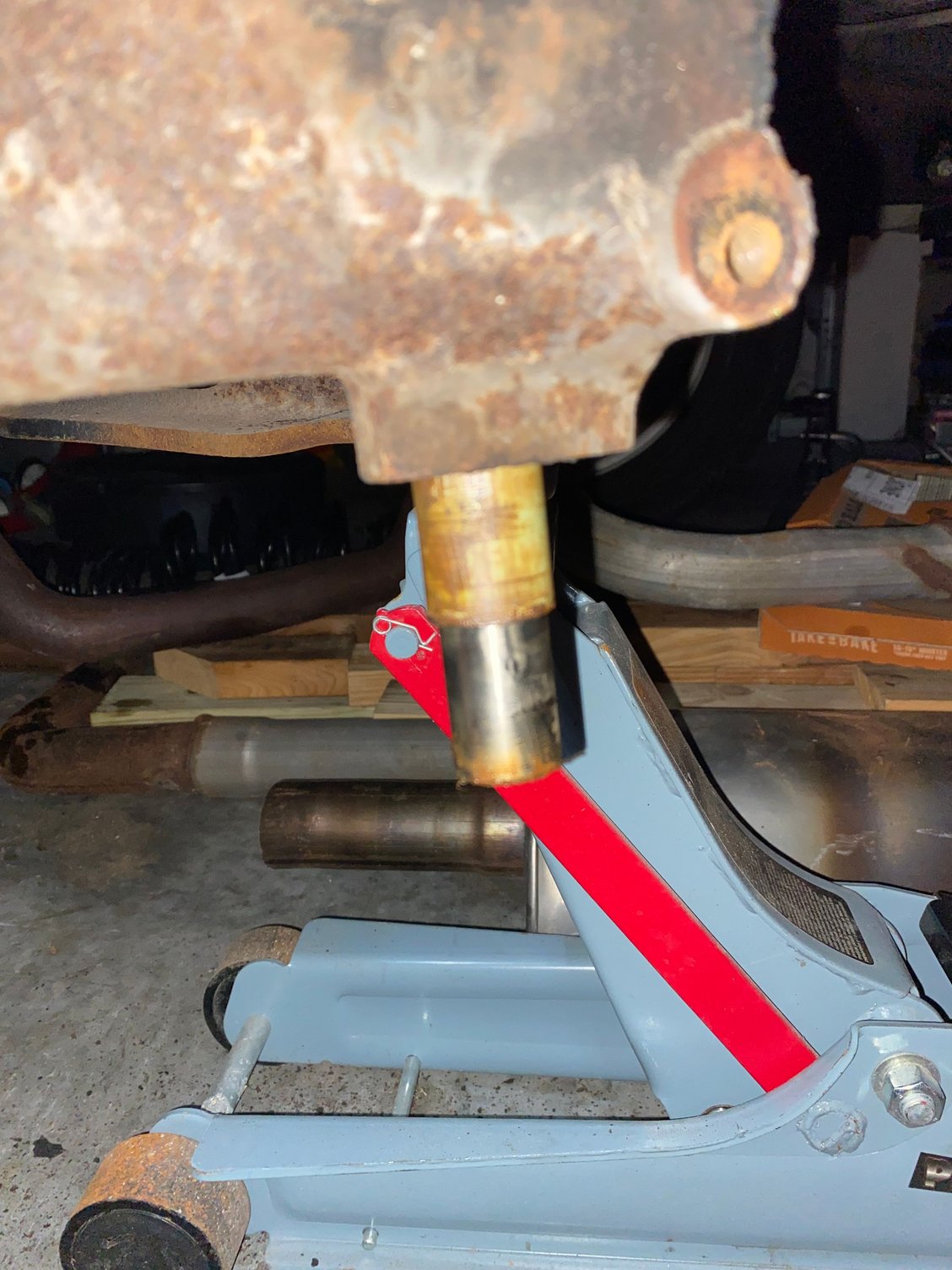

Update.
with the tire off the ground, the top has play inward and outward. The front of the tire has zero play in any direction. The truck is not lowered, I have 20” dodge wheels on it. That’s what fills the wheel well and gives the appearance of it being lowered.
This evening I took it all apart … it has the dreaded nylon bushing instead of a metal bushing. No wonder is failed 🙄. When I moved the brake caliper I noticed the brake lines are bad. The list never stops growing! While it’s apart I’m gonna clean up everything and paint it to help prevent further rust. It’s not bad at the moment, all surface rust, but every little bit helps. Below are some pictures from tonight’s adventure.
