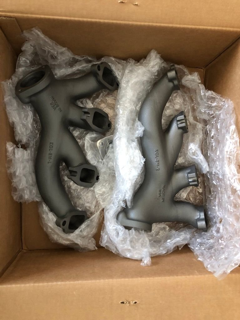

Got my Kugel headers yesterday. They look great!
I'll post an update and pics as they go on.

Kugal 406 manifolds on my 393. Very minimal notch needed Fantastic items.

They DO look very nice,
That is great to know! I have a set of the original Ford manifolds but I've never had a chance to see if they will fit on a 2 WD. I don't mind making a minor trim, but didn't want to butcher the frame.
