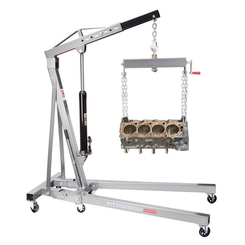

Way I and my buddies always did it it, but without the transmission attached. I just haven't done it on a 4x4 pickup yet, just cars. Taking the hood off would prevent accidently damaging it with hoist boom where as on those cars, one knew up front that the hood had to come off.
I am imagining that picture with no transmission and no heads, no intake, no filter, no manifolds ... and a shorter link between the hook and lifter valley region. I likely would still pull the hood first after the recent paint costs I'm gonna incur.

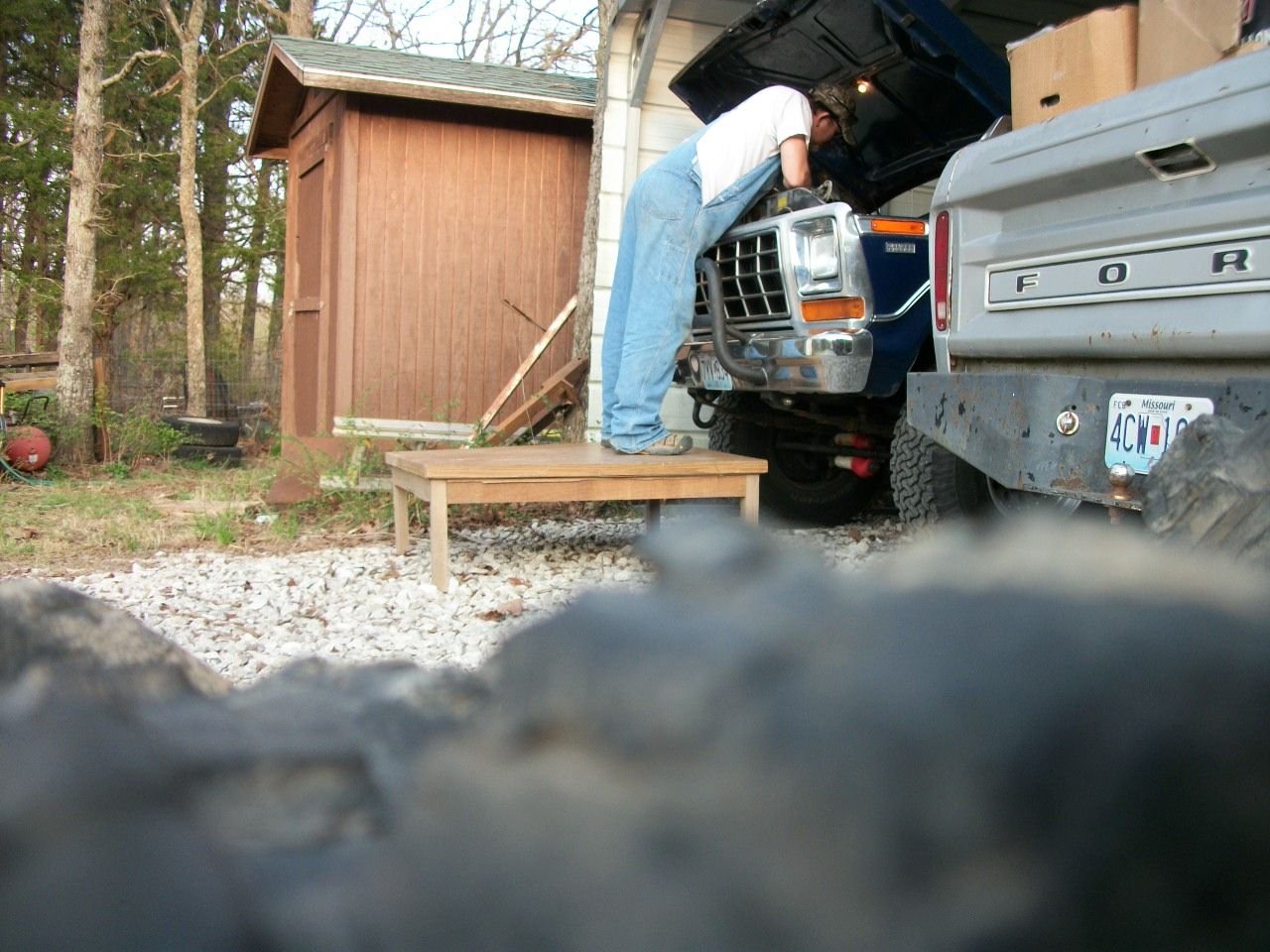

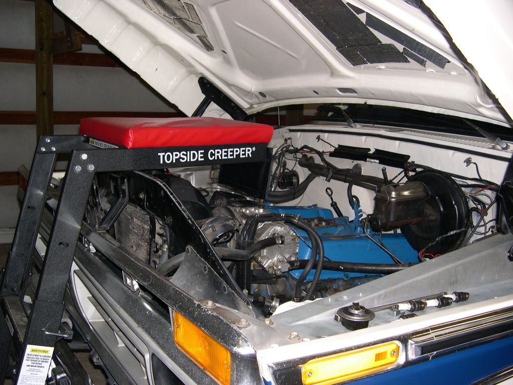

If you have a leveler and if you leave the trans in the truck, it is not bad with the front clip on. Here are some other nice things to have handy.
4wd 4" lift and 35's. I normally use a old saddle pad to lay over the core support. But I was not doing any heavy wrenching that day. Old living room coffer table from the thrift store. And or pallets are free....
Cut and screw together, and you can ever custom stack to the best height for you.

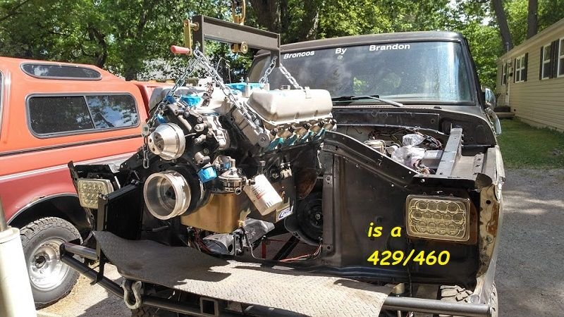

You guys are funny. This truck was junked after the engine and tranny were pulled. You make it sound like it was done to make it easier to pull and then put it back in.

So you are saying the eng and trans were already removed THEN someone cut the core support/grill shell and inserts? Looks like a JY worker move to get the radiator out FAST. I just though that the statement tbear said earlier matched the picture.

No, I'm saying it was chopped up to get the engine/tranny out quick and then the wrecker took the truck and it was crushed rather than the engine going back in and the truck driving off, which is what this thread's OP is wanting to do. I was the owner of this hacked up truck before it was crushed.
As for cutting the core support, I've seen someone (on FSB) do that to his 78 Bronco to ease removal and installation of his engine. Here's a link to his build thread and the first post that shows how me modified it. You'll notice a familiar picture below it as well. Everyone has their own way I guess.
https://www.fullsizebronco.com/threa...0#post-7298427
