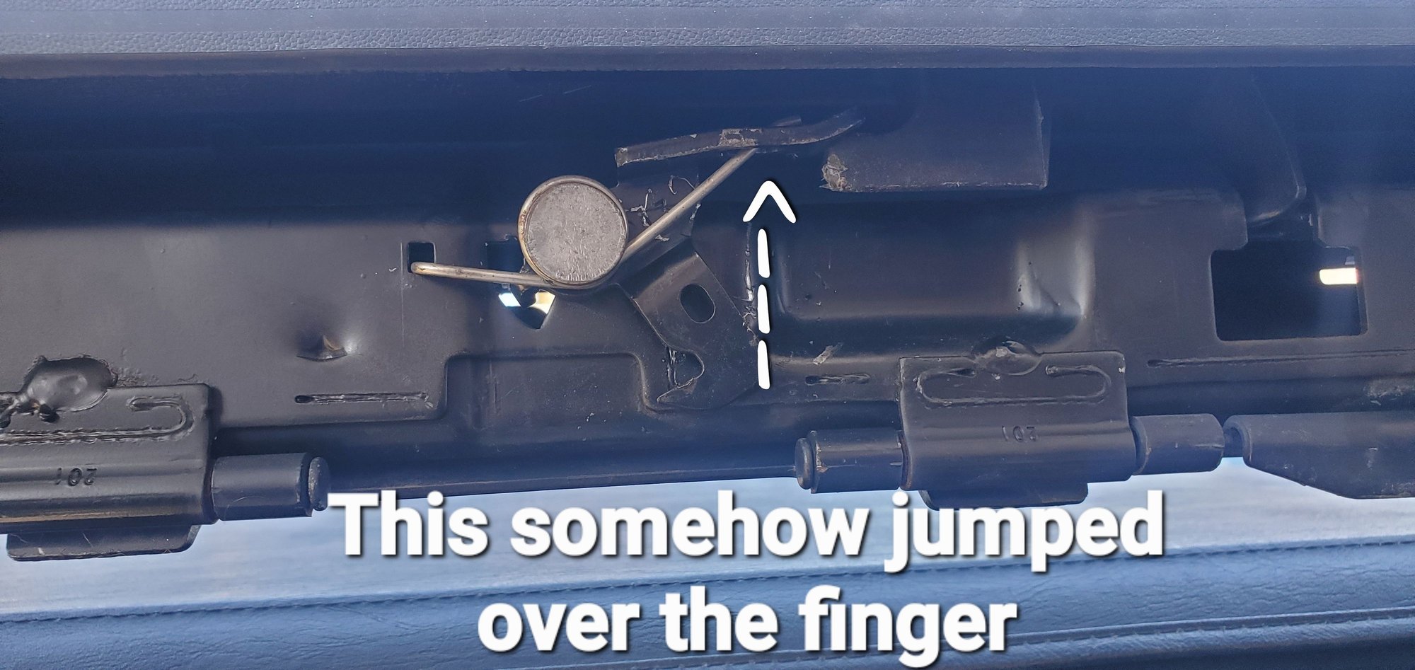

I found the issue last night. When you lift the cover it is supposed to lift and pivot the catch. Some how it jumped past and wasn't lifting it. A little bit of finesse to pop it back to where it should be. Adjusted it while I was at it and now it is smooth and easy to open. Should have taken a pic before I fixed it but forgot. Here is fixed pic.
