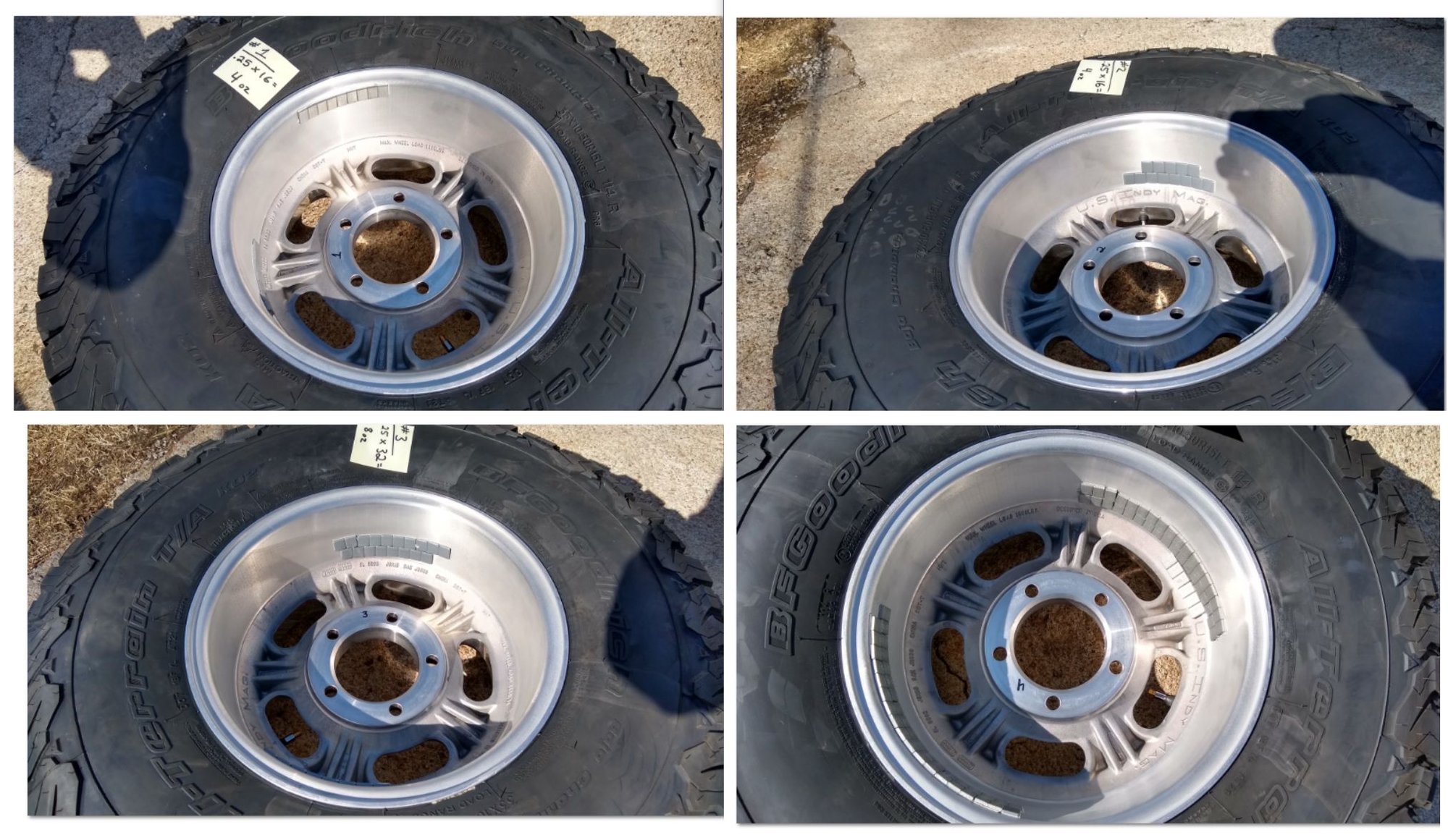

When they were done balancing the new wheel assemblies, this is how they balanced out:
Wheel #1- 16 Weights x .25oz = 4oz total
Wheel #2- 16 Weights x .25oz = 4oz total.
Wheel #3- 32 Weights x .25oz = 8oz total.
Wheel #4- 79 Weights x .25oz = 19.75oz total.
There's 16 weights on Tire #1 & 2. That seems a bit excessive.... But I would think that's OK seeing how big and heavy (50.7 lbs.) the tires are......(probably ok?)
Wheel #3 has 32 weights, that seems unacceptable.
Wheel #4 had 79 weights and I think that is completely- and totally unacceptable.
The rims are precision CNC machined, I would not believe they caused this.
There's so many weights on the back of the rims it seems almost cartoonish.... I just never seen anything like that before, how can they even all stay stuck on?

First off you don't weight 180 degrees apart that's the biggest problem all you're doing is countering the weight you just applied with more weights. you need to get someone who knows what they're doing this must have been the new guy's first day.

They just "dynamic-balanced" them heavy tires. Heavy tires take weight that light weight tires seldom need. You can set some machines to place the weights behind the spokes for the front or face side, and either lip or offset in the wheel edge for the back side of the combo. I do the same thing when I balance with stick on weights on wheels that I don't want ... or can't use clip on weights on the face. Sometimes I use a supplement load of Airsoft hard plastic .22 cal BBs. I have used the BBs alone on smaller tires.
"Static balancing" ... aka: "bubble balancing" ... is an alternative I no longer use.
Only weights I see 180 degrees apart up there are some placed opposite each other on inside versus outside. If a tire has a heavy spot in a sidewall, speed will make it want to rotate with a wobble, this is how you balance it out.

Balancing on both sides is optional. in a perfect world it's nice but tires like this it's hard to do unless you use the old clip on weights which I do sometimes.
Balancing 180, or 170 degrees apart is useless. if you need 4 oz to balance don't put 8 oz 180 degrees from it then make it 12oz to balance it out.
I've had dozens of sets of this type of tire including mostly BFG's and it's not uncommon at all to need a bit of weight on them. but nothing that approaches this .
that said, if they run out smooth who cares the weight isn't going to hurt anything.

That would be true if they were placed in the same rotational plane ... but they aren't in those pics, they are in different rotational planes, doubtlessly to cure a wobble the machine detected.

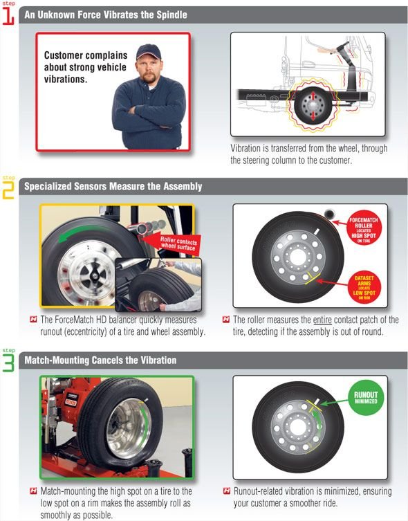

When a wheel is made, whether cnc machined, cast, welded up, whatever, it is going to have a heavy & light side, not be in perfect balance. Let's say the valve stem hole is drilled on the heavy side.
When a tire is made, it is going to have a heavy & light side, not be in perfect balance. Let's say the factory puts a small yellow colored dot on the sidewall on the light side.
When the tire is mounted, you line the dot on the sidewall up with the valve stem hole or within 20 degrees to either side of it. This helps to cancel out the imbalance between the wheel & tire, requiring less weight to get a good balance.
No tire jockey at a shop knows this, or does this. I've come across one guy that has been working in a tire shop for 40 years that mounts tires like this, a guy that is the best mechanic I have ever seen that mounts tires like this, & one other guy. No one else does this. This way of mounting tires is old school, I had a service manual from a 1920's Ford that detailed this way to mount tires.
Look at new cars or trucks on the lot, look for the dots on the sidewalls. Most of the time the yellow dots will be close to the valve stem, sometimes not. Think about it: get the wheel tire combo close to balanced by matching them, it will take less time, less money for weights to balance the combo. Time is money on the assembly line, multiply 1 fewer wheel weight by millions of tire wheel combos per year. You can see why the factory would want to do this.
If you get the heavy side of the tire on the heavy side of the wheel, you can get the need for lots of weights to balance the tire wheel assembly. Throw the tire wheel combo together at random, & you might get lucky & not need much weight.
I can't see any dots on the front picture of the tire you posted, look close, they may be there. Check 'em all, see if you can find any.

If they were any good they would've rotated the tires on the rims to get as close to balanced as possible before adding weights. That's one of the things done with road force balancing

I think i see a red dot on the first picture of tire#2, at about the 4 o'clock position. It might just be a random mark from editing?
