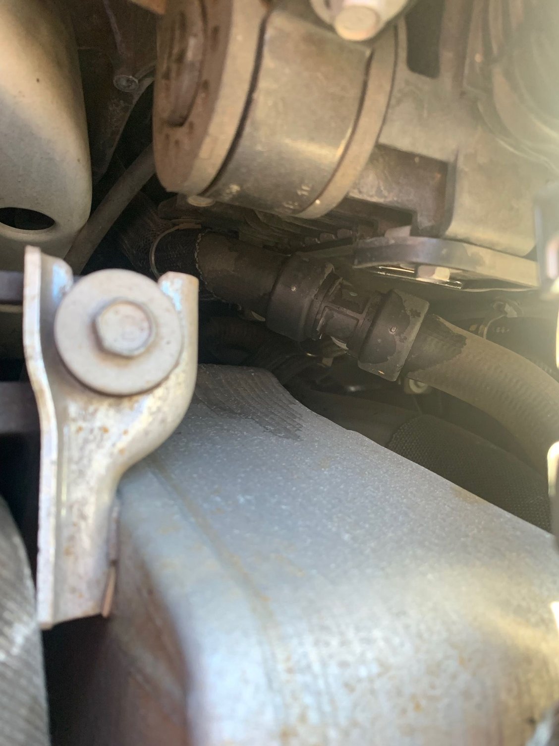

It's been chilly here in Tucson the last week or so, but not freezing weather cold. It doesn't happen every morning, but twice this week I've had coolant on the driveway after starting the truck to let it warm up a bit. I haven't been using the block heater, because I didn't think it was cold enough, but what could be causing leaks that are intermittent? Thoughts?

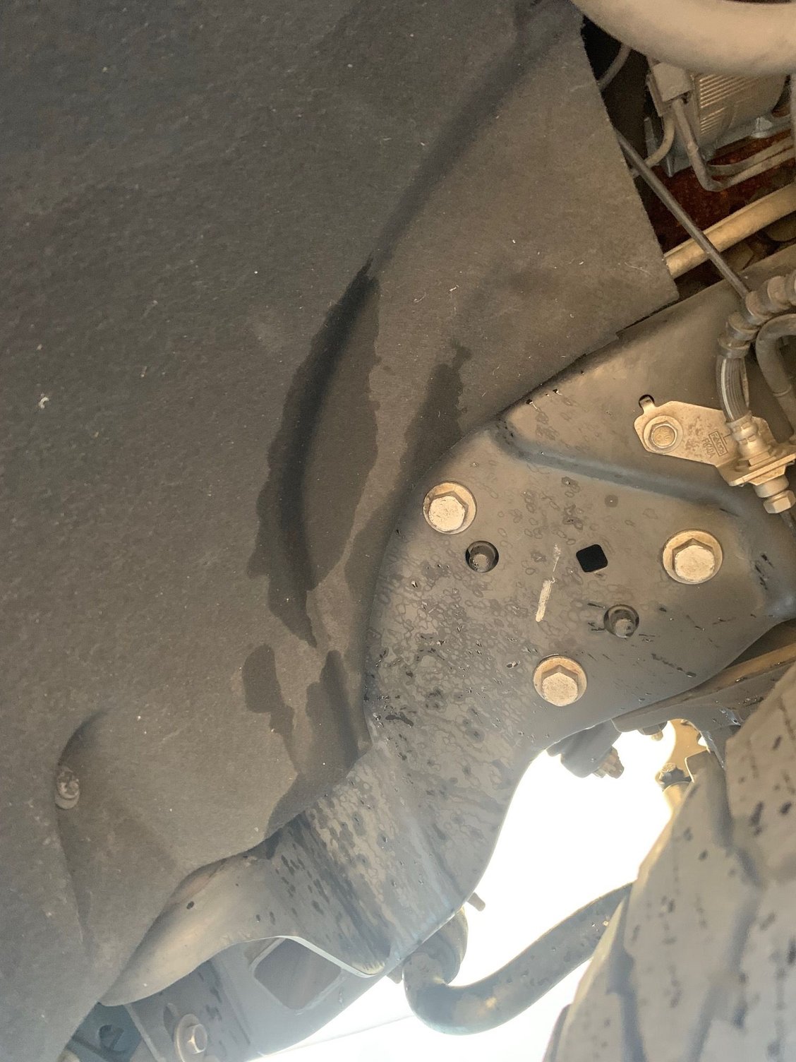

see that’s just it, this only happens when it’s “cold” (36-50 outside) and before reaching operating temp. It seems to be coming from that plastic t-fitting in the 1st pic, and it’s under pressure when it begins to leak as evidenced in the 2nd pic and spots on the driveway (not pictured). Only happened twice in 2-weeks. I ran the truck pretty much all day today and other than the first start, it’s been leak free.

Check the upper radiator hose where it mates to the radiator. Within the plastic coupler there is an O-ring. They start to go bad before the rest of the hose and are replaceable. You may see coolant dripping out of it when the engine is up to temp. If not visible, give the hose a slight squeeze and see what happens.
Similarly, there is an identical size O-ring at the coolant crossover pipe where the thermostat hosing sits. This is a 90 degree coupler. Why Ford can't just use ole reliable hose and clamp, I don't know.

Sounds like it heats up and seals off, not likely a split then and probably like deveroutdoors is talking about. Don't squirt yourself in the eyes squeezing, you'll find it.

Connector Hose Upper Seal - Ford (BC3Z-8590-B)
Connector Hose Lower Seal - Ford (BC3Z-8590-C)

This was it! Perfect solution and came just in time. Thanks much!!

Glad to hear it. Just keep an eye on the fitting at the thermostat if you didn't replace that one. Probably best to replace these in pairs for $20 instead of a new hose for $150.
