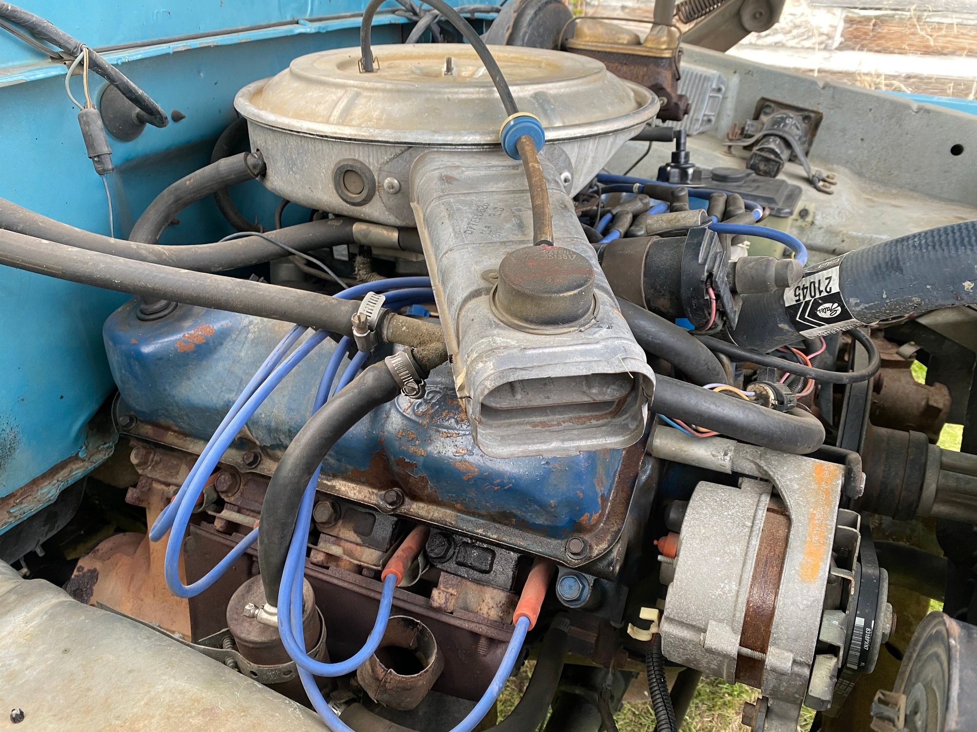

I have seen many frost plug engine block heaters, and they usually look something like this
While changing anti-freeze last weekend, l found this item piped into the heater hose.
My first guess was some kind of auxiliary "aqua-coil" ? Obviously, l needed a second guess.
Anyhow, thanks to 73explorer and redroad and sbilby123, and especial thanks to 5851a, who identified this as an external engine block heater.
...indirectly, because--more precisely--its an external engine coolant heater: like this...or something similar
Kat's External Tank Engine Heater Kit Thermostatically Controlled 1000 Watt 120V | eBay
l'm a bit confused as to how this works and how well it circulates the coolant, warms the block, etc.
Next l'll need to inspect it more closely for a part number, watt rating or any other identifying marks on the outer shell.
So l'm soliciting comments; anyone with any information, experience or other suggestions about this accessory, please feel free to add it here.
We really need all the help we can get up here in Northern BC. Especially since Cooter's canvas carport is not heated.
Thanks everyone, and bundle up! lt was -4*C this morning, and there's rain in the forecast.

They were usually around 1500 watts. they use coolant from bottom of block hose, the warm water rises and as it cools in goes down. If below 0 would be best plugged in all night. Make sure you have good heavy cord and clean terminals on plug ins. They did work back in the day.

When I was in college and had my 75 F100, I installed one of these in my lower radiator hose and it worked pretty good.
If yours doesn't end up working, this is a fairly easy install.

5851a: thank you sir, that's a lot of good information. Yup. we usually leave the regular block heaters plugged in overnight when temps are forecast below zero.
John89: yup l saw that style when l was googling this one. l also found a magnetic block heater but the one that intrigued me most was the dipstick style oil heater.
Helping a friend excavate a cattle tank this week so l'll try to get a closer look at mine this weekend. Finding this block heater is actually a pleasant surprise.

As long as the electrical plug part is still there and the cylinder piece itself is in good working order and not plugged up.

Rich: Yup, the cord is routed next to the battery ground cable with the plug neatly folded behind the grill.
The style up here in 'the bush' is to leave the plug dangling outside your grill...all year. People are funny, eh?
The truck runs cool per dash gauge, rad flush & fill last week (60/40 mix yields -52* protection)
Flushed 3X with lake water after the 10 minute chemical flush, so hopefully we're good to go.
Certainly both radiator hoses should be warm to the touch after being plugged-in for a few hours ?
Unsure if the cylinder piece can be disassembled to inspect or service. l'll have a closer look soon.

Years ago I worked for a large utility company near Toronto. They used that type of block heater on a lot of their trucks. They seemed to work quite well. I do believe I still have one buried in my spare parts.
