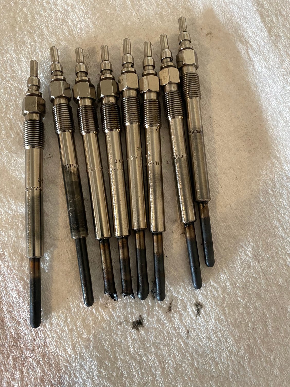

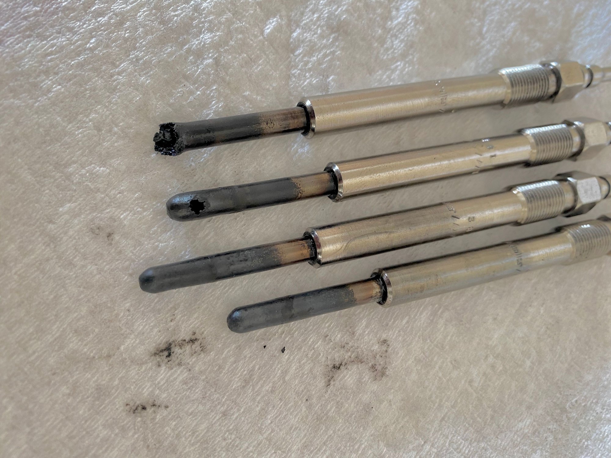

Here’s the Autolites that were in my truck when I bought it… wonder where the missing tips went—groan. Two of them had me worried. They did NOT want to come out and my anxiety went through the roof. Not trying to scare you if it starts fine right now you’re probably not going to deal with that.
I’d do what was posted above and pull one out and give it a close inspection. Hopefully you got lucky and he used genuine Motorcraft plugs. Best of luck,

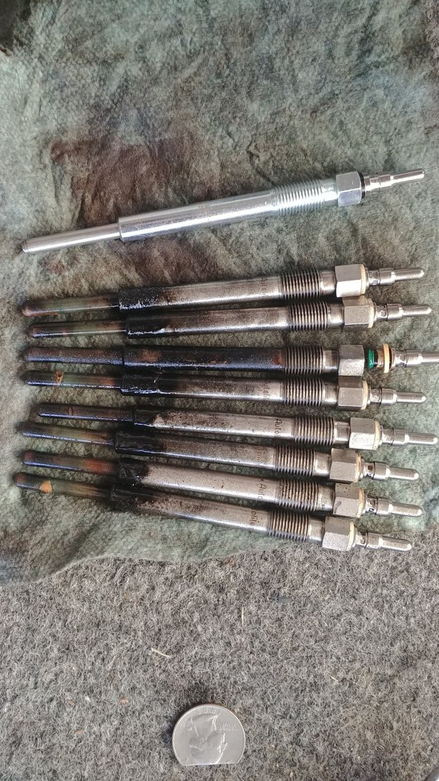

Dang....I must have gotten lucky....here are the 8 I pulled out when I bought my truck. One was coming apart at the top.....but they look nasty compared to the Motorcraft ZD-11 on the top.
