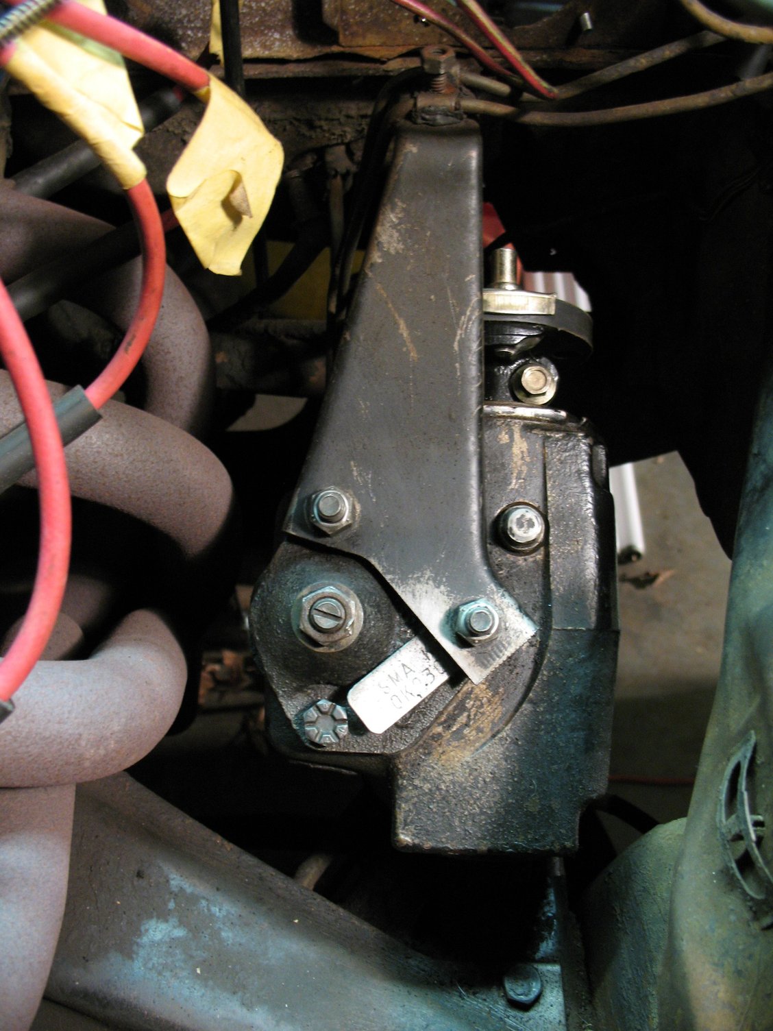

Question STEERING BOX
Which screw do I remove to fill grease ? I believe it is the very bottom on the left, screw with the groves cut into it.......It is on there TIGHT
May have 2 use an impact, will it round the head ????????
I take off the vent screw & fill grease in bottom hole?????????? DOES STEERING BOX LOOK NEW OR REBUILT ? I DID CLEAN IT .........IT LOOKS FAIRLY NEW TO ME.
I DO HOPE IT IS FAIRLY NEW !!!!!!! P/O DID REPLACE SOME NEW PARTS KOOL.......DADDY O'

The bolt you reference is one of the bolts that mount the top cover. To fill the grease use the one on the far right.

If I remember right, the service manual calls for turning the wheels one way to the stop, pulling the lower bolt to fill, then turning the wheels the opposite way to stop and filling through the upper bolt hole. This moves the slider block full range, allowing for a complete fill.

All 3 of you guys are right some & have helped. I did not notice about the cover, and not certain about the lower bolt because I saw this done for a Falcon not a truck. I remember you do as Philthytoo says except u use the same hole to fill & steer truck to max both ways each time filling to comes out hole........I guess U could use different holes......... ....... "and she said".............ha...
