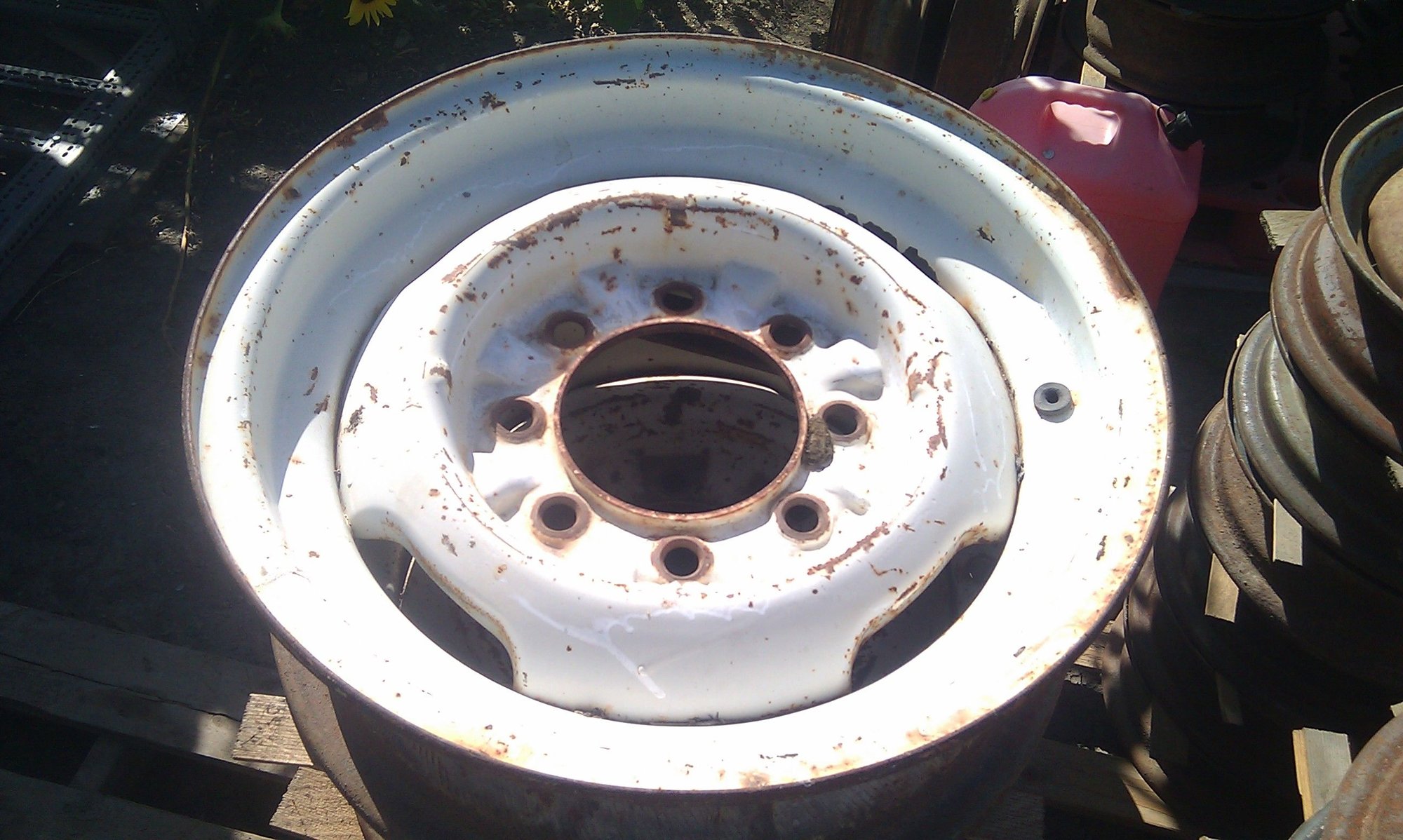

Stu, thanks. You've helped me with my wheels before, including putting me in touch with with a contact and I'm very thankful to you. I must admit (readily) that I don't know how to identify my rims, their brand, etc. I am attaching a photo in the hope that someone can identify them. (I was pointing to the split ring for another purpose, so please ignore the green arrow in the photo.)

Those are fine to use. Split rings, but I don’t recognize them as whether Firestone or Goodyear. The manufacturer should have its name stamped inside on the base rim I’d think. Stu

Appears to be an early 70's lock ring bump wheel. If your into originality and want a solid wheel, look out for this 16" innie wheel, used of Ford and Dodge 3/4 tons mid 50's to mid 60's.
