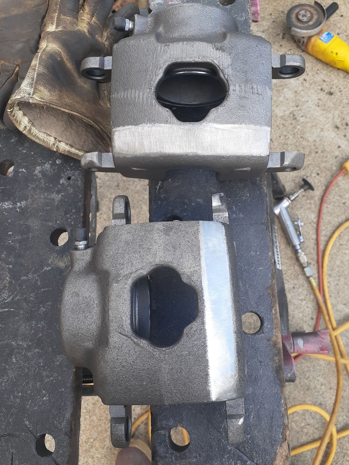

Nice 6C day so back in the garage. I shaved some material off the calipers to clearance from the wheels.
I used the 15" wheels so that I can have the option of running either them or the 16" wheels I have. One more little piece done. I should have my 3rd member in a couple weeks, so I will soon have a rolling chassis again.

Annoying caliper interferences

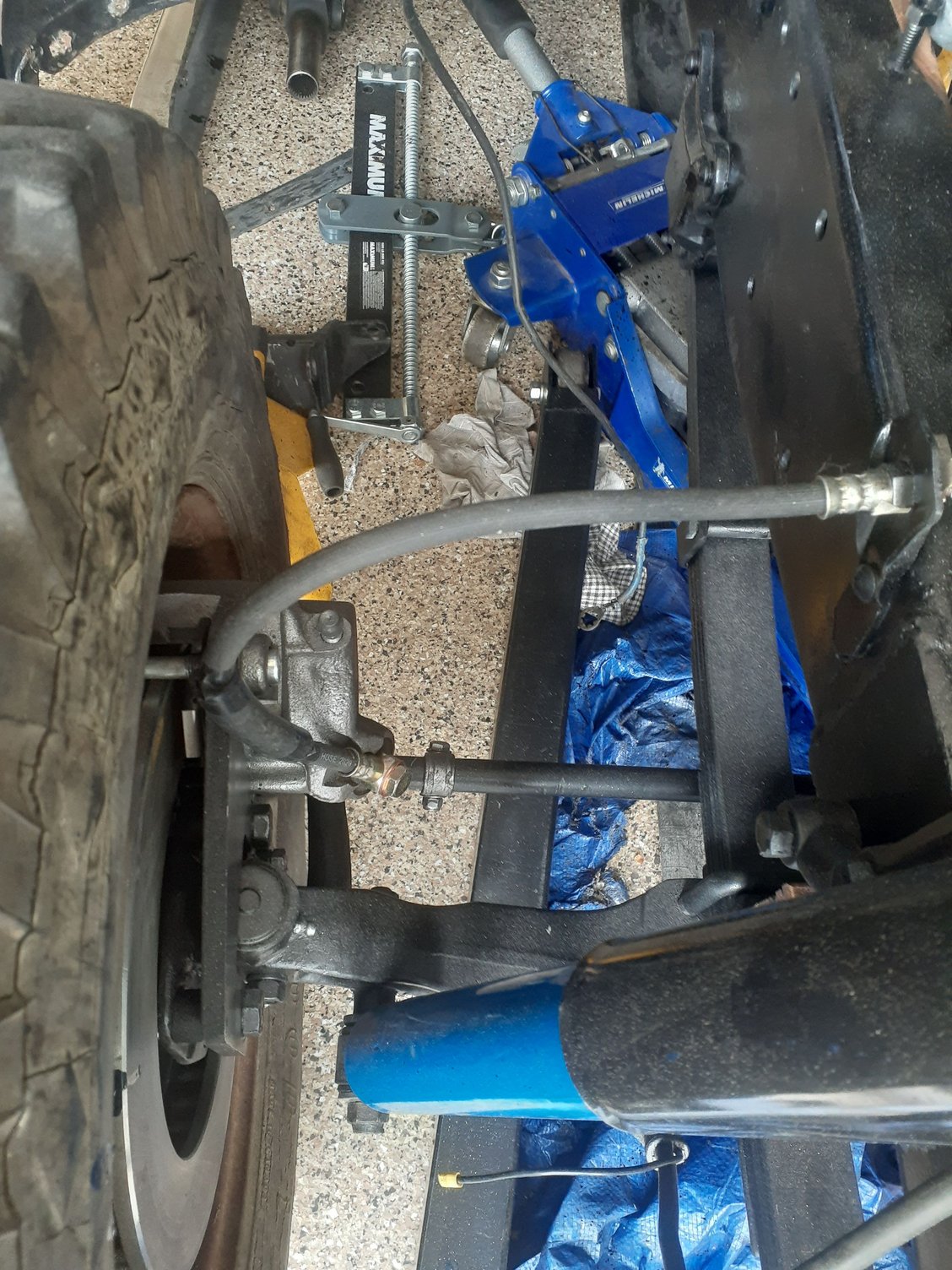

Yesterday I mounted the front wheels for mock up and they were still rubbing on the calipers. I decided to use the rims I prepped last fall to get a better look at where the interferences were. Guess what, no rubbing, lots of clearance.I will use the other wheels for the rear. Forward progress. Brake pads with the kit don't quite cut it, the stationary pad hardware does not stay seated on the calipers. I have ordered some from a jobber. If I were doing this again I think I would buy the mounting kit and out source the other components.

I have the 5 x 5 1,/2 kit and used the stock mounting tabs. I have not drivem the truck yet but my answer at this point is yes to both questions.

I ran the wheels through the turn radius and no interference but I will check it all again under load, once I get motor and trans back in.
