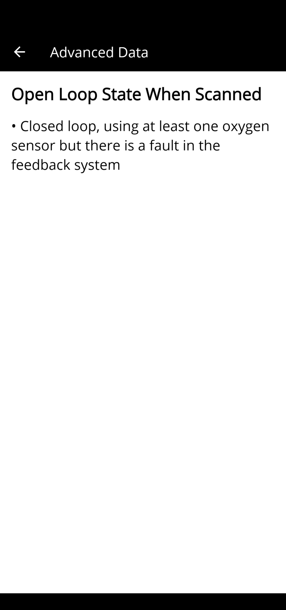

I noticed its not giving me any LTFTs anymore and when I scan for codes it says "possible problems" and gives this in the advanced data. It's also idling between 800-900 rpms.

It has to enter closed loop before it looks at the O2 sensors for feedback. Otherwise, it just runs off pre-programmed tables.
