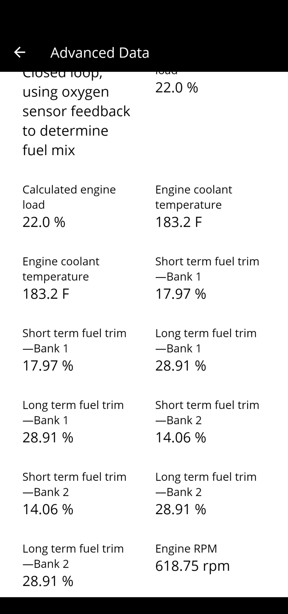

I just got the truck back and this is the freeze frame data from it.

I unplugged the battery and let it sit for half an hour then went for a short drive. Now I'm getting p1131 and p1151. I also noticed that it has O2 sensor spacers on the upper O2 sensors. Would this contribute to the codes I'm having?
it's idling better after the MAF was replaced.
