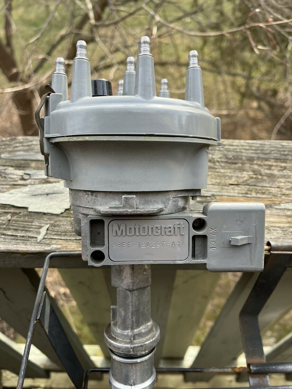

If you have EECIV, then you do have a TFI module. It's the rectangle piece mounted on the side of the distributor. It is what generates the signal to the coil for spark. They are known to go bad from heat.

The new coil itself is likely fine. Did you test the primary side? I don't have the specs, but am thinking it's a few ohms at most.
If the primary and secondary circuits within the coil test okay, most likely the coil is not getting the signal to fire. As the others have already mentioned, if this is a TFI distributor (rectangular module sticking out), that module is highly prone to failure. Normally I don't like to shotgun parts, but the TFI module has such a high failure rate, I'm willing to gamble your hard-earned money. And if it the module hasn't failed now, it will at some point, so you'll thank me later for having a spare. A simple public thank you would be sufficient, unless you wanted to hire a skywriter or do a Superbowl commercial, or something like that.
Here's what a TFI distributor looks like, with an image shamelessly stolen from eBay:

How do I go about testing/troubleshooting the TFI module to see if that's the culprit?
Old Feb 16, 2022 | 01:41 PM
jacob_PNW's Avatar
jacob_PNW
Joined: Feb 2022
Posts: 5
Originally Posted by kr98664
You totally lost me here. Once again, please define "getting power". Are you measuring battery voltage with a voltmeter? Or looking for the presence of a spark with the spark tester?
I just checked with a 12v test light. It lights up when key is 'On' position. Both the main post on the coil and the spark plug wire that runs to the distributor were getting some level of electrical power. I see now that this isn't the proper way of testing as you have already pointed out.
Here is your public thank you! THANK YOU! I also liked all your posts on this thread (: Your help is very much appreciated.
Ok, I will go ahead and order a TFI module. Just to be clear and make sure I am on the same page, I am looking for something like this? Which is also called an Ignition Control Module?
https://www.oreillyauto.com/detail/c...rd-f-150?pos=3
Old Feb 16, 2022 | 02:34 PM
Franklin2's Avatar
Franklin2
Joined: Jan 2001
Posts: 56,846
Likes: 2,681
From: Virginia
I can't get your link to work. I went to Oreilly's and plugged in your truck, f150 351w 2bbl carb and it came up with the duraspark module and the TFI module. Here is the TFI module. Let's see if my link works.
Make sure you use lots of the special grease that comes with the module. That helps conduct the heat from the module into the dist base.
https://www.oreillyauto.com/detail/c...n+module&pos=5
Old Mar 28, 2022 | 03:51 PM
jacob_PNW's Avatar
jacob_PNW
Joined: Feb 2022
Posts: 5
Forgot to make an update. The TFI module was the culperate. Replaced that and the truck is running now. Thank you everyone for your helpful advice!
For anyone reading this in the future. Having the specialized tool to remove the bolts that hold the TFI module in is a good idea. I didn't realize and had to order it after the module arrived.
Cheers.
Old Mar 28, 2022 | 04:03 PM
yardbird's Avatar
yardbird
Joined: Dec 2003
Posts: 3,768
Likes: 855
From: Foothills of NC
Cheers.
If the module is held on by small nuts recessed into the module, then you can take a nut driver and use a grinder to make the wall of the socket thinner.
I made one like that I used to carry around when I owned a TFI eating Tempo.
Glad you found your problem.
