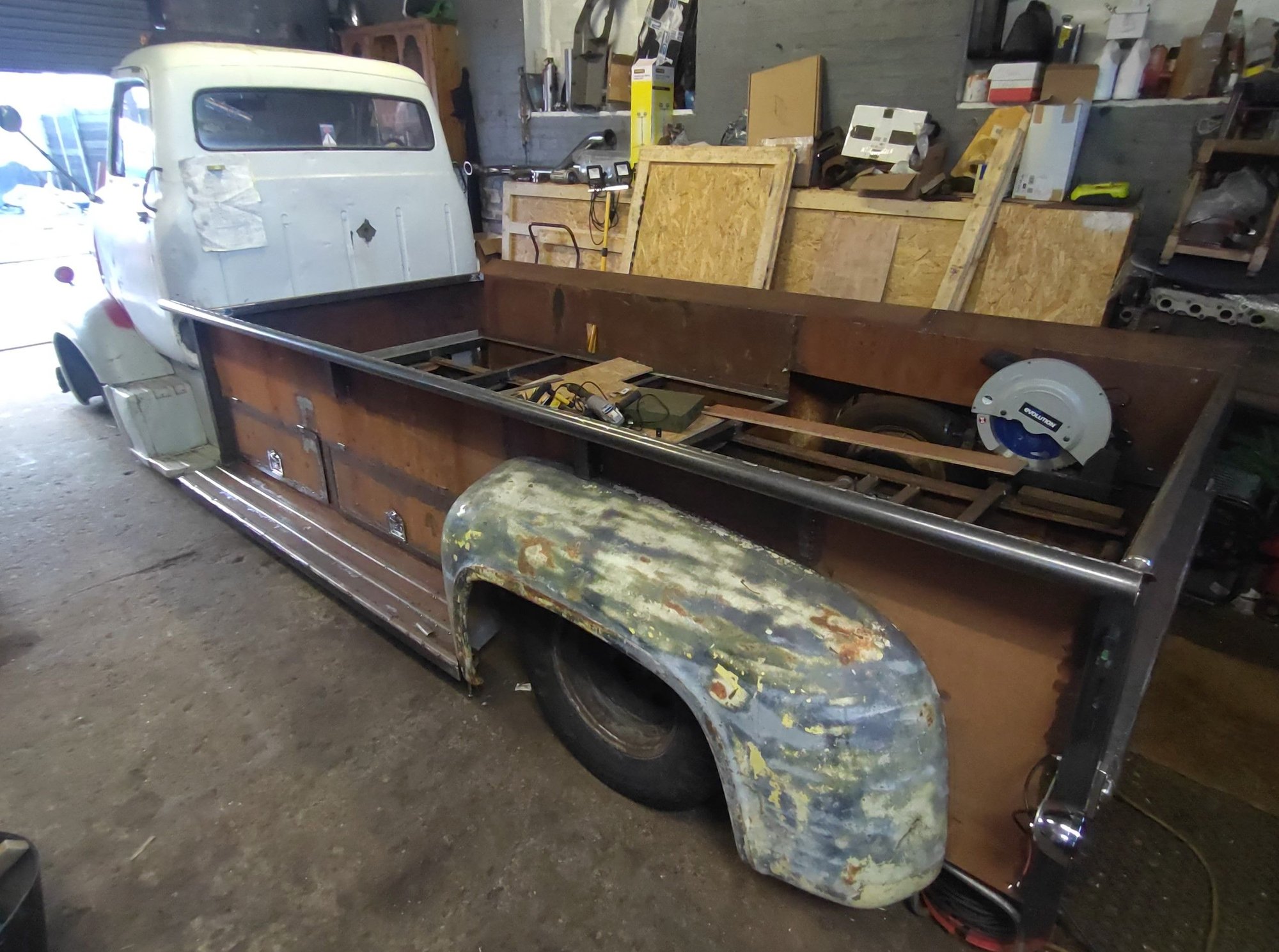

Very cool truck you have there Mark , I know what you mean about the proportions it took me a while to work out the bed size to build and I want to fit my hill climb car in there so had to move things around,

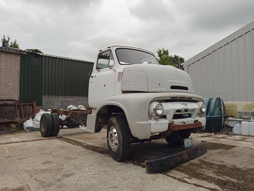

When it first arrived with 7.5 tonne axles on it

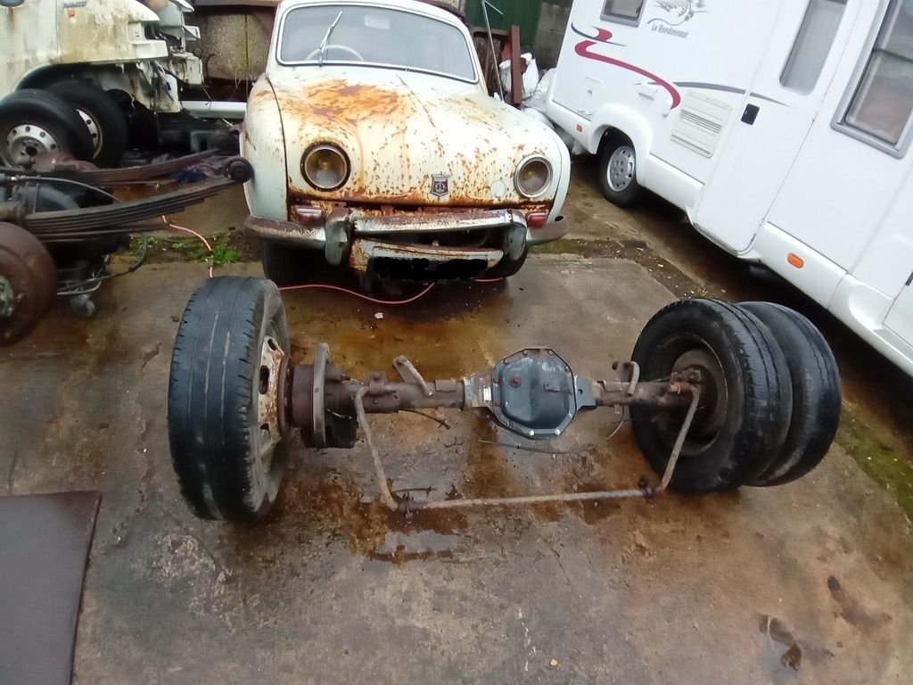

the new rear Iveco dually axle

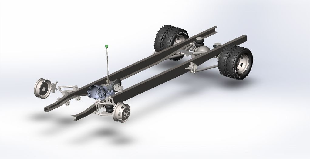

I worked out all the geometry on CAD first
Here's the front and rear all modelled up

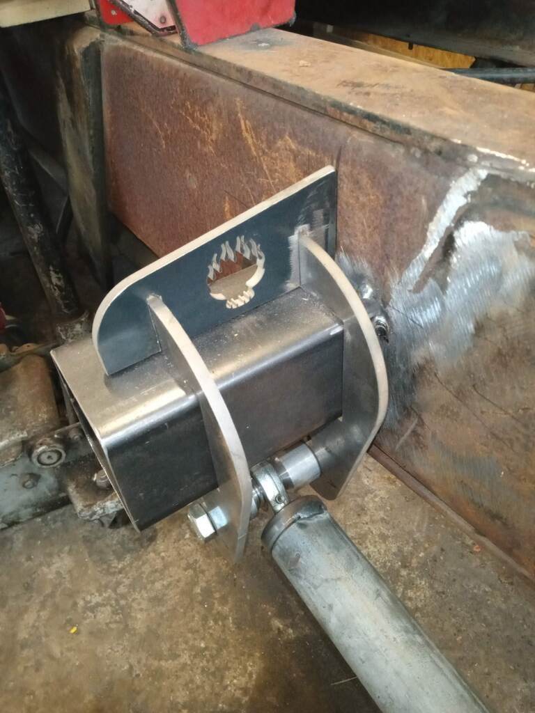

mocking up the outer 4 link mount

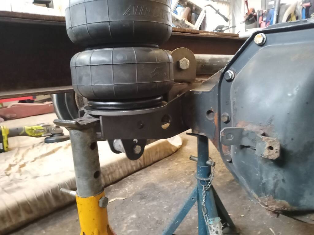

rear axle bag mounts being made
back 4 link all mocked up to check diff angle and stuff

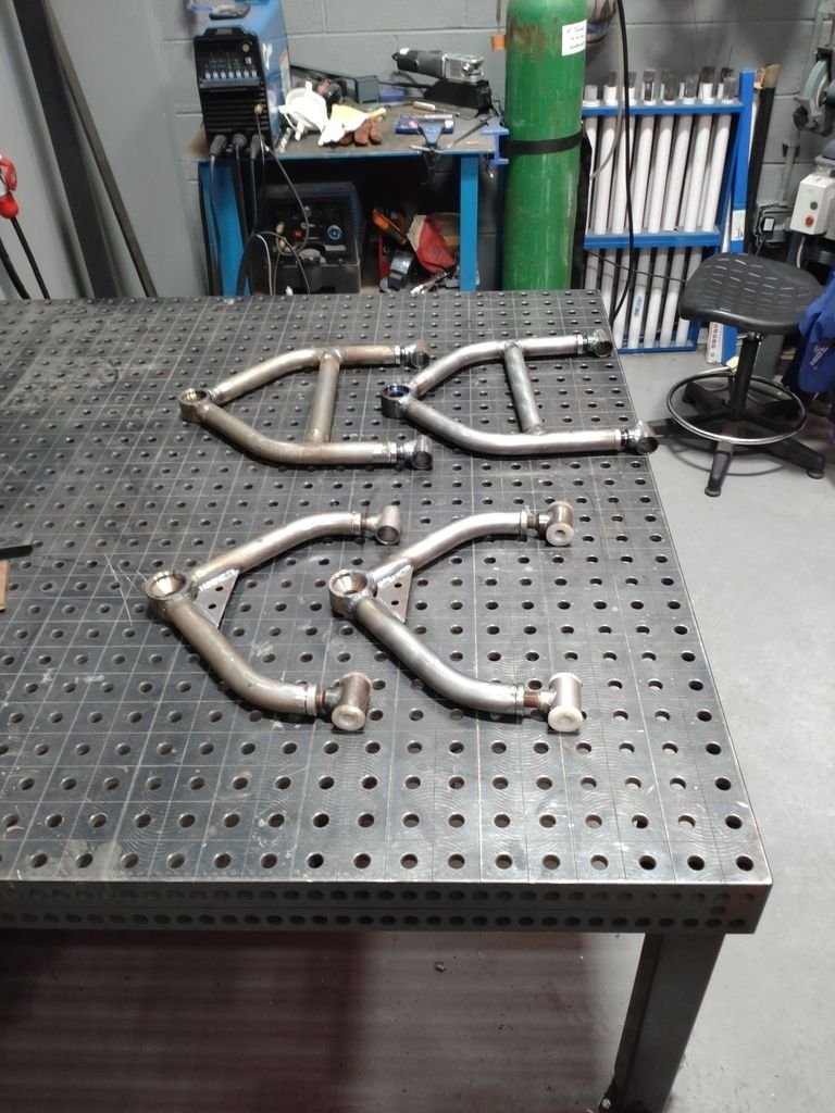

starting to put together the front upper arms

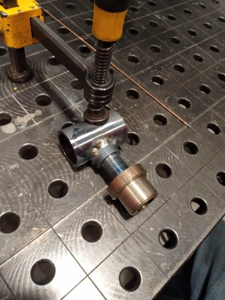

TiG'in the front wishbone adjusters
TiG'in up the front arms

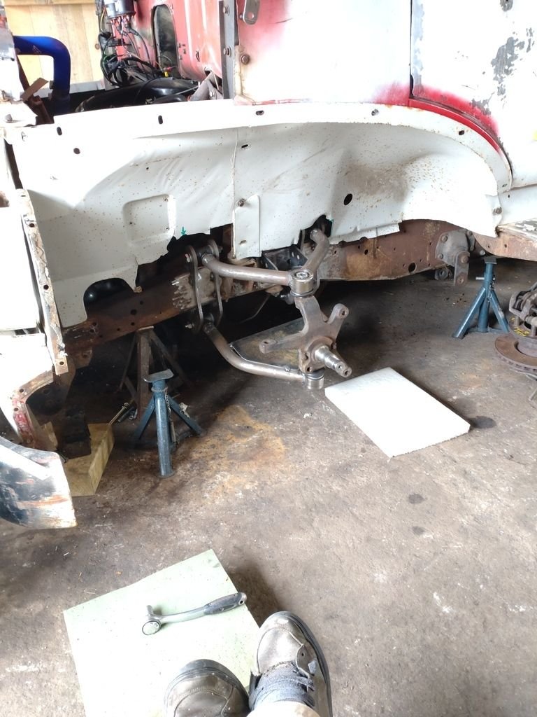

checking front arms for fitment, adjustment etc , inner wing need some work as its been hacked up before ,
welding the rear back mounts on

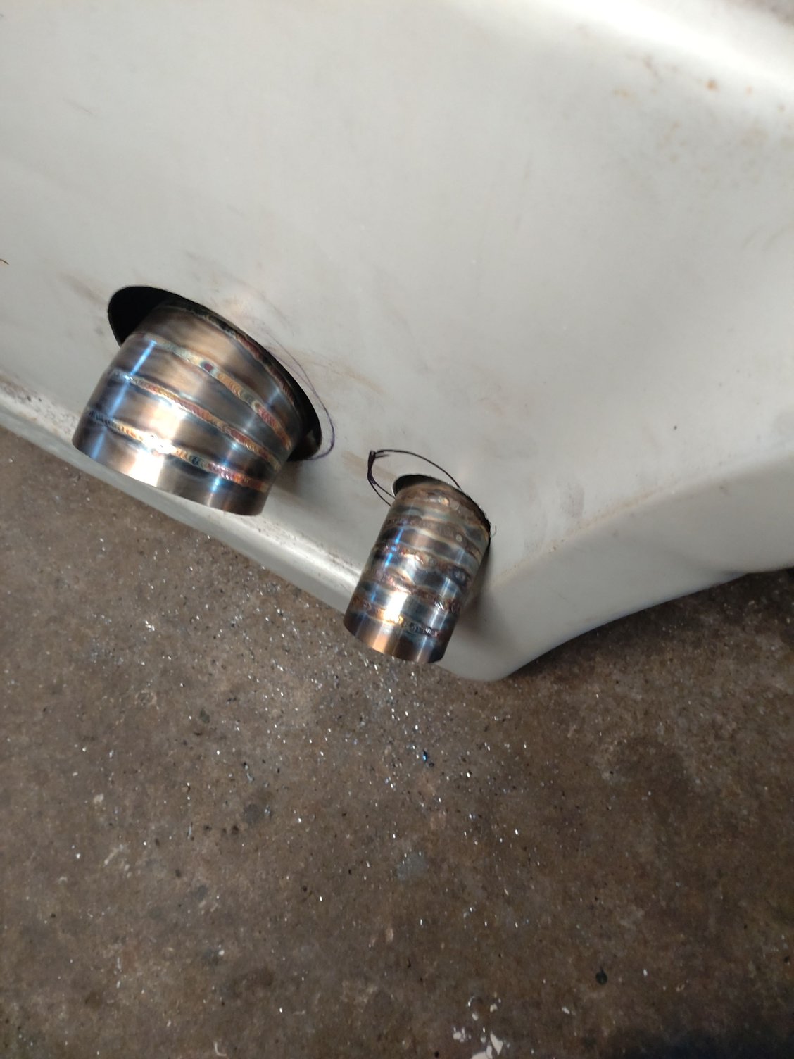

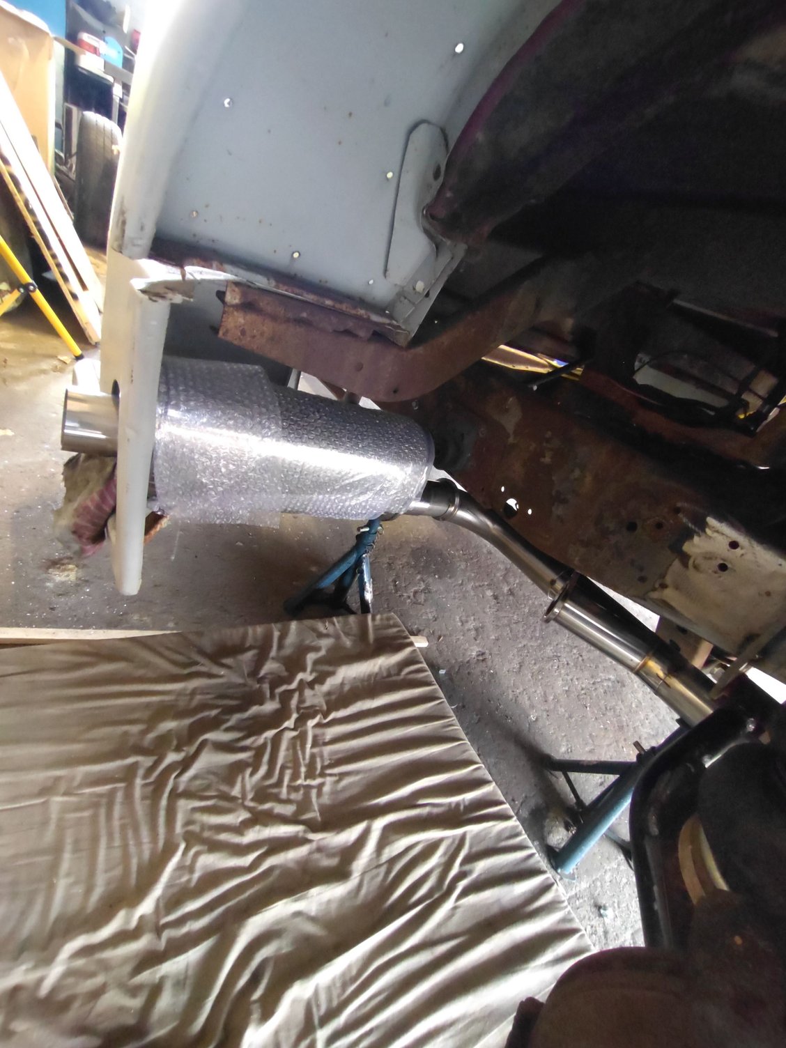

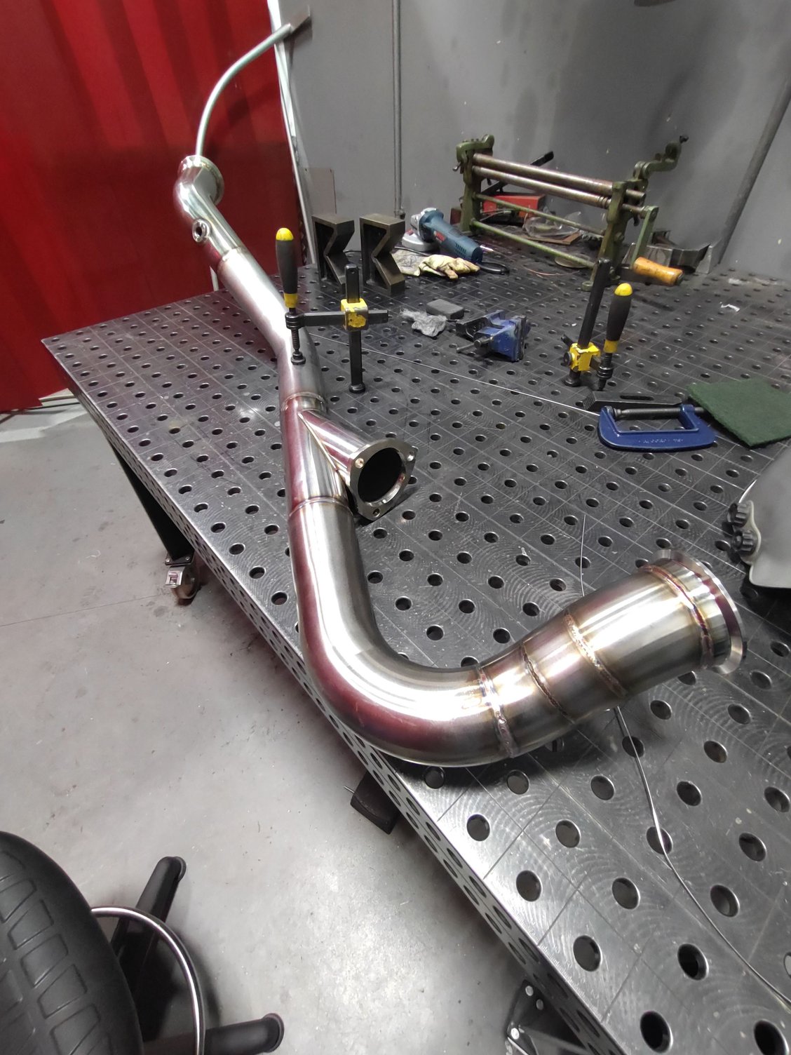

here's the exhaust I'm building for the truck, only one muffler, biggest i could fit under the step, bit as its a turbo motor should be ok , also I have a remote bypass valve to go on the 3 bolt flange before the muffler , but not sure how much difference this will make really, will have to see after I finish the new loom install
these are what the tips will be , once its all in and i can get the orientation right to weld them on, . one for exhaust and one for waste gate
