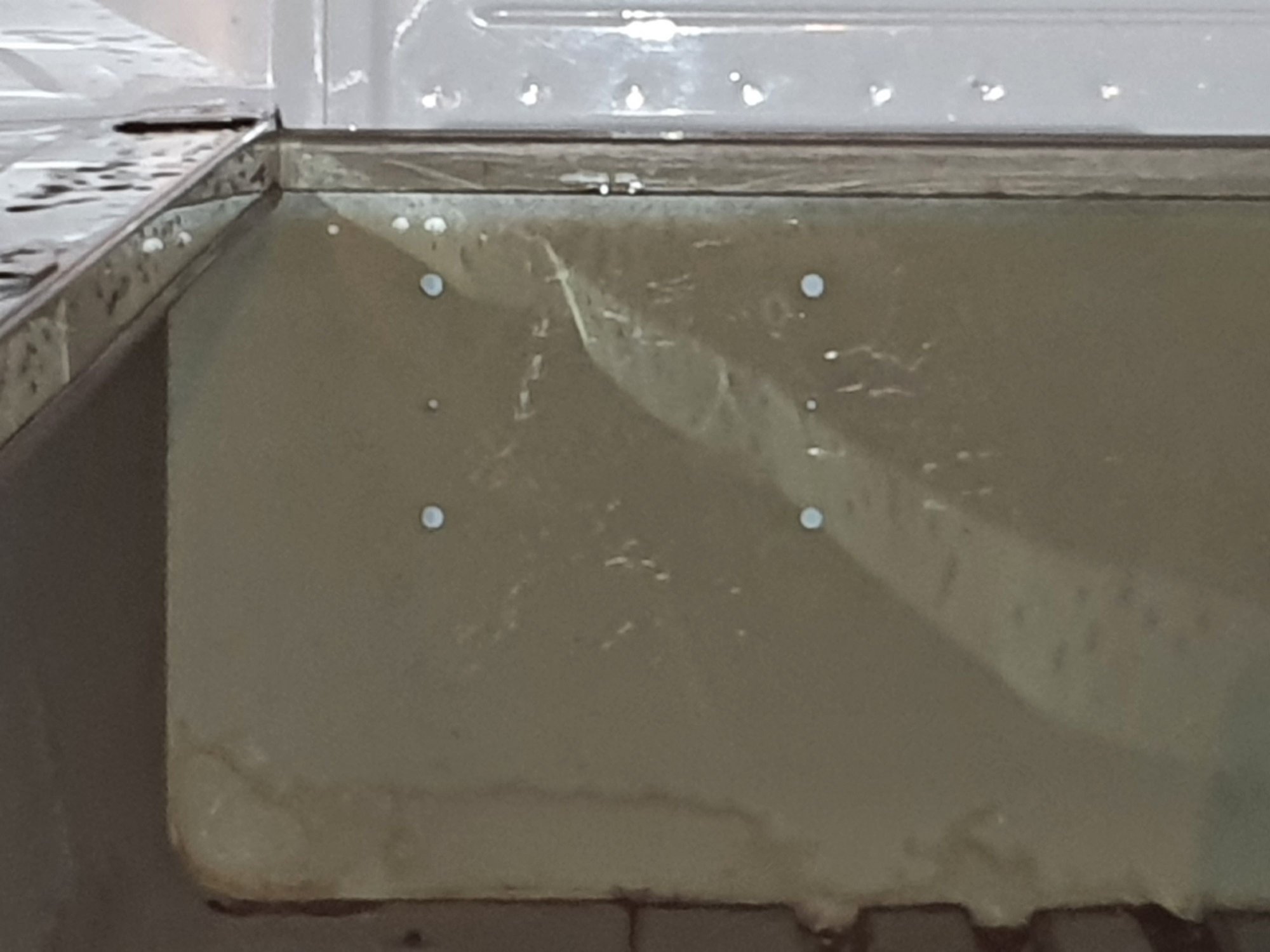

Originally Posted by Shovelheadrob
Back to the crack, I will be investigating further as it's a possible that something is slightly bent underneath, if you remember the truck was involved in a minor accident & it was the passenger side that had damage, my best guess is that when the rear fender took a hit it twisted one of the outriggers which has resulted in the weld to the tub fatiguing.....
I didn't remember that your truck was in an accident, and I hadn't seen your post below yet before I went hunting for a photo of the passenger side rear of the metal tub being fitted to the frame that would show the laterally oriented hat channels under the bed floor.
I crawled under the back of the truck & the crack is where the bracket for the passenger side mudflap is/was welded to the tub, the mudflap got broken in the accident so I'm guessing that it either tore the metal by the weld at the time, or it's slightly bent & it's a stress induced crack
OK, the ACCIDENT explains it. Because otherwise, that tub is quite sturdy, and is also insulated from frame twist by the wood spacer and sheer plate mounting method shown in the photo above.
Some questions for you in the photo below...
1. What's going on in the yellow oval?
2. What do you suppose the witness marks outlined in orange are from?
3. Are those all welds circled in red?

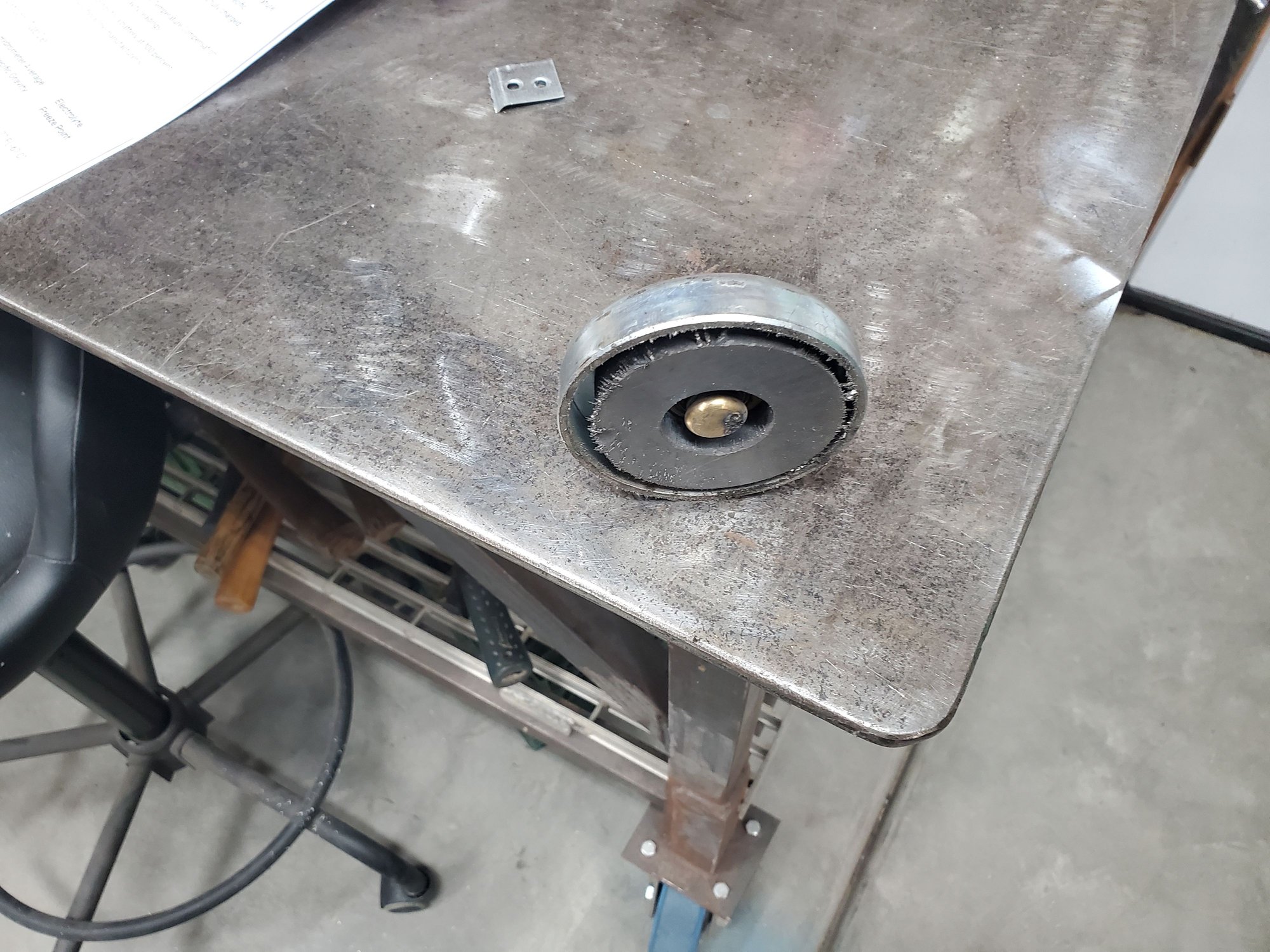

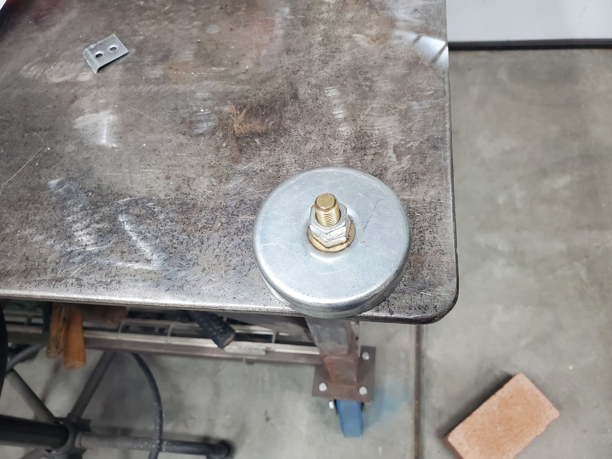

Seriously though if you are concerned about electrical current here is what I use, I got it from Harbor Freight, just grind off some paint next to the weld area and stick it on then place your ground clamp on the stud. Works great for things that are hard to clamp to also.
That is a small piece of the bed liner that is hanging on the welded edge of the wheelwell
That is where the primer that was applied before the bed liner has come away with the bedliner material
Yes they are where the top hat section is welded to the tub, i should have pointed them out & highlight them.....
As you say the tub is very substantial & was certainly built without cost being a restraint...
A quick question for your encyclopedic knowledge of these trucks, there's some holes in the front of the tub, they are symmetrical in position, do you know what they might have been for? I'm guessing from the history i have of the truck that they were there from new & not visible until I removed the bed liner.

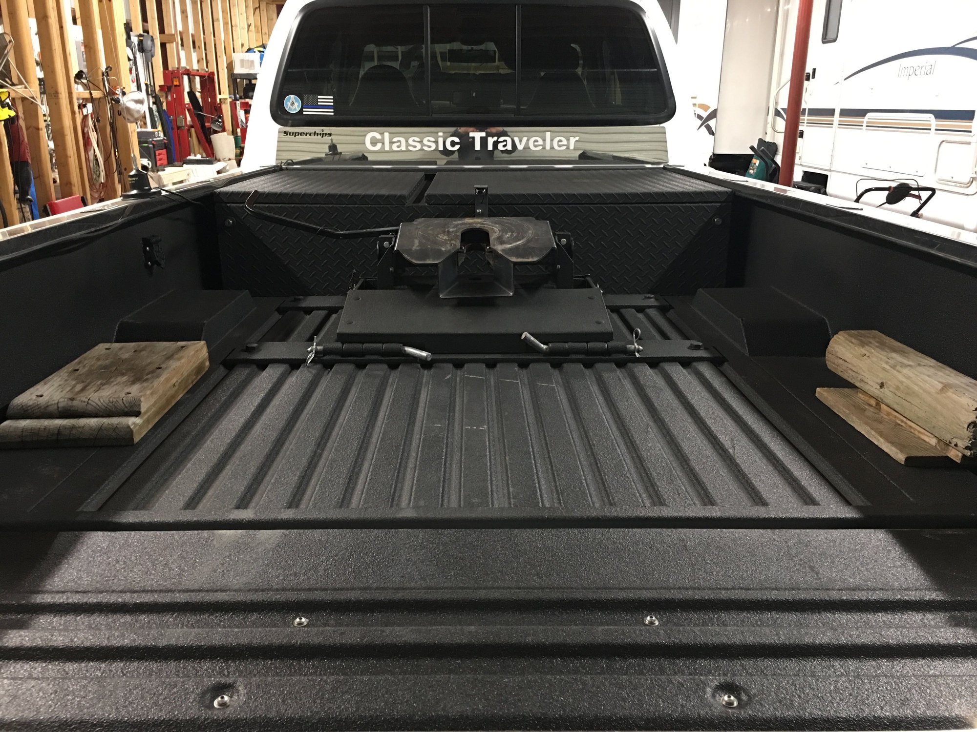

Did your truck come with this spare tire box installed, as shown in various examples below?
Old Feb 15, 2022 | 01:57 PM
Shovelheadrob's Avatar
Shovelheadrob
Joined: Nov 2009
Posts: 1,383
Likes: 193
From: Cambs, England
@Y2KW57 I don't believe it did, there's a hole below the spare which has a nut welded to a flat bar that's bolted through the bed, the spare wheel is secured by a long threaded bar to that, there was a custom made vinyl cover over the wheel which had shrunk & rotted from the sun. No graphics, no stainless trim at the front of the bed, just the opening tailgate & hide-a-hooks along the bed sides, they didn't go mad with the options.

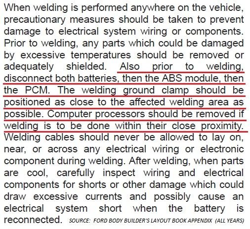

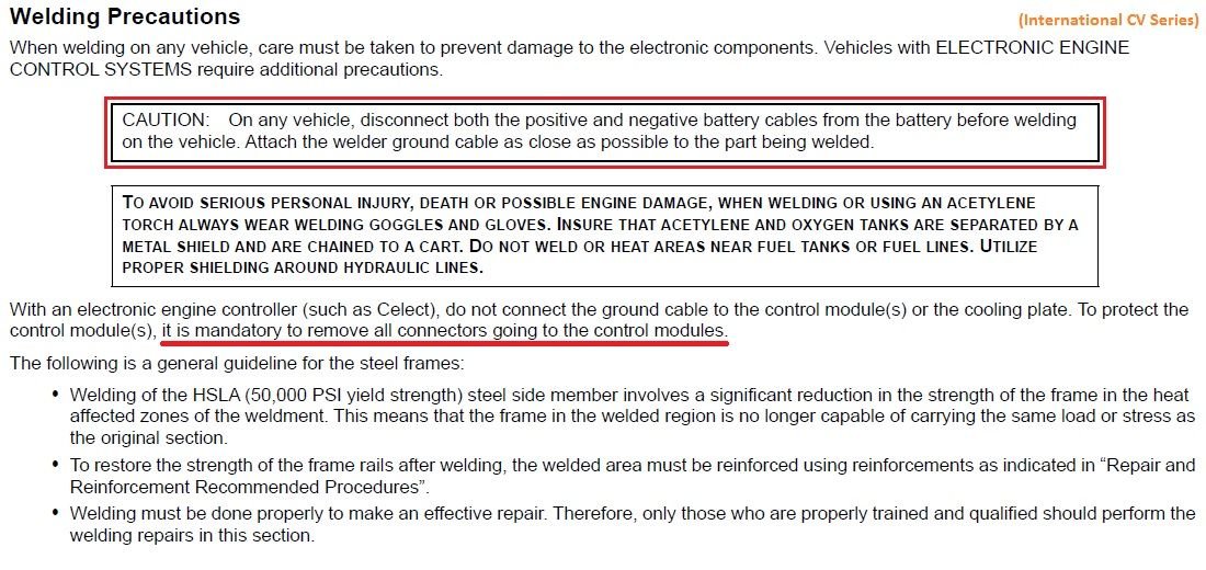

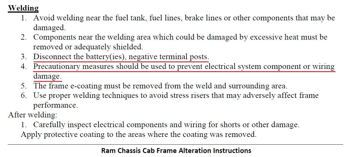

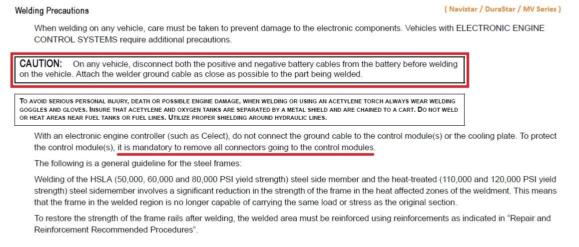

Originally Posted by MountainManRobb
I understand that there is all kinds of urban legendry out there about disconnecting batteries and such...
Whether or not it is fair to dismiss the OP's concerns as "urban legendry" is up to each reader, but the OP's precautions provided in Post #1 of this thread are spot on consistent with the best practices and precautions issued by every truck manufacturer in the industry.
