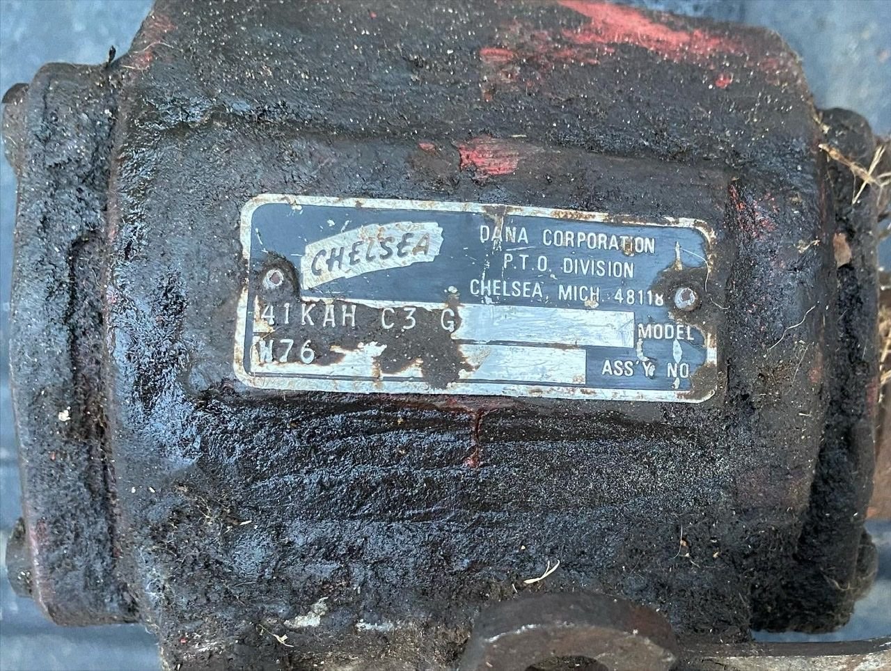

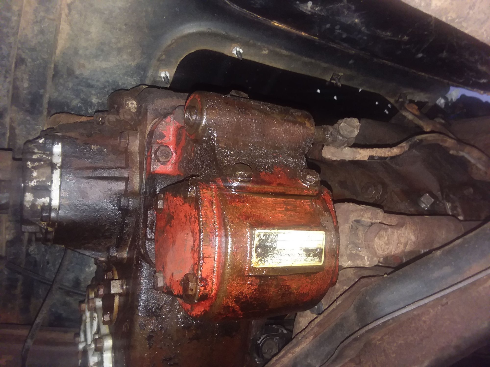

You might be able to run a PTO off the 205.
I'll try to get a cleaner picture tomorrow.
Cleaned, resealed and painted.

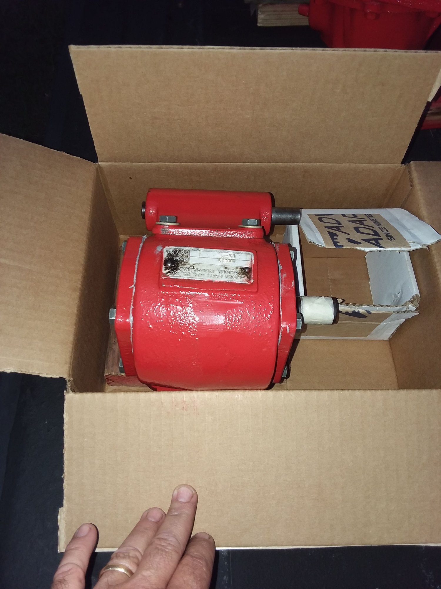

This is one off an NP435, which should fit a 205 t case I think.

Looks like it. Ours is a Muncie, but I think that Muncie, Dana and Chelsea are basically one in the same.
Ours is Model # 41KEY
