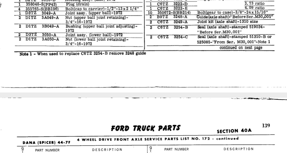

Appreciate the response, but I've done multiple searches in that fashion and they haven't yielded me useful results so I wasn't certain I had the right PN. All the parts houses list the outer axle seal for a '66 F100 Dana 44 as National 40769s, which is a 2.3" outer diameter, or when I search specifically for C6TZ-3254-C, it shows the OEM NOS seal as 2.8" OD, however, my Dana 44 has a 2.0" diameter bore. Not sure why there's a discrepancy.

This is what I found in the MPC. I am an amateur, but it appears there may be two seals depending on the Serial number. Could also be a C6TZ-3254-B. I am assuming it is for the 66 F100 4x4 in your signature

C6TZ-3254-C , Read note 1 at the bottom of that MPC page.

After searching around for PN C6TZ-3254-C, the consensus seemed to be that it corresponds to Timken 5131, however, found after buying it I found it isn't even close to fitting in the housing, as it's much too small. Next, I searched for the C6TZ-3254-B part which seemed to point to the Yukon YMS40769s, which specifically states it's for a Dana 44, 19-spline axle, however it also didn't fit as it was too large to fit in the smaller section of the housing.
I ended up calling a few 4x4 parts houses and they didn't have any idea what seal goes on the outer housing, all their references just pointed to the inner seal. Finally, I just took 654x4 advice and looked up the Napa seal, which cross references to the SKF 13568 and Timken 480570. After a bit more digging I settled on the Timken 472258, which is the same dimensionally to 480570, just the seal is a double seal design, instead of the single seal design of 480570.
