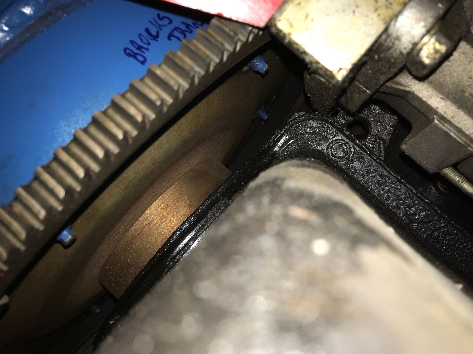

I've done a lot to fix leaks on this truck. The original leak was coming from the HPOP seal but two separate mechanics guided me into completely unneeded services and now the truck is leaking worse than before.
Resealed: full HPOP, oil cooler, injectors, valve cover gaskets, crankcase vent o-rings, turbo pedestal, front main seal, lpop housing seal, rear main seal, oil pan, dipstick tube.
The oil is running from the very front of the oil pan down along the oil pan- this makes me want to blame the mechanic who resealed the oil pan. Or possibly the front main seal? More likely the oil pan because they did not pull the engine and flip it over to do this job.
The oil is also dripping a lot of drips at every single stop, from the inspection cover at the back of the engine/oil pan area. It's very hard to tell where this oil is coming from. I suspect the oil pan is leaking because the upper oil leaks have been taken care of.
But every single time I get on top of this truck to do something, there is either oil or diesel that I'm making a new mess with, and it's impossible to get ahead of the problem! The darn thing doesn't stay clean long enough to know for sure where the leak is coming from. But all available sources tell me that the front and back of the oil pan are almost sure to leak if the engine isn't flipped over for the reseal.
Has anybody else been through this journey? I just want my daily driver not to embarrass me and mess every single parking spot I go to.

I have cleaned this engine thoroughly so many times. I mean with brake cleaner and rags until bone dry with no shine at all. The top of the engine stays totally dry under all driving conditions ever since I resealed the HPOP. The problems is I can't take the top of the engine apart and scrubadub dub for 30 minutes every single time there's a little spill. I've investigated this leak thoroughly and cleaned the hard to reach areas.
There was a leak that persisted from after a mechanic had done my valve cover and valve cover gasket and over tightened the bolts so much it ruined the gasket. That leak wouldn't go away and I couldn't be totally sure until that was taken care of. But there has been oil on the starter, coming down from above on the bellhousing. It's so confusing. I did these cleaning/ checks with flashlight and mirror at 2500rpms many times and found that a leak is originating at the rear of the oil pan. That is certain. But it has the appearance of being a very fast leak when other leaks are happening.
The valve cover leak, along with excess "spillage" blowing down the bellhousing from the top of the engine, and the oil pan leak, and the leak from the front, are all just too confusing to deal with at once! I understand the highest leaks have to be fixed first. It's just so aggravating when all my efforts are failing. It's like whack-a-mole with oil leaks.

The engine support/crossmember had been previously cut out to reseal the oil pan and re-welded really poorly by the previous owner of the truck. The mechanic who replaced the oil pan and resealed it cut the crossmember out at the bad welds to R&R the pan. Then the shop welder re-welded the crossmember in and did a good solid job at it.
The sealant used was not Ford/International. It was Permatex gray.
Multiple times I have gone back and checked the oil pan bolts and found they were not fully tightened in. I don't understand how they can loosen out if I've already tightened them. Also, if they are coming out maybe that's why it was leaking. AND- the mechanic had done the whole job a second time because it continued to leak after he had already done the R&R once!
So obviously the engine needs to be flipped to do this job correctly. I'm just really not sure this leak is bad enough to spend the time and energy to do a big job like that. Which is part of the problem I'm facing. I can't get these damn leaks to stop! By now they should all be gone. Nothing has been untouched on this engine.
I feel like it would have made more sense to pull this engine out of the truck when I first bought it and just rebuild the whole thing all at once. The only benefit to the way I've done things is that I've learned the ins and outs of the 7.3 Powerstroke.

The oil pan bolts are loose every single time I check them. I just don't understand how this is possible. I've tightened them twice. And the mechanic stripped out the front cover passenger side and had to drill and tap to a larger bolt size. With the Permatex gray silicone formula being used instead of TA-31, I don't know how the torque specs are affected.
There is a layer of oil being stored between the bell housing and the engine too, and it seems like more oil is all over the back of the engine too, but I can't really clean that because of the amount of grime and horrible access. It almost makes sense to pull the engine just for the joy of power washing and knowing that it's clean.
