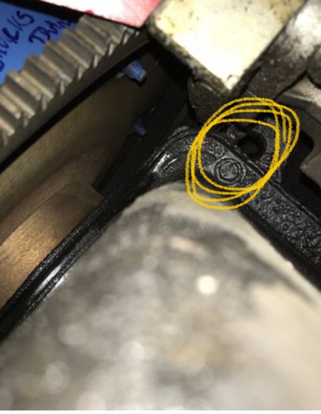

The valley drains into the bellhousing and exits above starter.
Are you saying the exit for the oil hole at the back of the valley is that little hole by the oil pan in your picture?
I did a thorough cleaning up top and the valley was covered in oil after fifteen miles.
This led to identigying a fast leak coming from my HPOP line to the passenger head. Apparently I didn't tighten the o-ring boss fitting enough when I reinstalled it.
So now I'm back to cleaning the engine again.

Yes, this is where stuff from the valley comes out.
Sounds like you found it! That will leak plenty.
At the back of the valley on the passenger side is a hole that allows oil leaks from anywhere on top to drain down the back of the block. Usually misinterpreted as a rear main seal leak.
