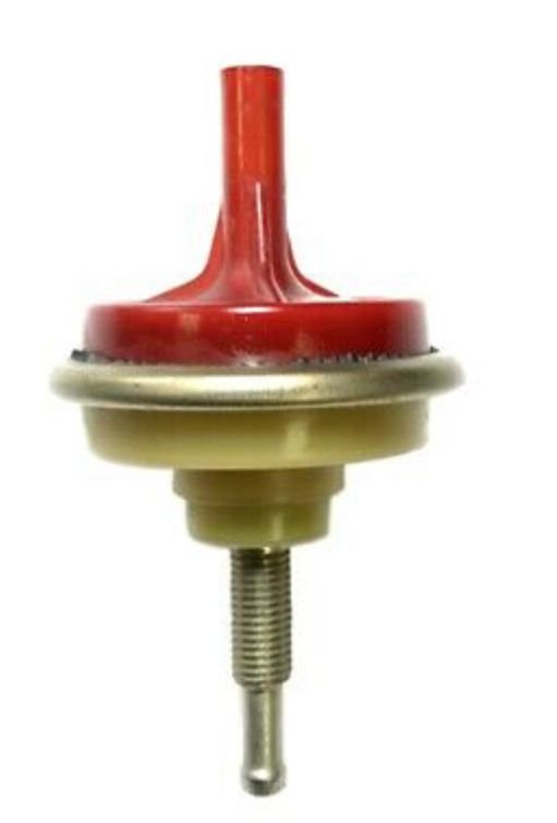

I'm rebuilding my carburetor and inspecting/cleaning all the exterior parts having to do with choke and acceleration and all that good stuff. After researching about the dashpot for deceleration I'm curious if anyone has some info on here.
Wondering specifically about clearance from accelerator linkage. And also, I'm assuming that this is vacuum controlled, but I'm not finding anything to verify that. Where would the vacuum hose come from?

Looks something like this. The metal barb on the end looks like where the vacuum hose would go. Considering it should only work under acceleration, should this go to mani vac or ported?

It will only work if you use manifold vacuum. Ported vacuum would be zero when you let off the gas.

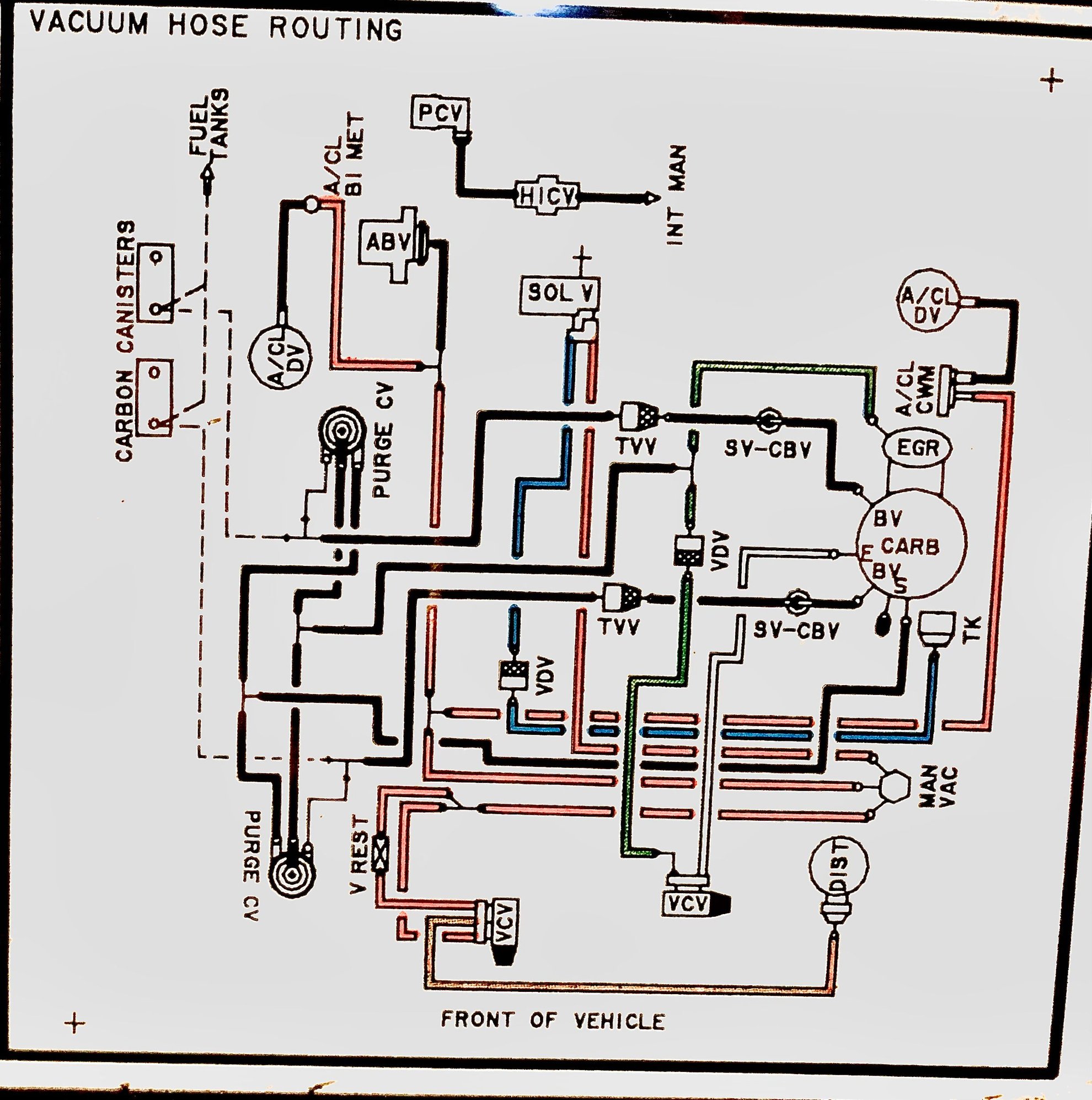

Figured it out for anyone that is curious or needs this info in the future. It's called the "throttle kickdown". Vacuum routing is on the vacuum diagram under the hood (who'd have thunk it )
This is a 1987 F250 XLT Lariat CA.
