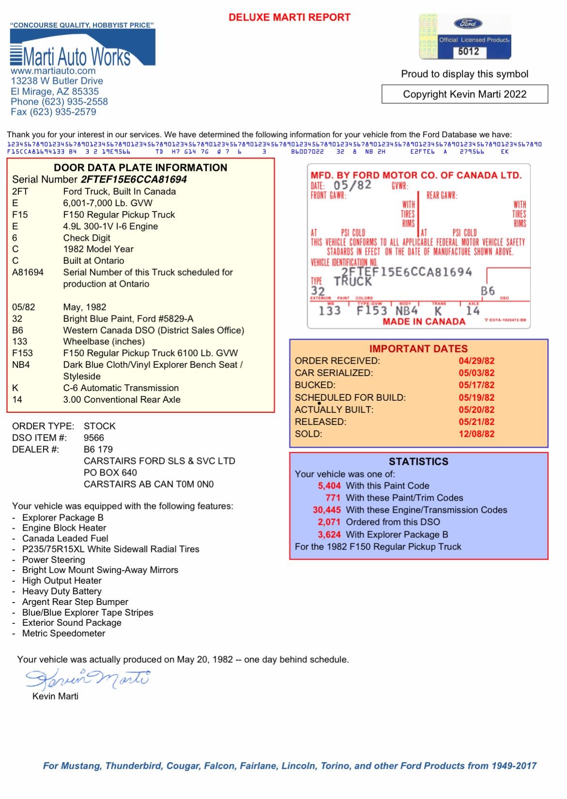

I picked up an 82 F-150 explorer B package a few weeks ago and I’m trying to figure out what that specifically entails.
the 81 package list doesn’t match as this has wood tone and automatic but no adjustable steering wheel or AC.
I appear to be about a decade late asking this question but hope springs eternal.
im also hoping it helps me narrow down what all the vacuum tubes are on this Carter 7051SA carb are for while I poke it with a stick.
the build sheet is interesting but generates almost as many questions as it answers. I didn’t seriously buy a weird unicorn from the 80s did I?

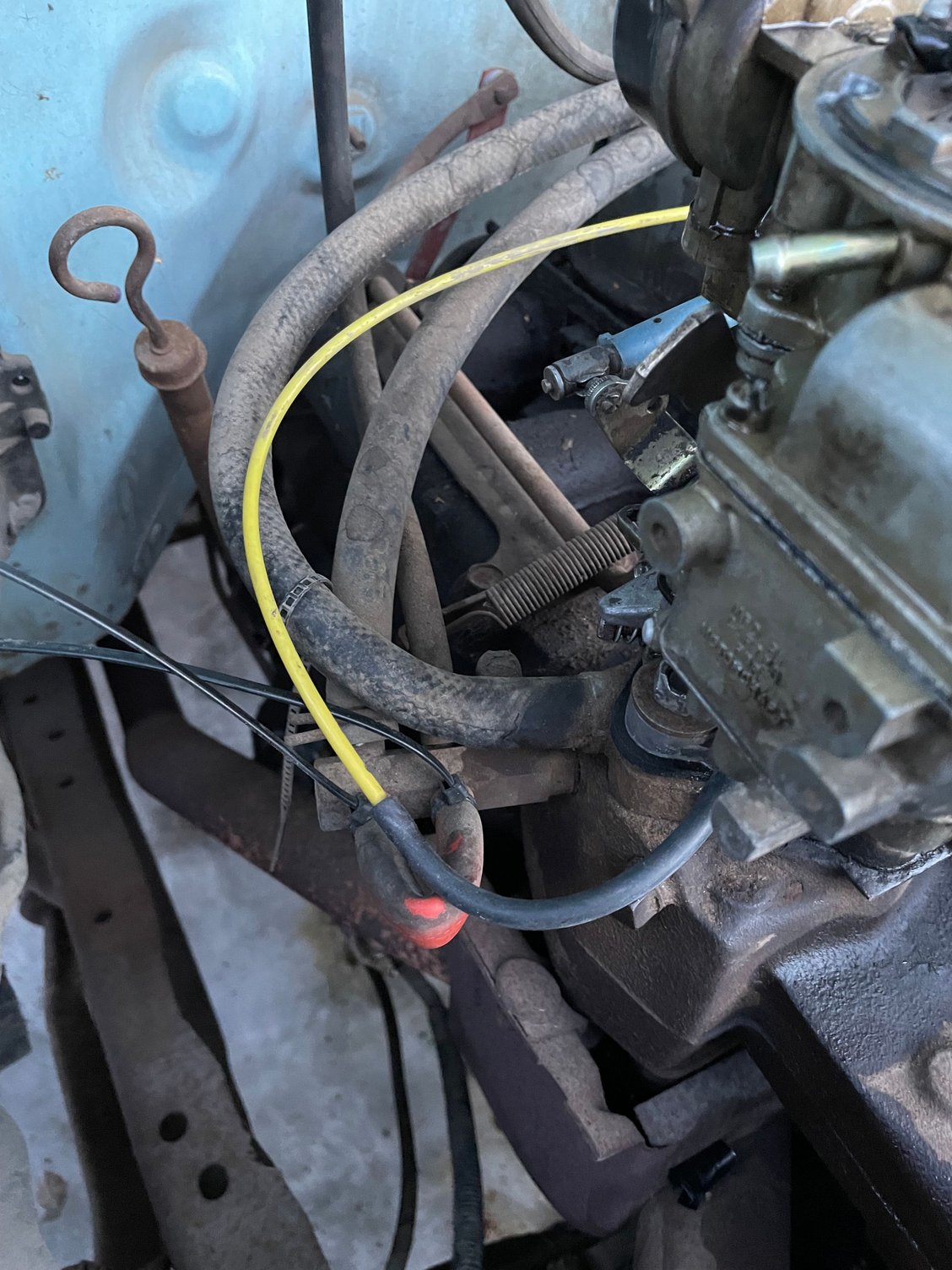

I got this truck from a guy who let a local high school do the carb rebuild on it 3 times and it never ran right afterward so it's an open mystery what I have connected.
I've got the rebuild kit for the Carter YFA carb and I'm going to be very careful to hopefully get it back to the proper condition. My buddy took it off before I got there and didn't take any pictures of it before he started messing with it, he then put the float and the metering rod in wrong so it explained on the surface why it won't fire.
I don't expect there to be a plethora of information I've simply missed out there but I've got faint hopes and if something turns up then maybe it will help someone in the future.
Passenger side of the carb
Drivers side of the carb

So it looks like you don't have much, 1 hose, hooked up.
Dose that go to the distributor? housing. So it should be ported vacuum. No vacuum at idle but has vacuum when the throttle opens.
That other nipple is for the fresh air to the choke.
Hose from there to the top of the exhaust manifold.
Another hose out the bottom to the choke housing.
Do you have a vacuum hose sticker on the radiator support?
What air filter do you have for the truck?
No smog check is good and you don't have ACfrom what I see, power brakes?
Dave ----

I'll have to drive over and confirm if I have a sticker, I never thought of checking but the yellow hose goes to the distributor, it got broken during removal but we taped it up for testing. I've been trying to figure out what specifically it's called so I can order a replacement.
Power brakes yes, no AC though.
This is what it looked like before we took the air cleaner off and started fiddling with it. It was -30 on that day so I wasn't lingering.

WOW you got a lot of (bad) going on under the hood
The good is it all can be fixed.
That yellow plastic line replace it with all rubber hose and any other plastic lines that might still be on the motor.
I did see the choke dose use hot air & electric to make it work right.
What is with the metal gas line from pump to carb?
I see it has a rubber hose on the end going to what?
I also doing think that carb is the right one for that year truck.
I say this because I am not seeing a bowl vent on it that the carb would have.
If the carb works then use it, no need to replace it because it dose not have the vent.
Do you have that vacuum sticker on the radiator support?.
It will help to get every thing back in place and working but we may need to make some changes it you have parts missing.
My 81 F100 with a 300 six has some things missing so I had to re-route hoses that I felt were needed for the weather I will drive the truck in.
To bad its so cold, I see snow, I would say de-grease the engine bay so you can see what you are working on LOL
