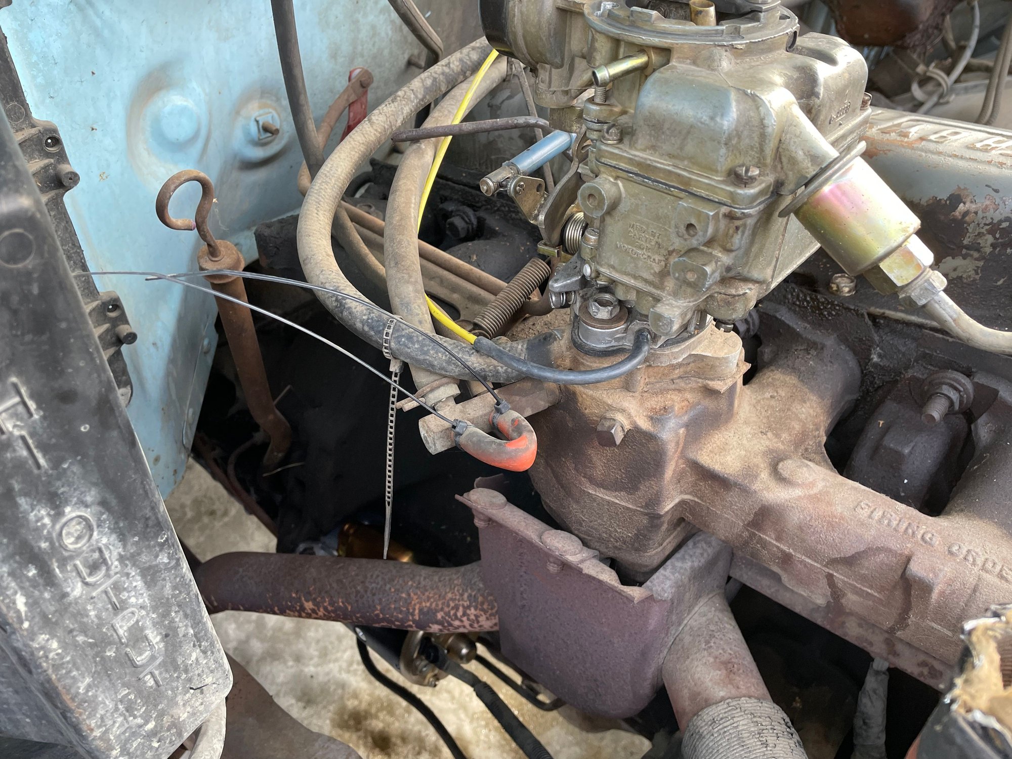

The threaded nipple near the choke housing needs to be capped if not in use. That goes to a metal tube that should connect to the exhaust manifold It's a long story and there is a good thread on Gary's site, and possibly here too. For your testing purposes, I would cap it for now. You can wor out how you want to run that later. It will make a small vacuum leak if open.
Ultimately that tube would feed heat to the choke housing to close the choke faster. See photo to see if it helps you identify any of the screws and parts. I'm kinda lost on the actual screws on the Carter.
Have you got the truck warm enough to know if you are off the choke high idle? I just can't imagine working in the temps you are and the truck warning at all. See if this link helps at all. I hope they allow a cross link to Gary's. https://www.garysgaragemahal.com/carter-yfa-1bbl.html. There is a choke page too that has a diagram and explanation of hte hot air tube.
You are a little off on what you said.
It should not be capped and the amount of vacuum leak is nothing because when the metal tubes are hooked up as they should be it is pulling a vacuum of clean air from inside the air filter.
Also till you get the metal tubes in place like the factory had them you really cant get the choke to work 100% as it uses the heat from the tubes & the electric to OPEN the choke.
You already know the choke adjustment and in the picture above the curb idle speed & fast idle speed screws and on the other side there should be a screw down near the base and that does the idle air / fuel mixture.
Once the choke is off all the way and the (curb) idle speed set you can then adjust the mix screw for best idle speed.
You may need to lower the idle speed when doing this adjustment but most of the time not.
They say you can use a vacuum gauge to adjust the mixture and timing but I have never used a gauge for that.
Dave ----

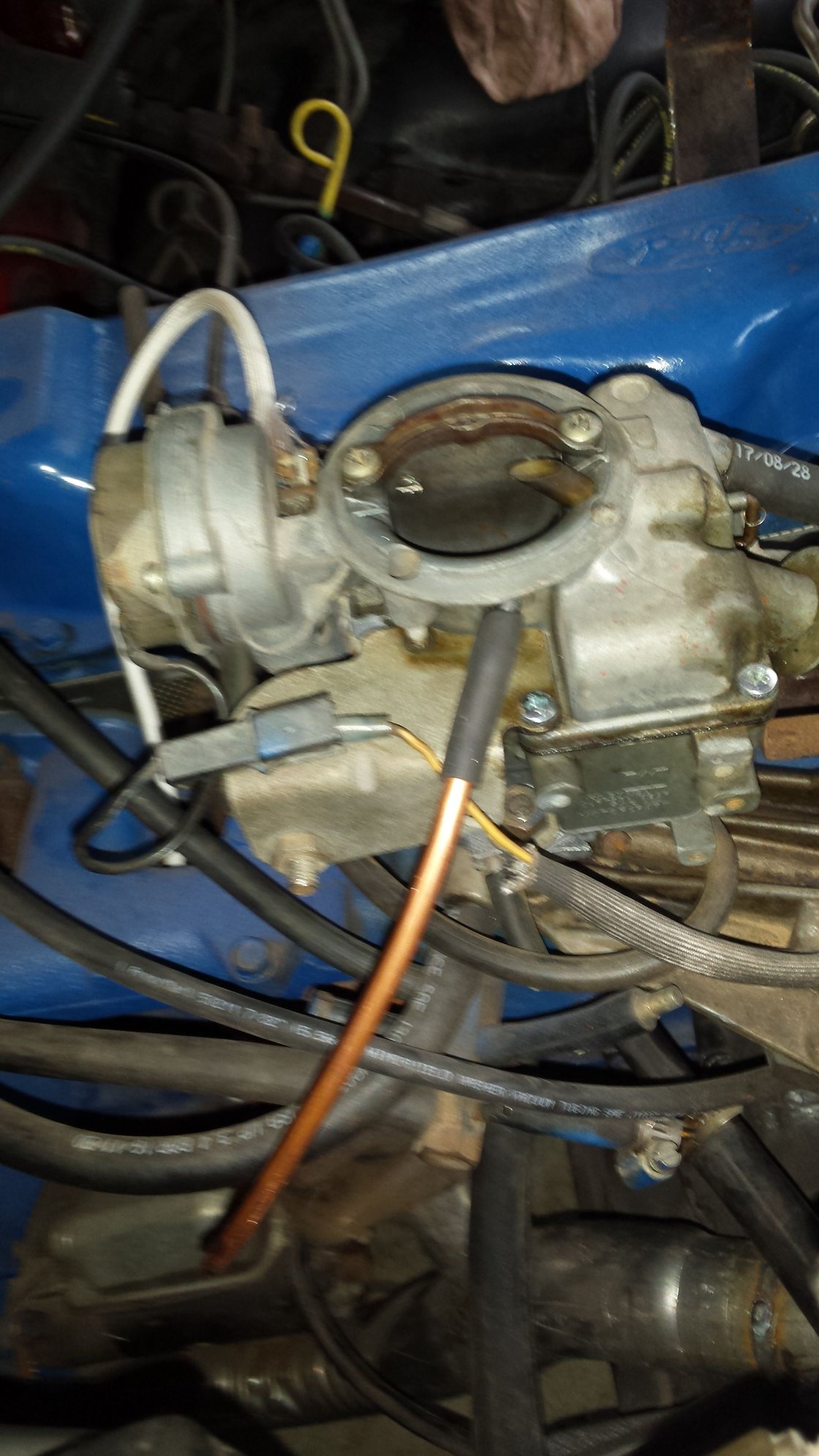

That would potentially explain some issues we had where it would run really well but then either be stuck open or closed. I'll do some reading on those other posts now.
That picture is a big help and I'll root around for that thread but it's odd, the screws on my carb and the screws on that picture aren't all in the same place at all. As you can see in this picture, it looks like the curb idle at least is on the opposite side.
I'm uncertain as to where the line for the choke needs to end up as you can see in the picture below it just kind of stops, it was capped but we removed that and should put it back for now. Would it go in that hole on the manifold that has the square bolt in it? I'm at a bit of a loss as to where a metal line would go otherwise.

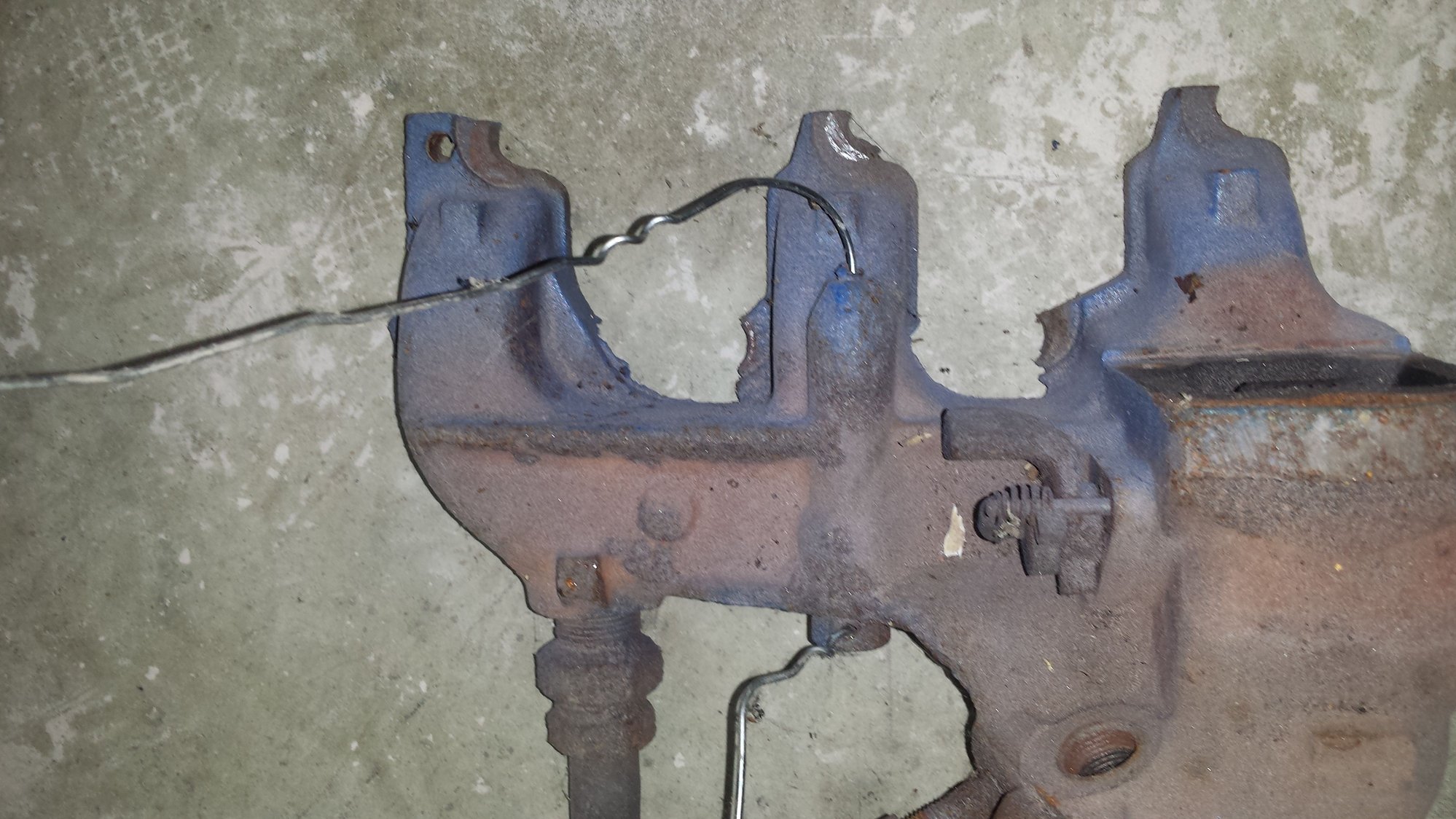

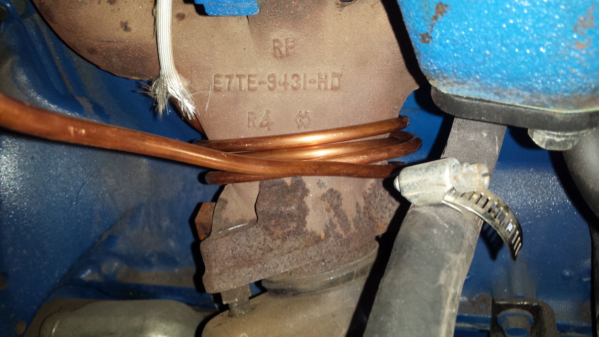

On the back side of the exh manifold between the intake runners you should see what might be left of the heat tube.
There should be 1 on the bottom side also.
There is a tube that runs inside the exh manifold that gets hot with the gases flowing by it.
See that nipple up top where the air filter sits? A short hose goes from there to a metal line that goes into the bottom of the exh. manifold.
Then a metal line comes out the top of the exh manifold and goes to the choke housing. This line should get hot and should have a insulating sleve on it to keep it hot.

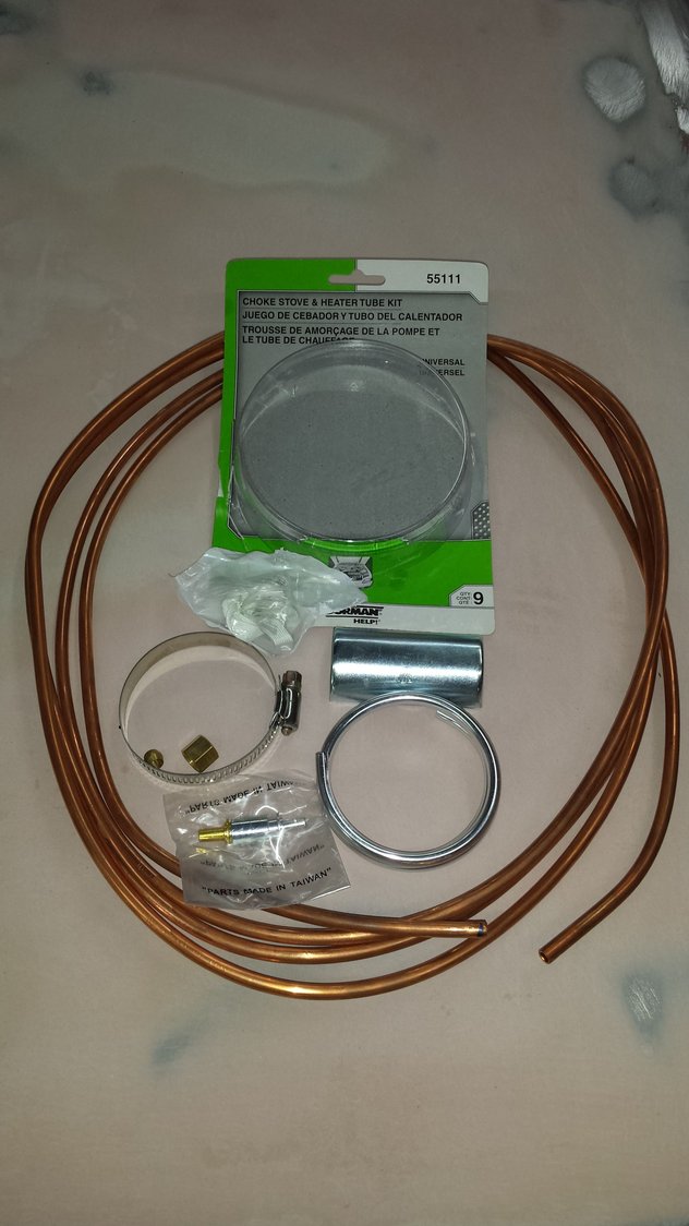

Doorman makes a kit to repair the lines as they rust away most likely like yours did. This is the kit less the copper tubing.
Now if the tube going through the exh manifold is in good shape and the Doorman kits tubing is not long enough get some copper tubing that will run from carb to manifold (cold side) and manifold to carb (hot side) and use the other fittings to make it work.
Now why I have the copper tubing?
I am running EFI exh. manifolds 3 into 1 x2 that flow into a Y pipe.
The EFI dose not have a choke or any way to hook up a hot air line to the choke on my trucks carb, so I had to come up with something.
My fix was to use the copper tubing and wrap it around 1 of the manifolds a few times to get heated.
Cold side of carb like yours would be
The wraps around the manifold
The hot side with the insulting sleve hooked to choke
Now when it got pretty cold here, think it was below 40*f the choke would not open all the way so I leaned out the choke adjustment a little andit helped some but it still stayed on fast idle.
I believed the hot side was not getting hot enough. My fix was to use header wrap around the copper loops to help heat the line and so far its been working.
If the line through the exh manifold is bad maybe you can do the copper tube wrap around the manifold?
The other thing some have talked about is the electric part of the choke. This is not a 12 volt choke on this carb but a 6 to 7 volt cap.
It gets its power from the ALT stater post, it puts out the 6-7 volts and where the factory gets its power from.
So if the copper trick cant be used maybe get a full 12 volt cap to replace the 6/7 volt one and run 12 volt when running to it.
Dave ----
