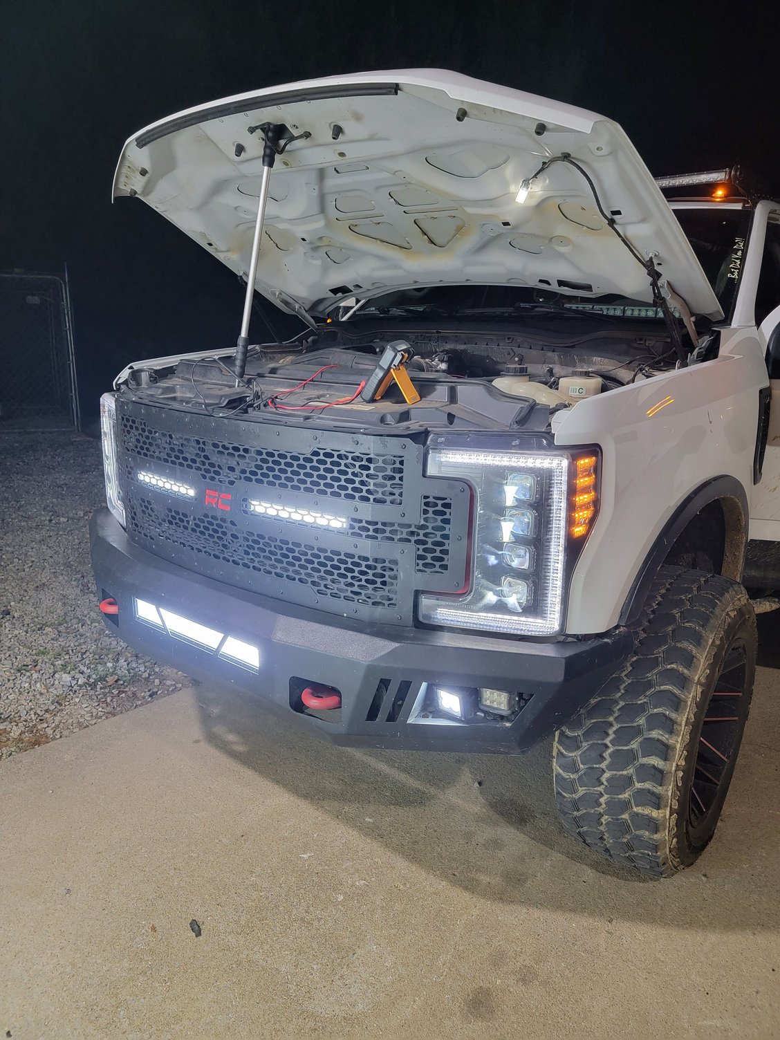

Alright guys what I have on my positive terminal is a black flat square right off to the side of the terminal with a 4 to 6 gauge wire actually made into the plastic. This has to be the BMS pole for the system. I also cranked the truck and sitting idle with no load from the system I'm steady 14.4 to 14.5. as soon as the load comes into play I'm still rocking the 14.4. I cant blast right now because everyone would shoot me but I have everything with me for a trail run tomorrow. Is there a way to unplug this battery management system and take a test?

As of this afternoon we now have an airbag warning on the instrument cluster and god some reason my trailer brake module and my stabilitrak hard button do not work. The TBM is saying fault. What in the hell is up with this crap.

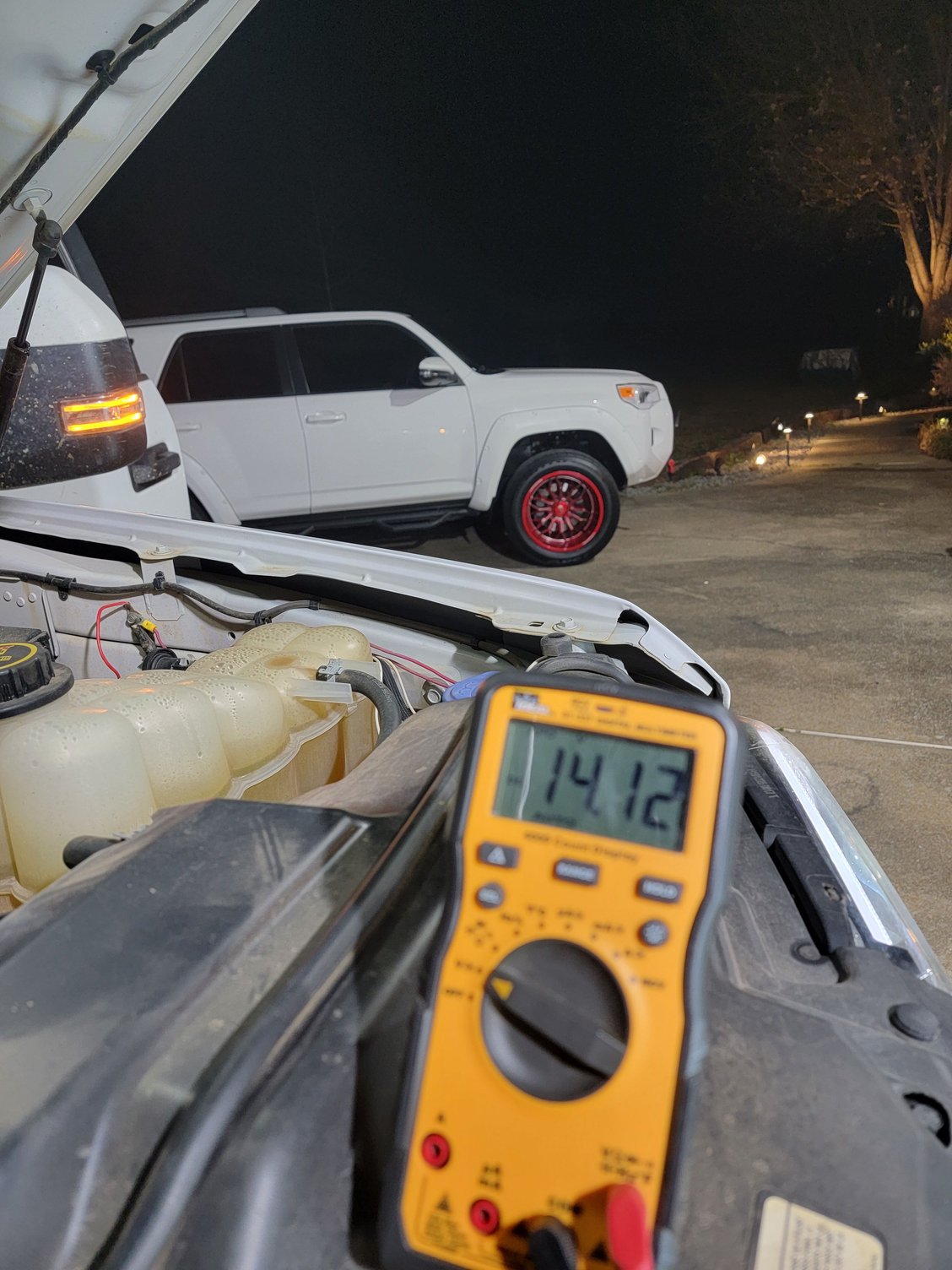

I have a dc meter

With that meter you can check the alternator output and the amplifier output. You may need an assistant to apply throttle to your engine
as you check your alternator with all lights on a/c or heater on high, heater seats. Then check your battery lead to your amp when its
cranked up, Voltage shouldn't drop under 13 volts for most of this test. I was testing my alternator on my 05 excursion with a 2500 watt inverter

This is with all my lights, radio, ac, and inside lights on
