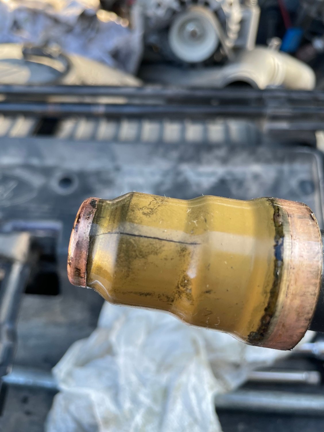

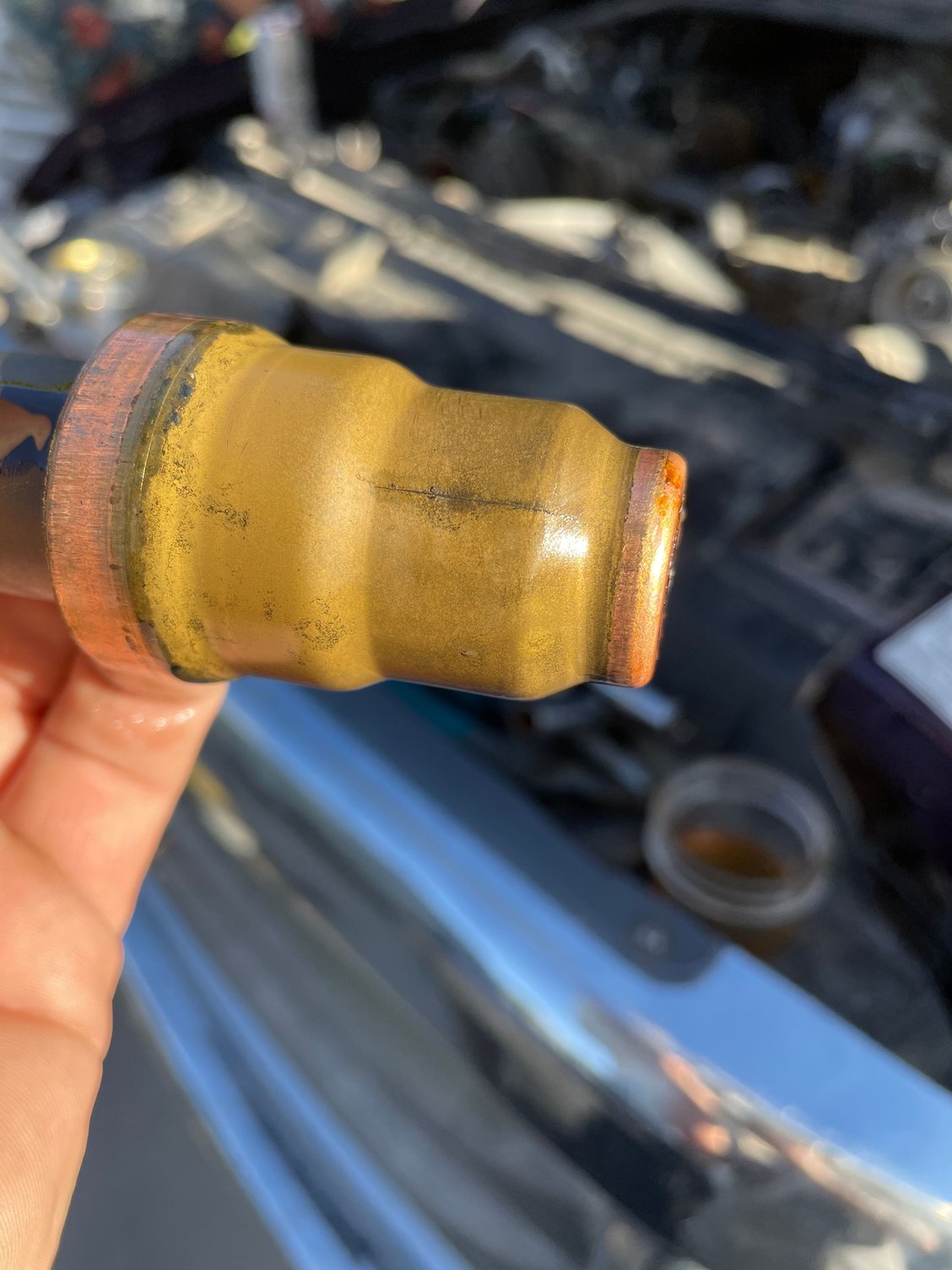

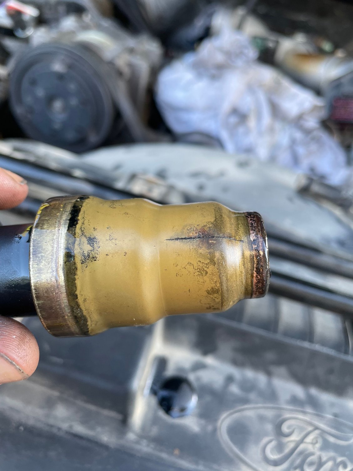

They’re difficult to change and lots of room for error. It sucks when they let go though I barely made it home. Here’s mine at 240k miles. Three were cracked it puked fuel all over my driveway. No idea why they let go it’s a mystery to me. Hope this helps,

So what causes them to fail. I know it’s a loaded question but I can’t for the life of me figure it out.
Coolant choice doesn’t seem to have an effect on them otherwise they would be eroded, corroded, oxidized etc. Every failed cup I’ve seen has been cracked with no visible signs of weakness otherwise. All three of mine were cracked and the cracks did not look fresh before they gave up and started leaking. Maybe it’s a mystery.
Hope I didn’t hijack a thread. Figured since we
were on the topic…
