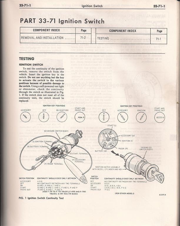

Ignition switch is my first thought.

Tbear, I appreciate the response and the story. I am thinking ignition assembly as well, because the ignition module should not have power when the ignition is off and the keys are not in the truck.

Was my thought too ... my '77 has nothing that isn't shut off when the key comes out. For the DS module under the hood to see any juice, the ignition switch has to pass it along somehow.

Regulator, solenoid will buzz. If it’s the ignition box, with electronics strange things can happen . Replace it, it it persists check for voltage on incoming wires. If that is the problem replace the ignition switch.

Duraspark gets no power what isn't enabled by the ignition switch first. If the ignition switch is off, if the ignition switch is sound, the Duraspark gets no power. If the Duraspark buzzes while the ignition switch is off, then it's getting power and it's because of a bad ignition switch or other wire fault in the harness.
