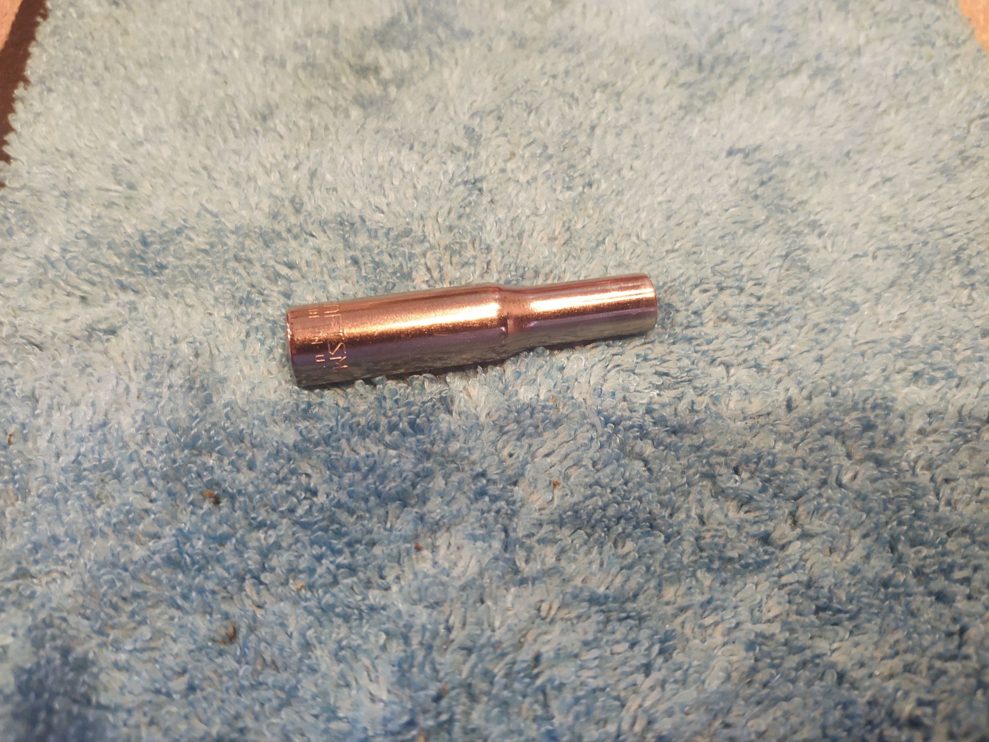

Fired right up, but currently have it hanging by a zip tie off of another wiring harness. What tool or fix are you using to get to the screws attaching module to heat sink? I know that an actual tool exists, but I would hate to have to buy it.

You need a 1/4" Drive 7/32nd Long nose socket. Or something like it. Sandy

Thank you....
