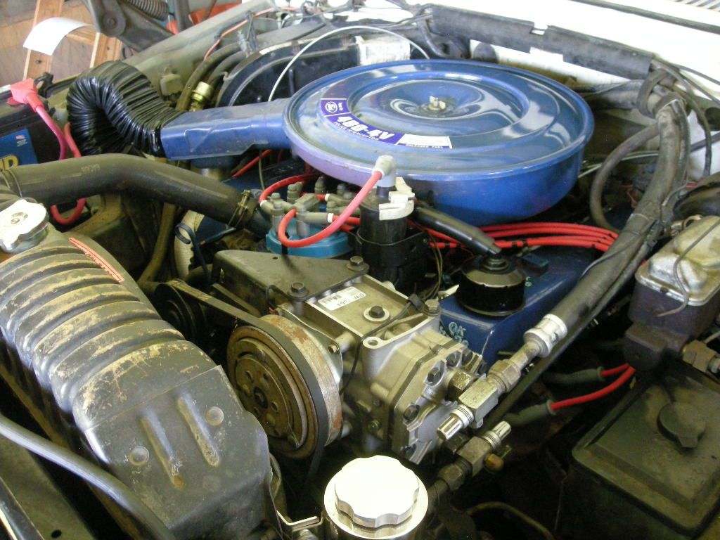

Years ago when I searched for an A/C compressor clutch for my '76 F-250, 460, I discovered that I could not find the correct one by using application. As far as "fit" and "belt alignment" goes, the one in the photo appears to be correct.
1976 F-250, 460
But, in order to get the correct clutch via application I had to use another vehicle. (I believe it was an older model Lincoln; 1970??????)

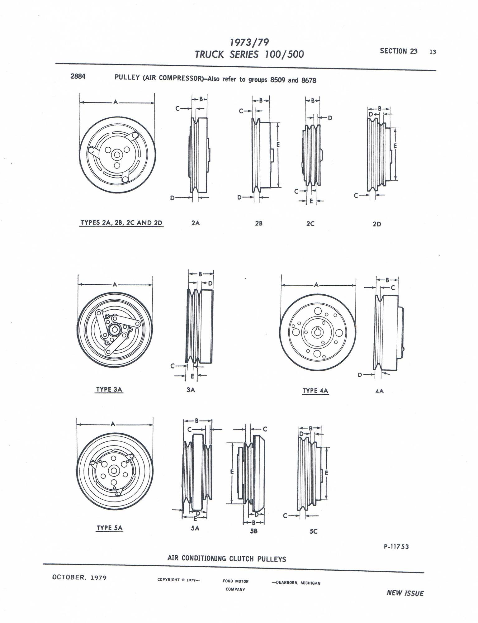

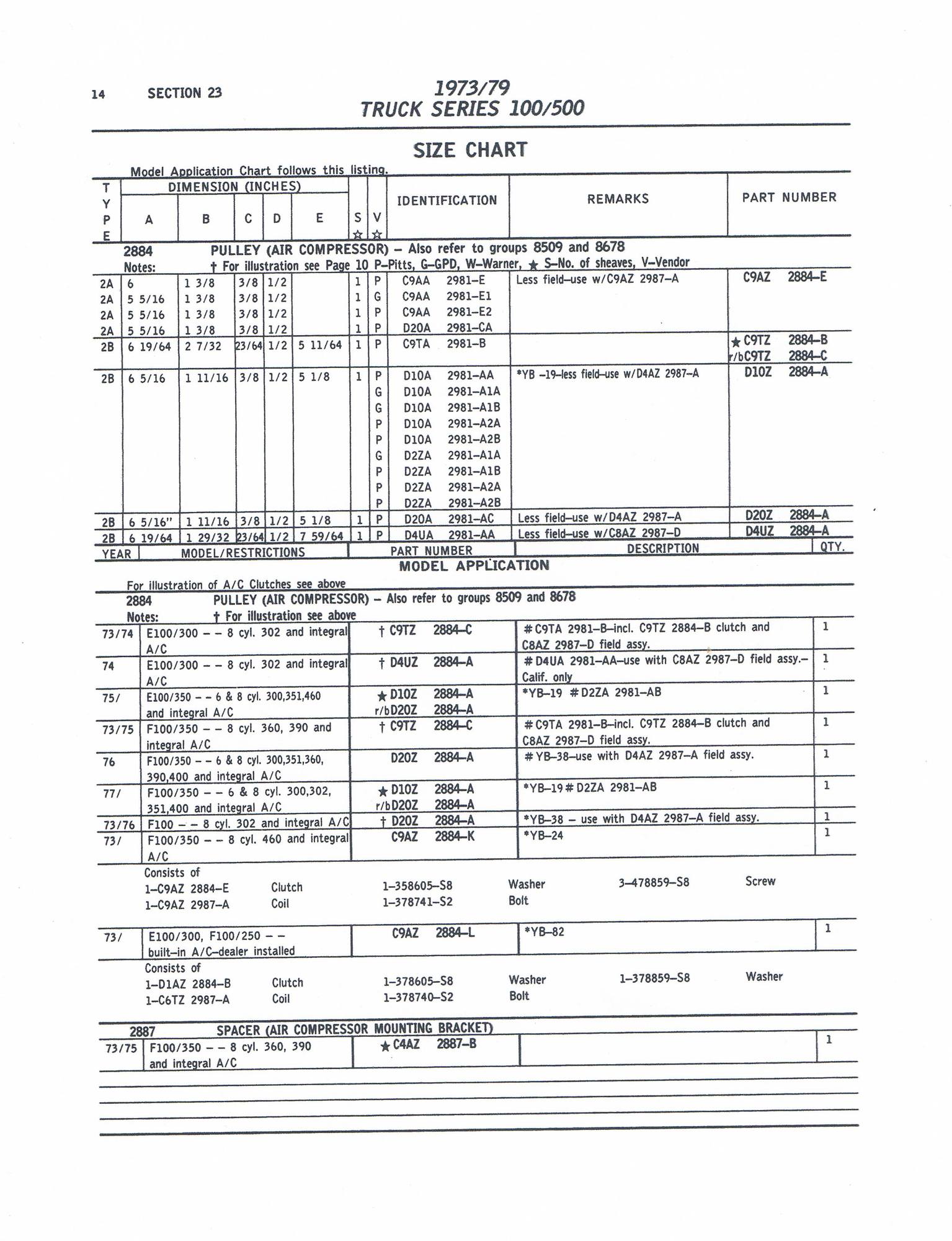

There are a bunch of different cluthes;
Old Jan 7, 2022 | 09:20 PM
Greaser007's Avatar
Greaser007
Joined: May 2021
Posts: 1,155
Likes: 358
From: Anderson, California
@DB429SCJ
Thank you for the pulley chart.
I had a York comp lock up. A few years later the free-wheeling pulley bearing locked up, tossing the belt.
I replaced the bearing, and am still using idler-only and not operating the a/c compressor yet.
Also, for those searching for a comp pulley the fullsize auto's and Econoline's used similar pieces depending on application.
